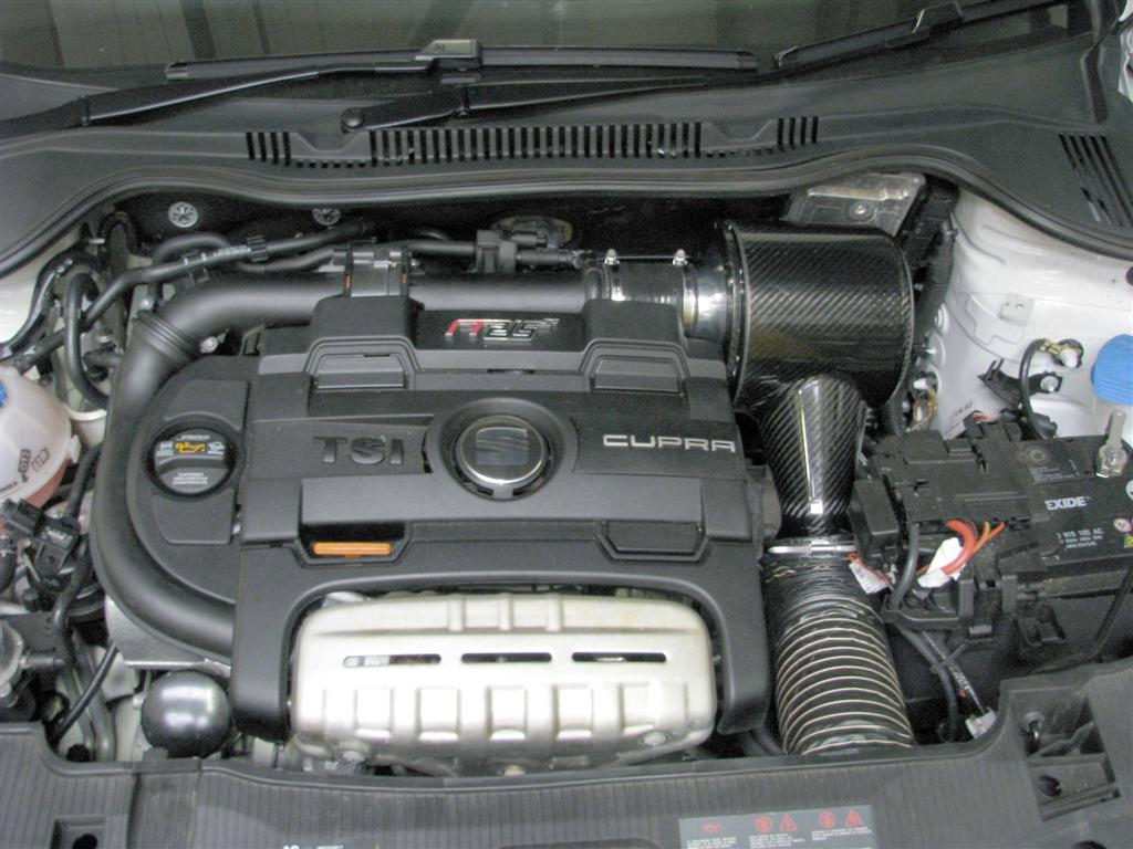

This seems to be ITG maxogen intake for the 1.4TSI

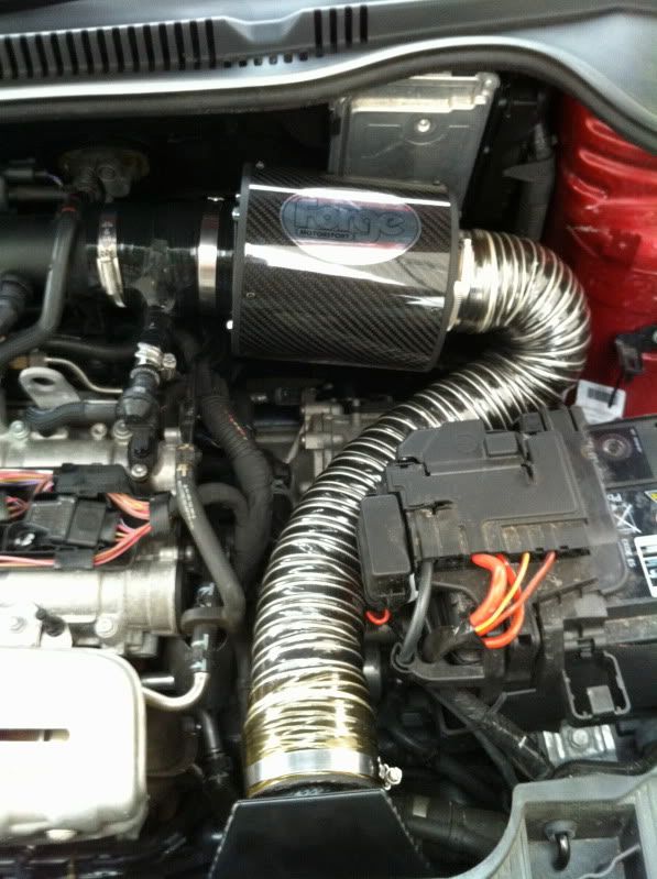

This is the forge intake
cant find any dyno graphs for this one though
