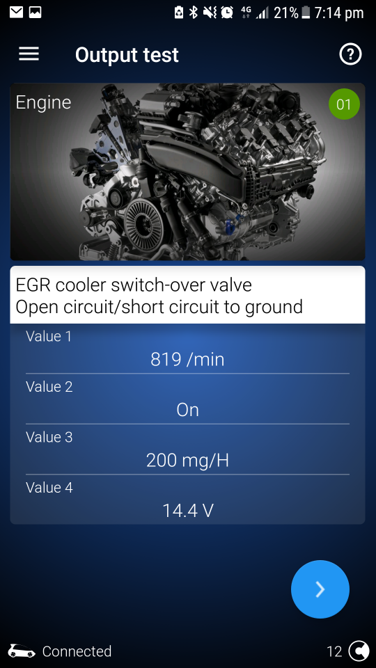

My question is, when doing output tests with the OBDeleven, should the engine stop? when it did the EGR cooler switch over valve the engine stopped. I've attached a screen shot of the test which stopped the engine.
I don't think it's the tandem pump as its intermittent and starts fine when it does. The tank pump works fine. I'm sure its electrical, perhaps something shorting out the ECM, could that stop the engine? Would a crankshaft position sensor show a fault on the reader?
I am afraid I cant help with this as mine is petrol, have a search on google for VCDS EGR cooler etc and see if there are any instructions for you to follow. Or maybe OBD Eleven
