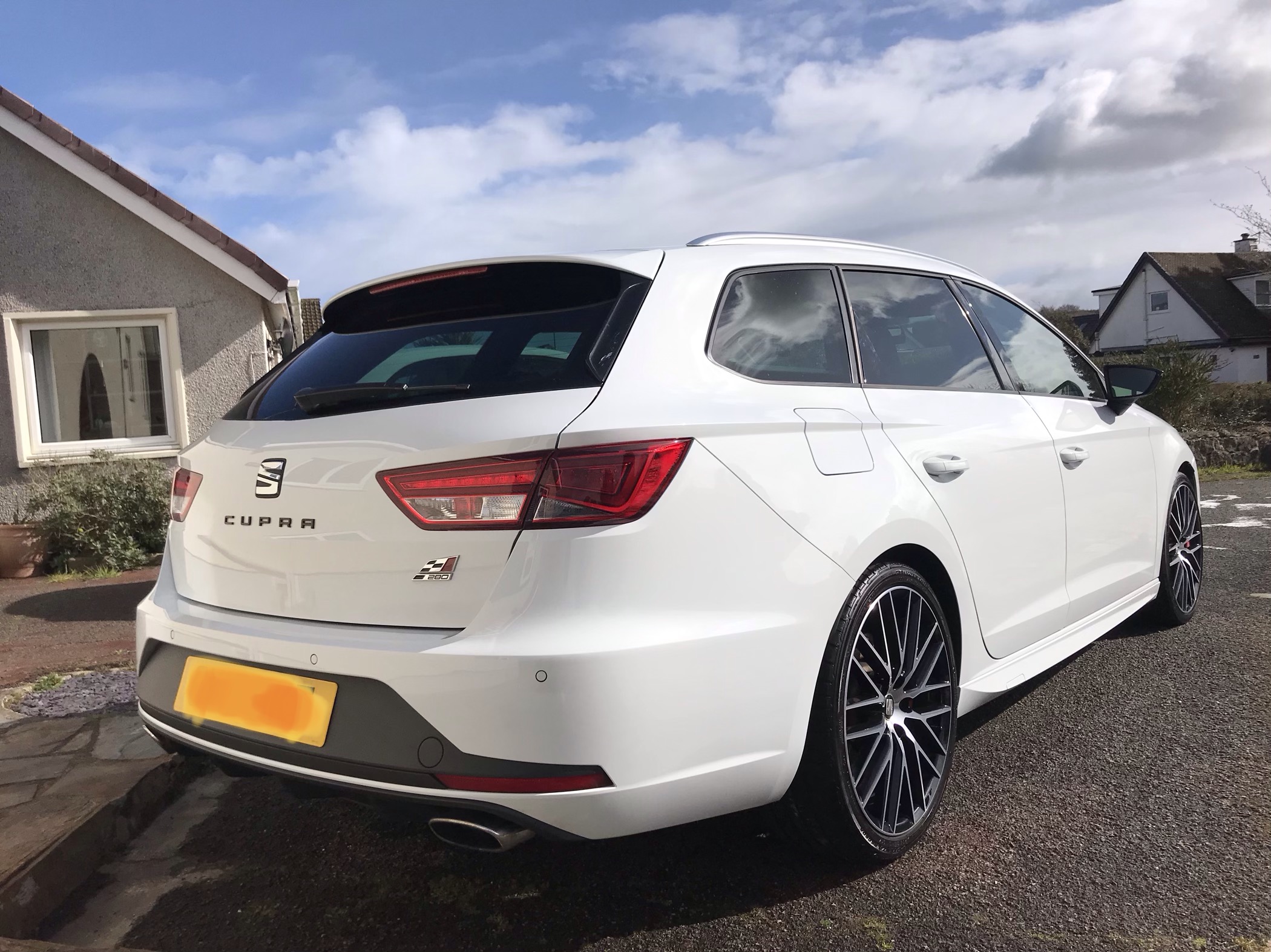

I've had a set of KW ddc coilovers fitted. Initial impressions are excellent with the wallowey feeling from comfort mode when pushing now gone and less body roll. cupra mode is less harsh but more compliant. I went with 25mm drop and will see how it settles over coming days. It may be coincidence but I noticed less wheelspin in the wet. Normally I'd expect some wheelspin @ wot in 3rd when climbing towards the redline but on way home I couldn't get the wheelspin. Maybe the rain is grippier in Irlam lol

The drop you've done of 25mm, is that like the highest setting on the KW's? Their site says they drop 35mm minimum, so I'm assuming that is not the Cupra which has 10mm lower suspension anyway.
When I discussed what I wanted before fitting I was advised not to run KW dcc's at their highest setting as people have reported knocking issues with this configuration. It was there recommendation to opt for a 25mm drop based on previous installs. I didnt query the maths behind the 25mm, i just asked to be consulted by the tech before he finished the install and went onto the alignment so I could check the drop and make final adjustments. I never made further tweaks as was happy with the stance. I presume its 35mm plus 25mm.
Im going back at the weekend for dsg and diff service so can query the maths behind the 25mm drop then if you want.
