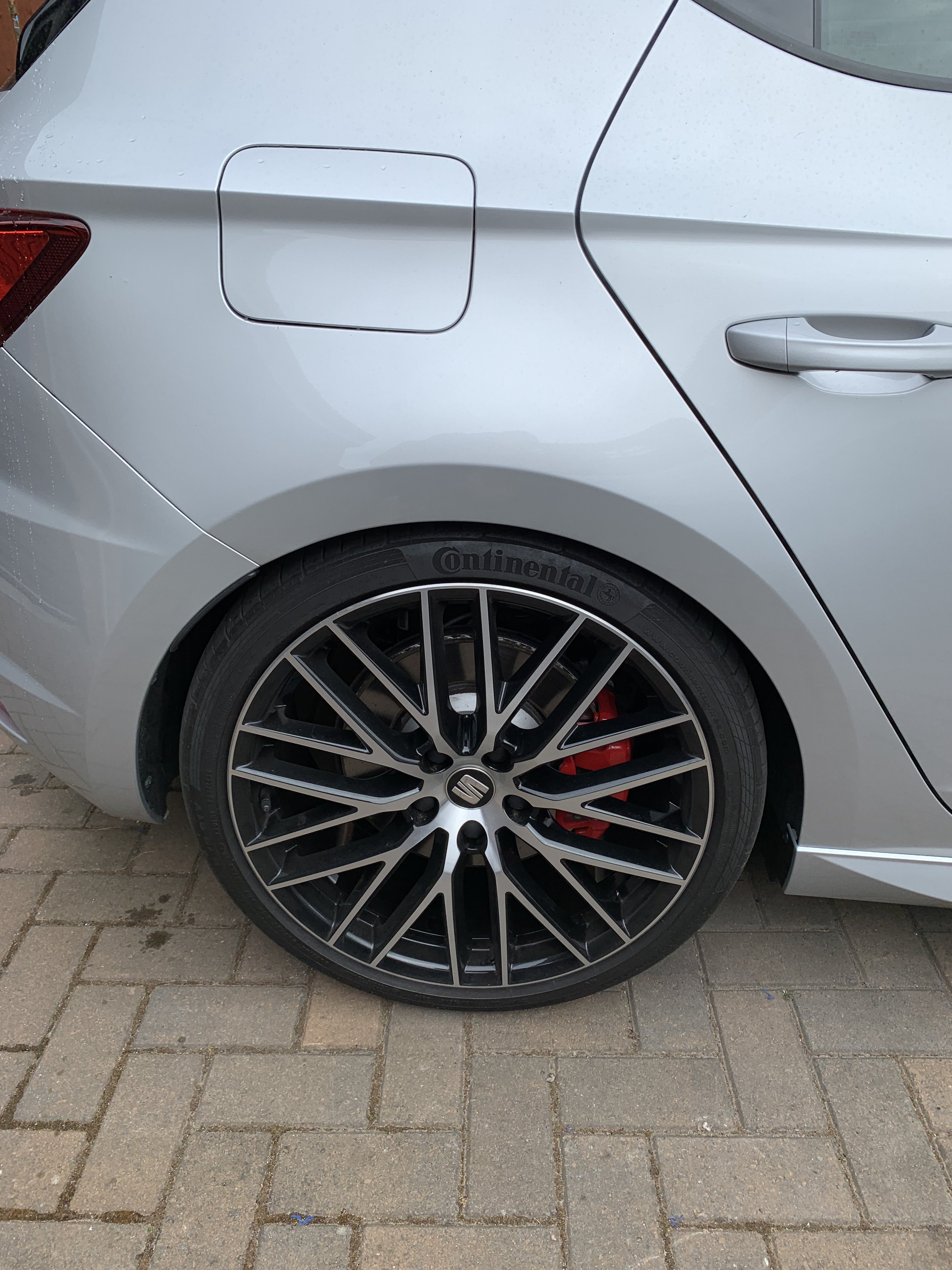

New refurbished wheels and new tyres fitted
