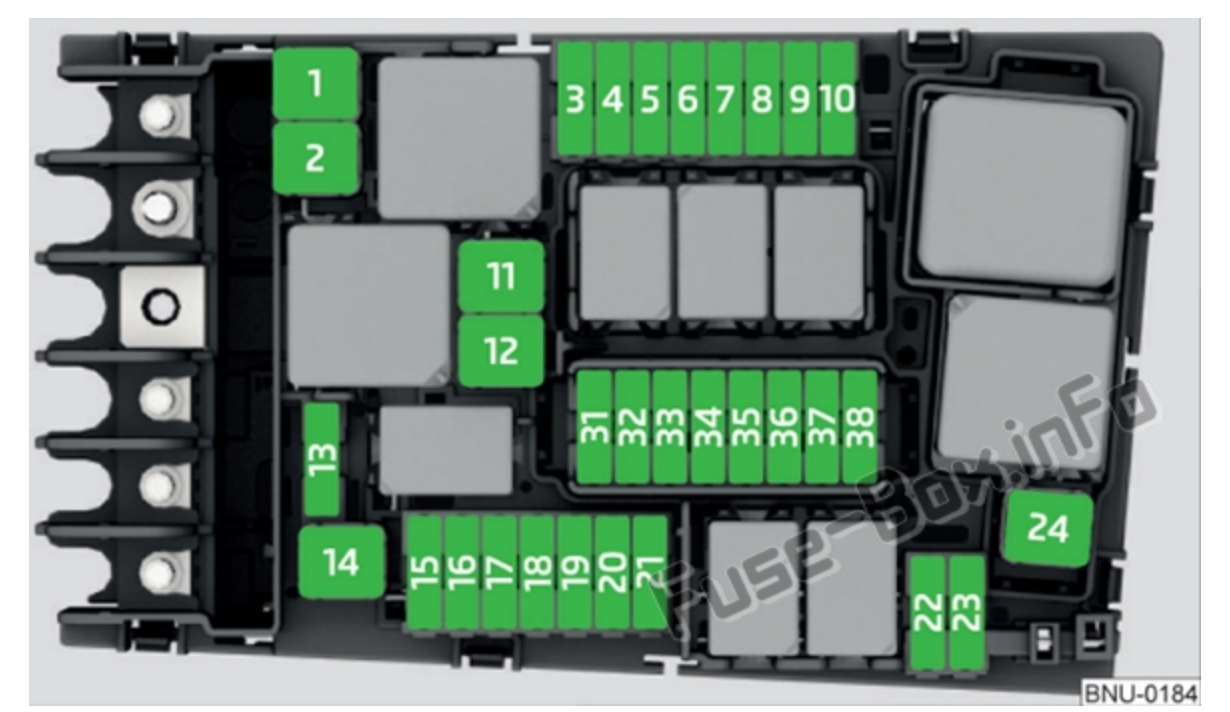

Tried to figure out why my washer bottle pump wasn’t working. Did a diagnostic with OBDEleven and it informed me of an electrical fault with the washer pump. Checked the fuse (No19 in the Engine bay, and swapped it for a new one) and it appears the fuse is ok.
Looks like it’s a faulty washer pump so off to my local dealer to get it looked at under warranty.

bgb
Jan 22, 2019
598
317
Not being mechanically minded I don’t actually know where the pump is and even if I can get to it without removing other items.
Just ring my local dealer and the Service Manager tells me the fuse for the system is in the Glovebox Fuse Box but I’m having trouble finding out which one it is.
according to online, it’s fuse 19 in the engine bay as you’ve said. So the service department seems to be wrong?

Yeah I agree with you all. Checked that fuse and it’s ok. Replaced it with another 30A fuse and tried again with no improvement. I can only assume it’s a fault with the washer pump.

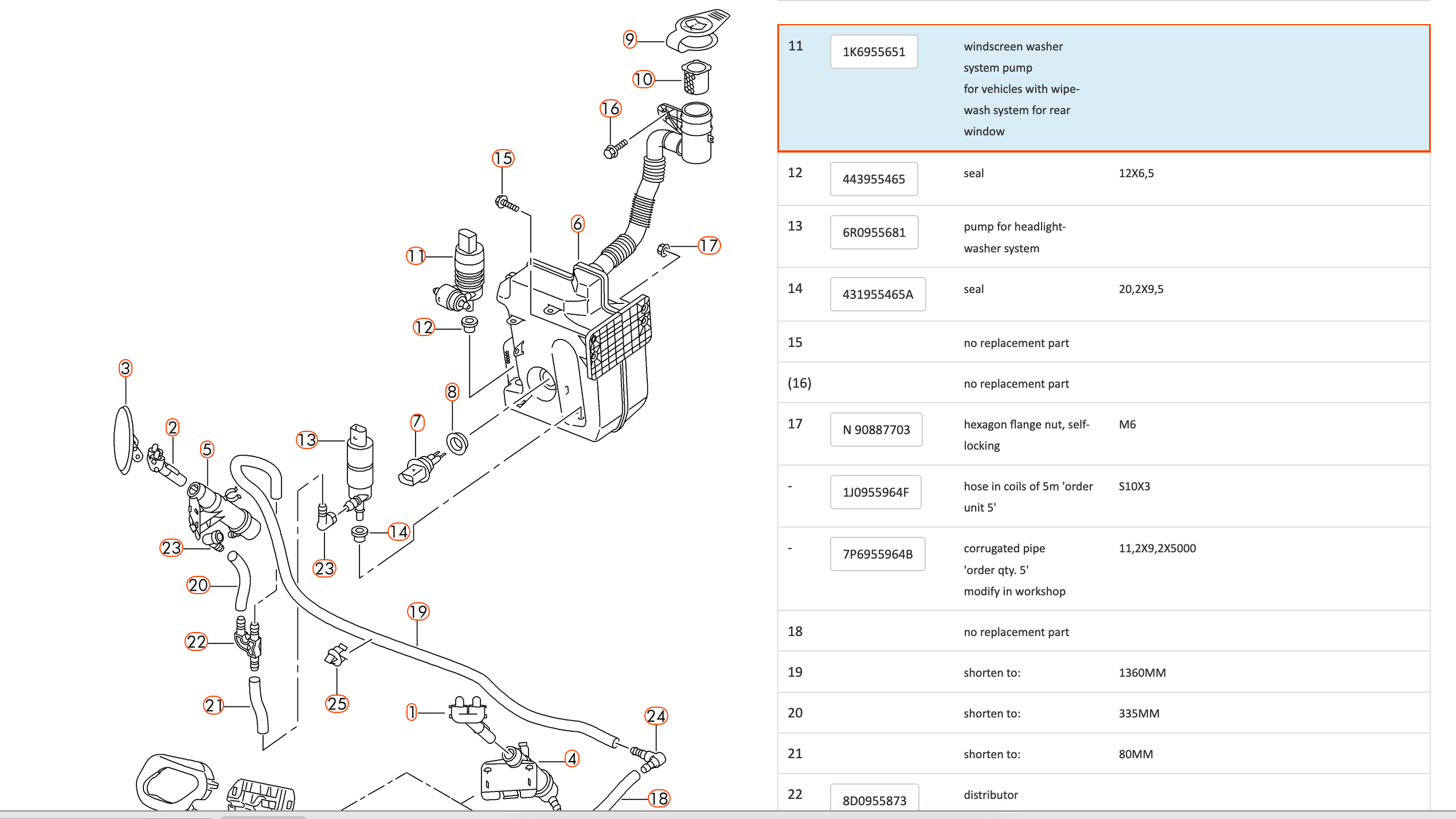

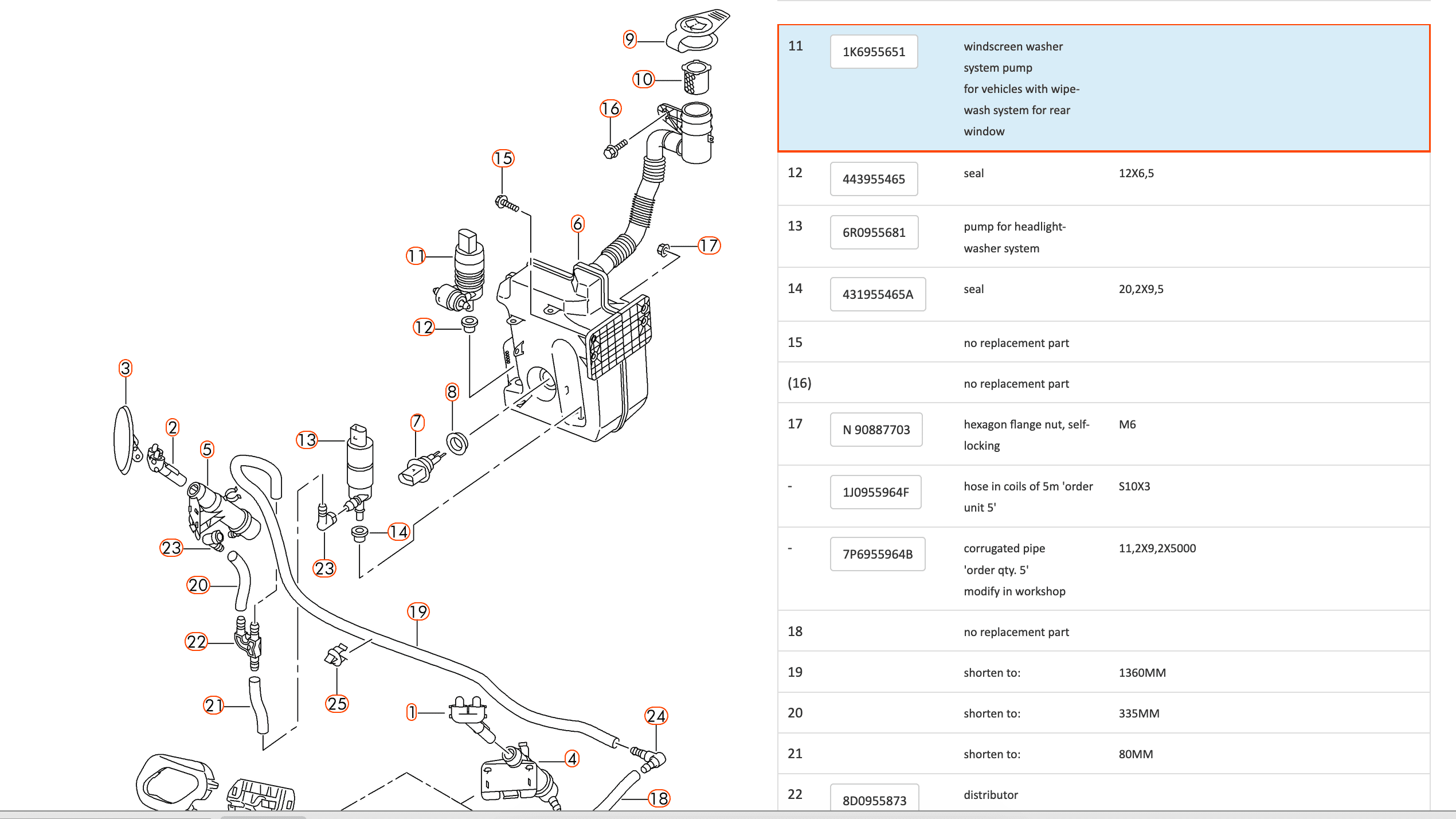

And here is the pic of the setup down below, so there are two pumps, Windscreen(11) etc and the other (13) Headlight.
My setup is different from that picture. I don’t have the pipe that runs into the reservoir. The reservoir has the top up point fitted straight on top of it.
I also don’t believe I have the warning sensor fitted either.
Deleted member 103408
Sorry that was from my setup. But I guess the setup is the same in as much as you have two pumps fitted to the bottom part if you have light washers, if not then its a single pump only.
