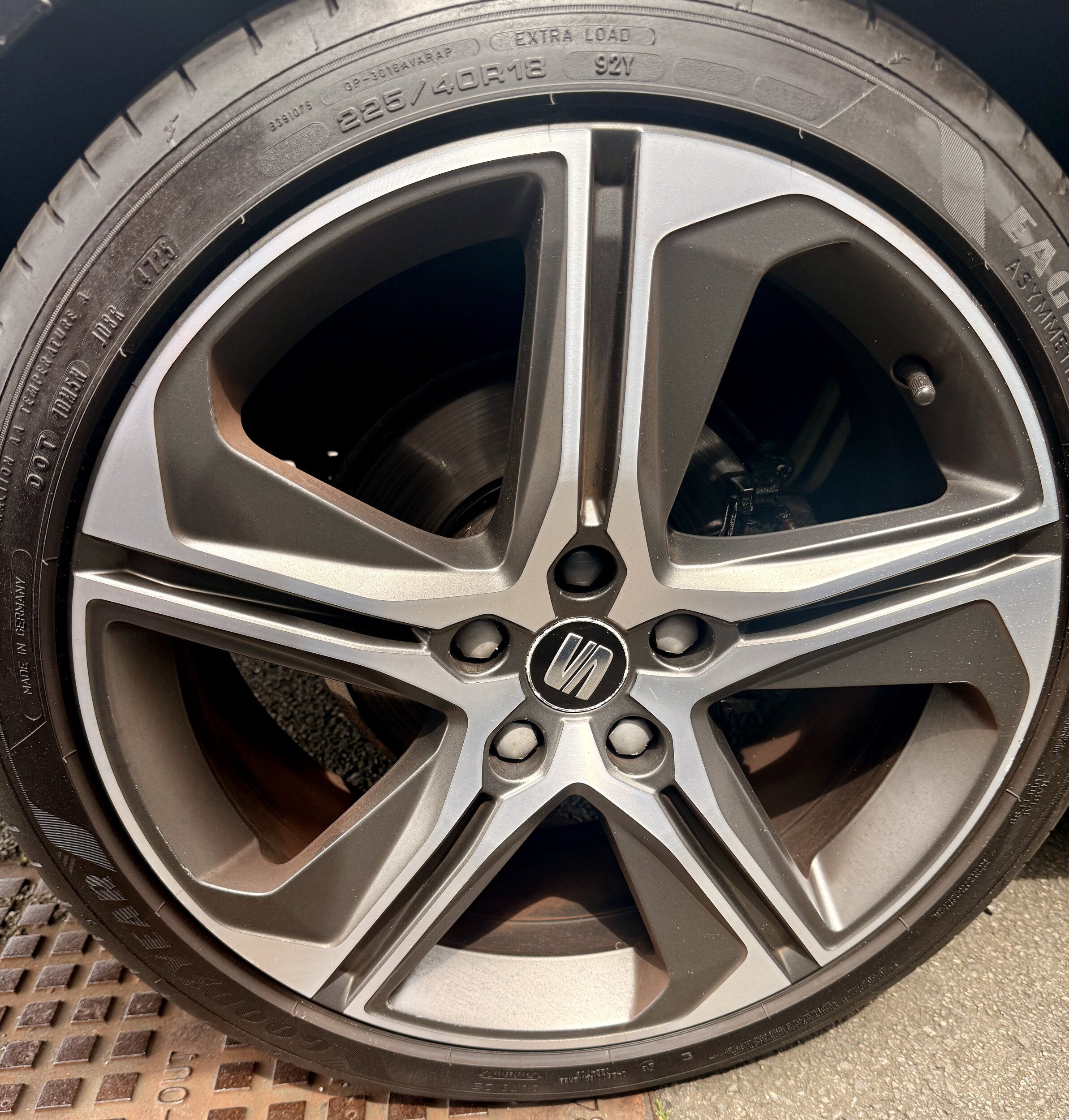

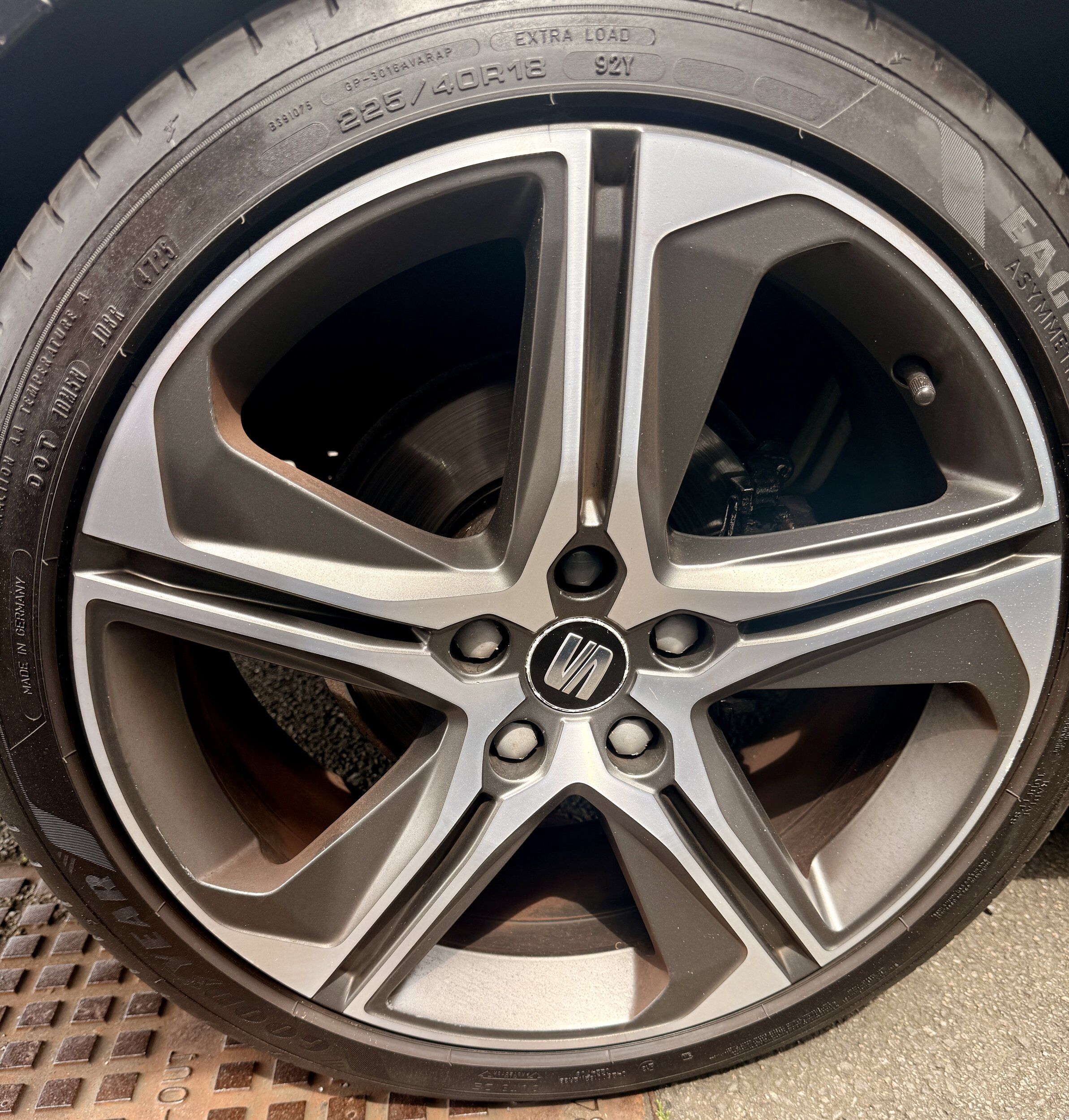

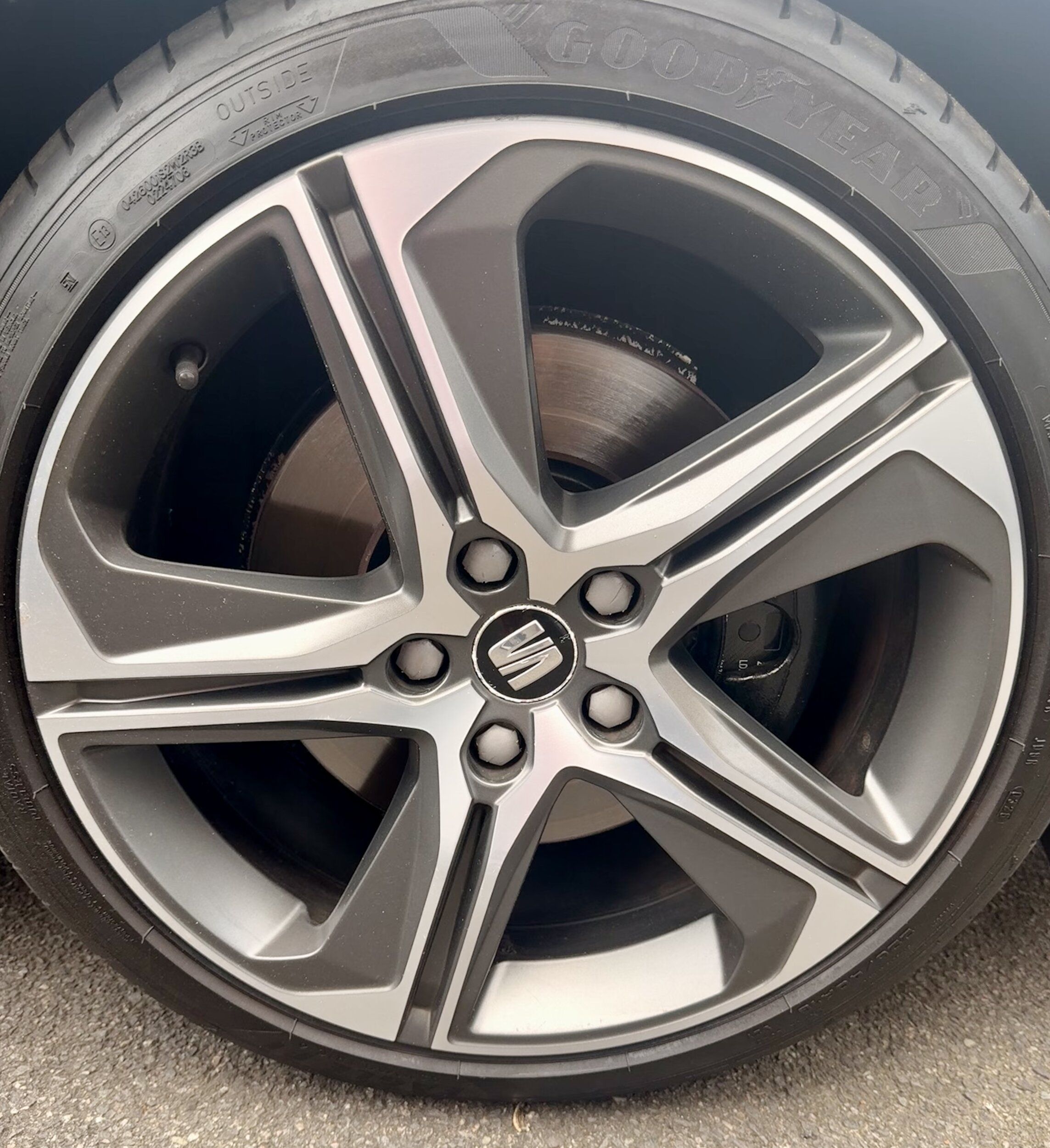

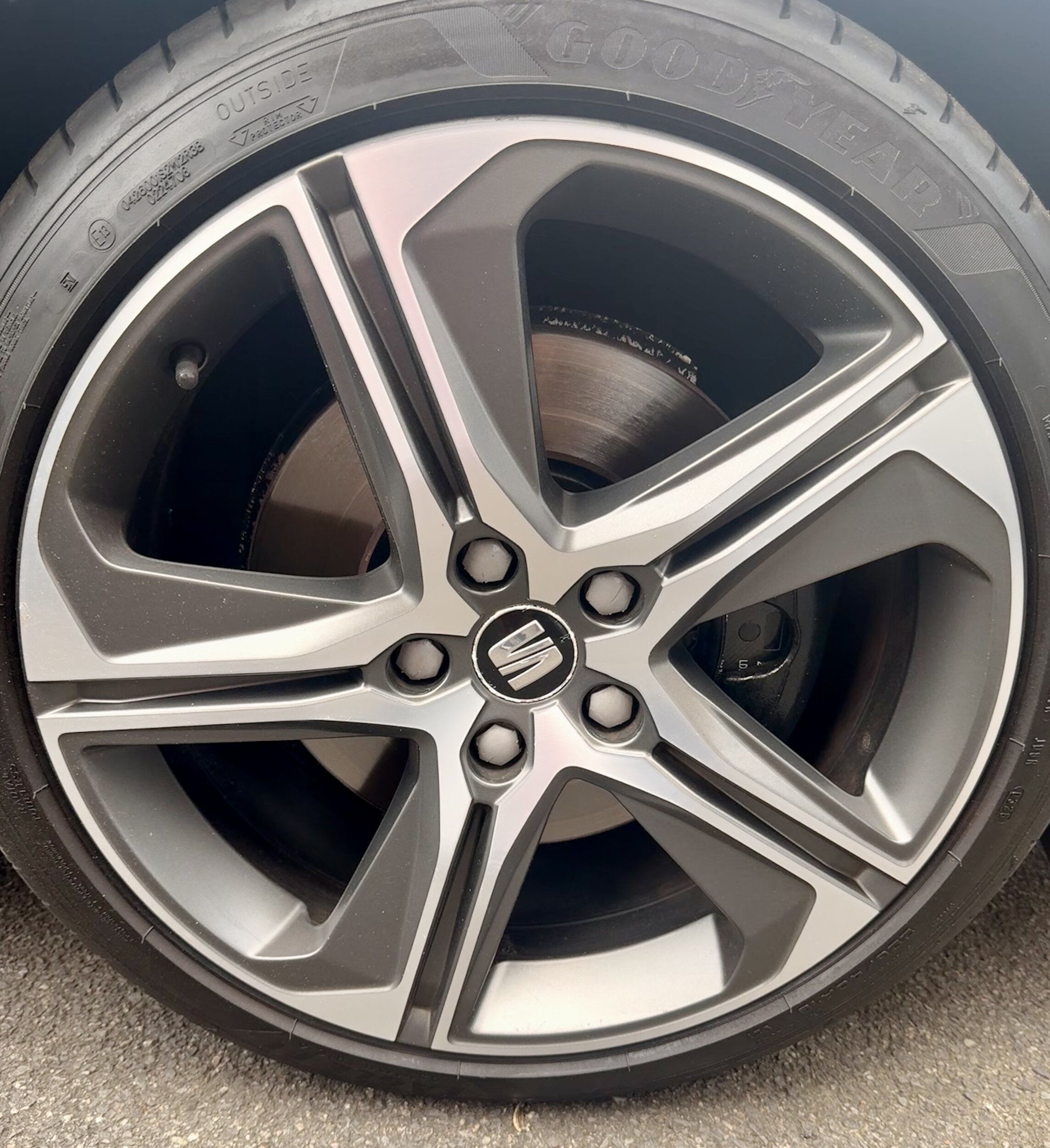

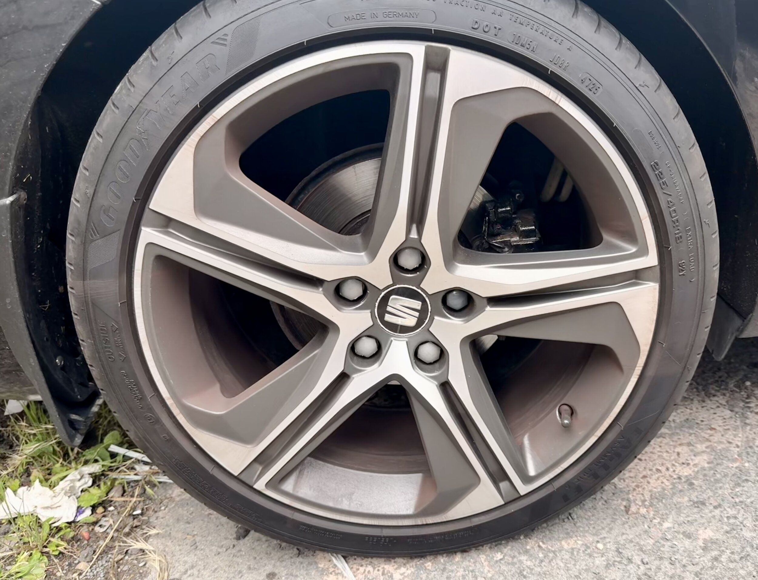

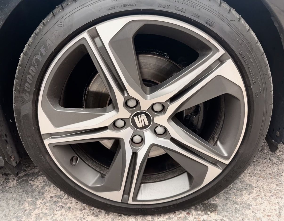

Not today but changed front pads to ATE ceramics, after bedding in the bite is near identical to the Pagids I had on that still had loads of pad left.
After 500 miles the brake dust is so much less.
Heres the rears vs fronts, bear in mind before my fronts used to cake up much more than the rears.
Also the rims have a lot of rain staining from the recent bad weather.

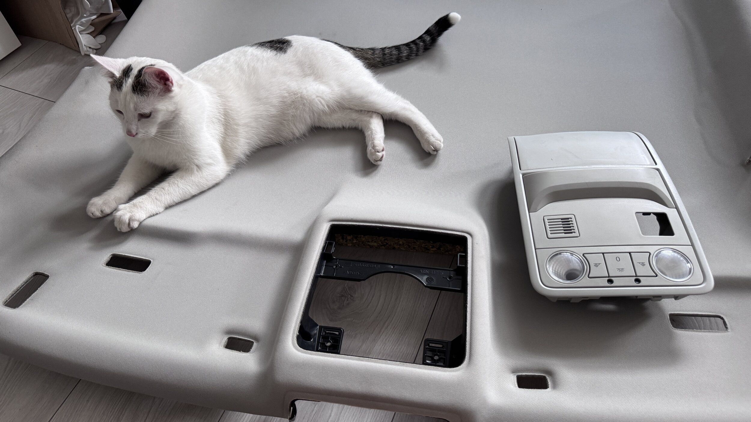

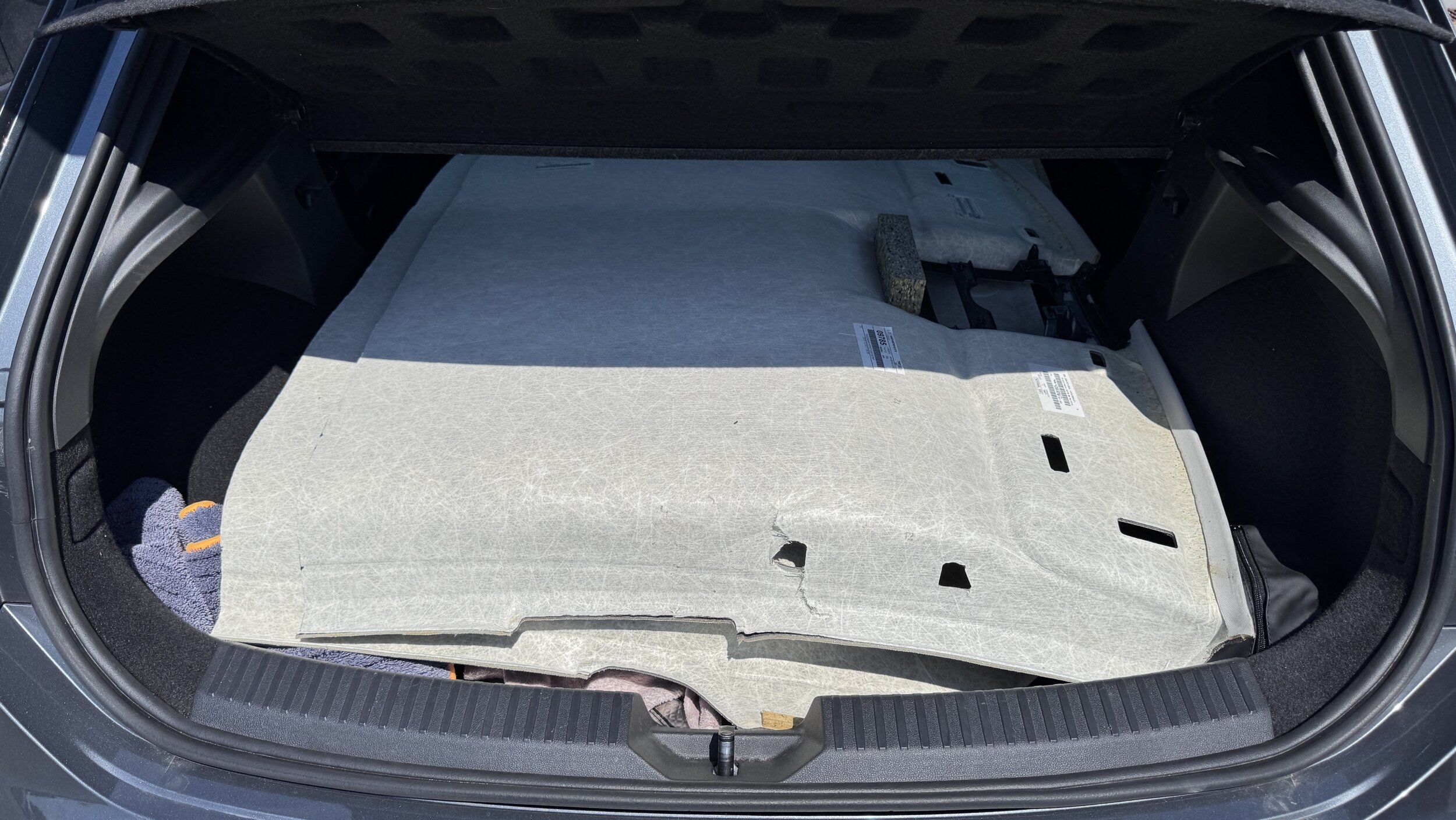

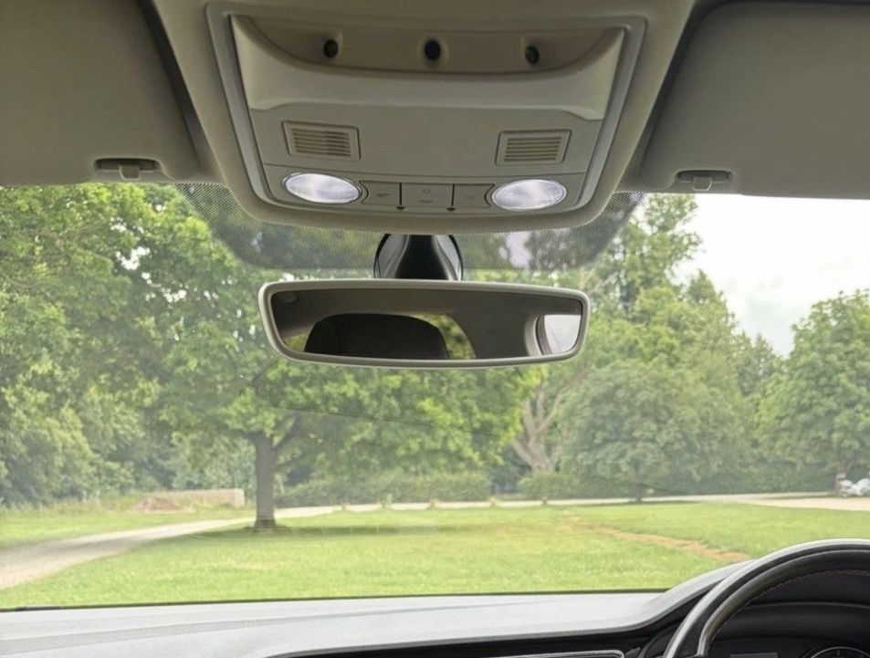

Yesterday I did small test. Some time ago I've replaced all button illumination to white and in the process I've bought central light from Ateca. As a bonus this light came with sunglasses storage, but in that time I've thrown it into box without any plans for it.
Recently I've been thinking - what if that storage will fit in Leon? There is a plenty of room between headliner and roof, only filled with some kind of squishy block. I've decided to test it but didn't want to ruin my headliner in case that something goes wrong, so I've bought damaged headliner for few bucks. Fun fact - headliner in Leon fits only in one place (you guessed it - it's on the roof!) so I had to cut it in half for transport haha

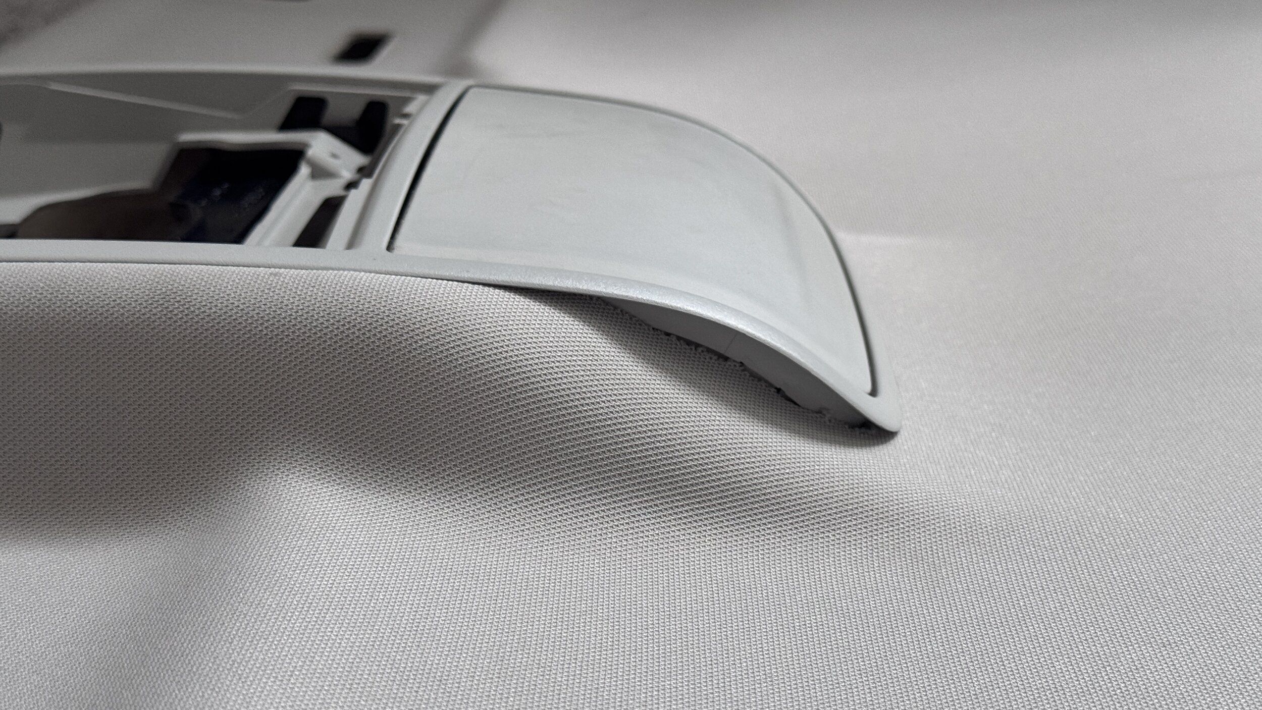

After some trimming the new central light with storage fitted the bigger hole, but the profile of headliner is quite off. Maybe some specialist could adjust the profile - I don't know. There are options from other cars so will definitely try them and let you know!
