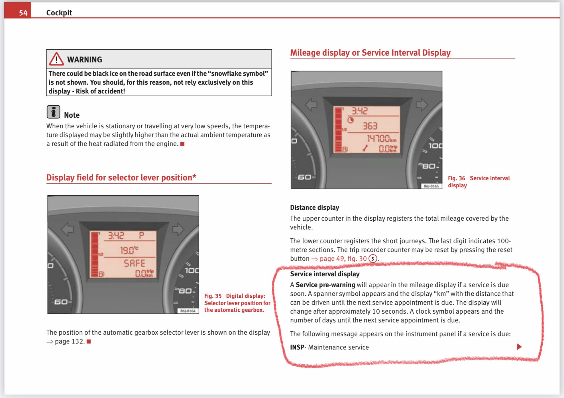

It’s meant to be a clock symbol and is part of the reminder of the next service being due. The spanner symbol (bottom centre of the display) is another part of the reminder, along with the number 20 in your picture which is the countdown of the number of days until the next service is due (that figure should reduce by 1 each day, counting down to zero - the day on which the service is due).
Screen shot of page 54 from the owner’s manual below explaining it;
Thank yo for this, weirdly I had just serviced it that day, but now has reminded me I forgot to reset the service light. Thanks again pal
