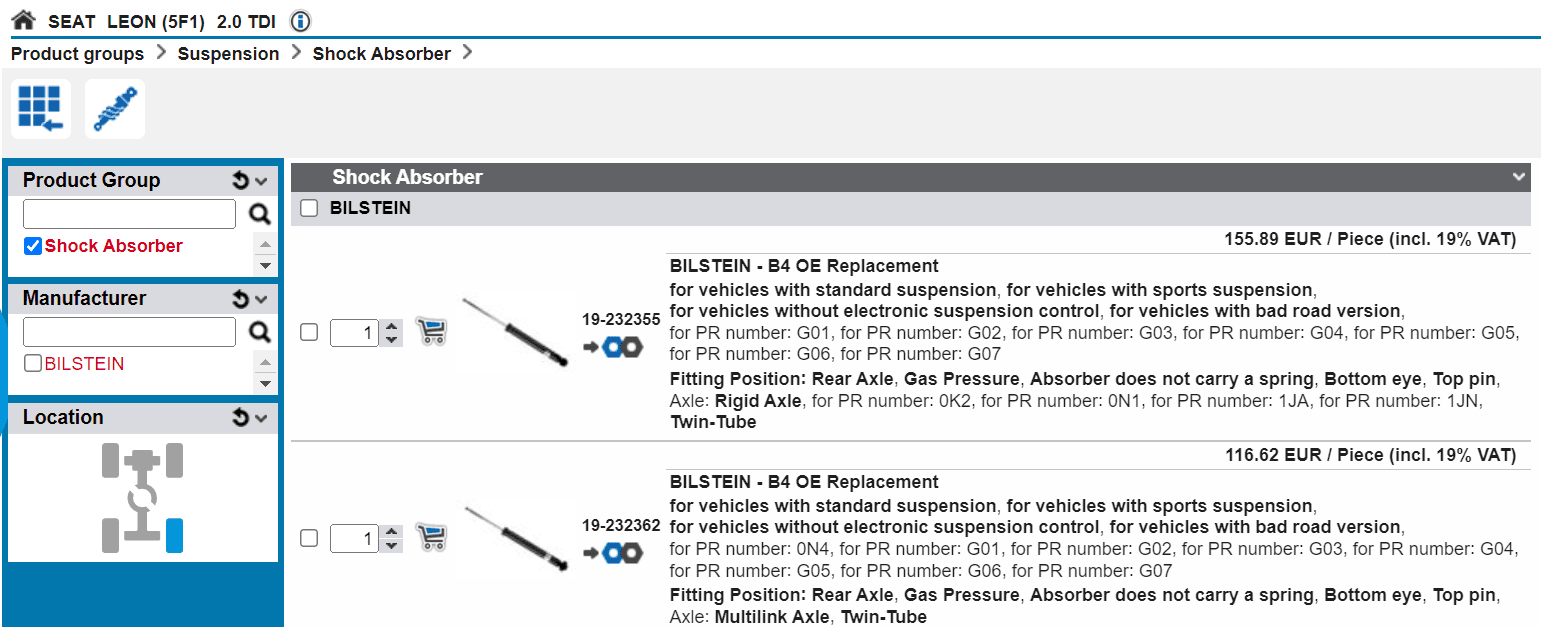

There are some B4 dampers linked to the 5 door hatch 184.
The 19.232362 are the ones I have gone for - for my ST! - not yet received or fitted though! Found them for £50 each - delivered. If they would have been nearer 70-80 I would have just got the OEM's which I think are something around £90 each.

From here:
and their catalogue:
It does seem to list them for mine.
