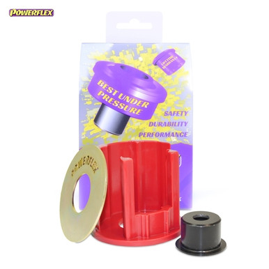

Same engine then, let me see if I can find the receipt email... I can't :(. Anyhow, this is the part. You just need to have a look at the bush in your car and see which of these you need. IIRC, mine was red if that helps:
Yer that’s the one I’ve looked at buying the red one that says for diesel cars but I’m confused there’s 2 red ones with slightly different product numbers so now I’ve no idea which one I need!

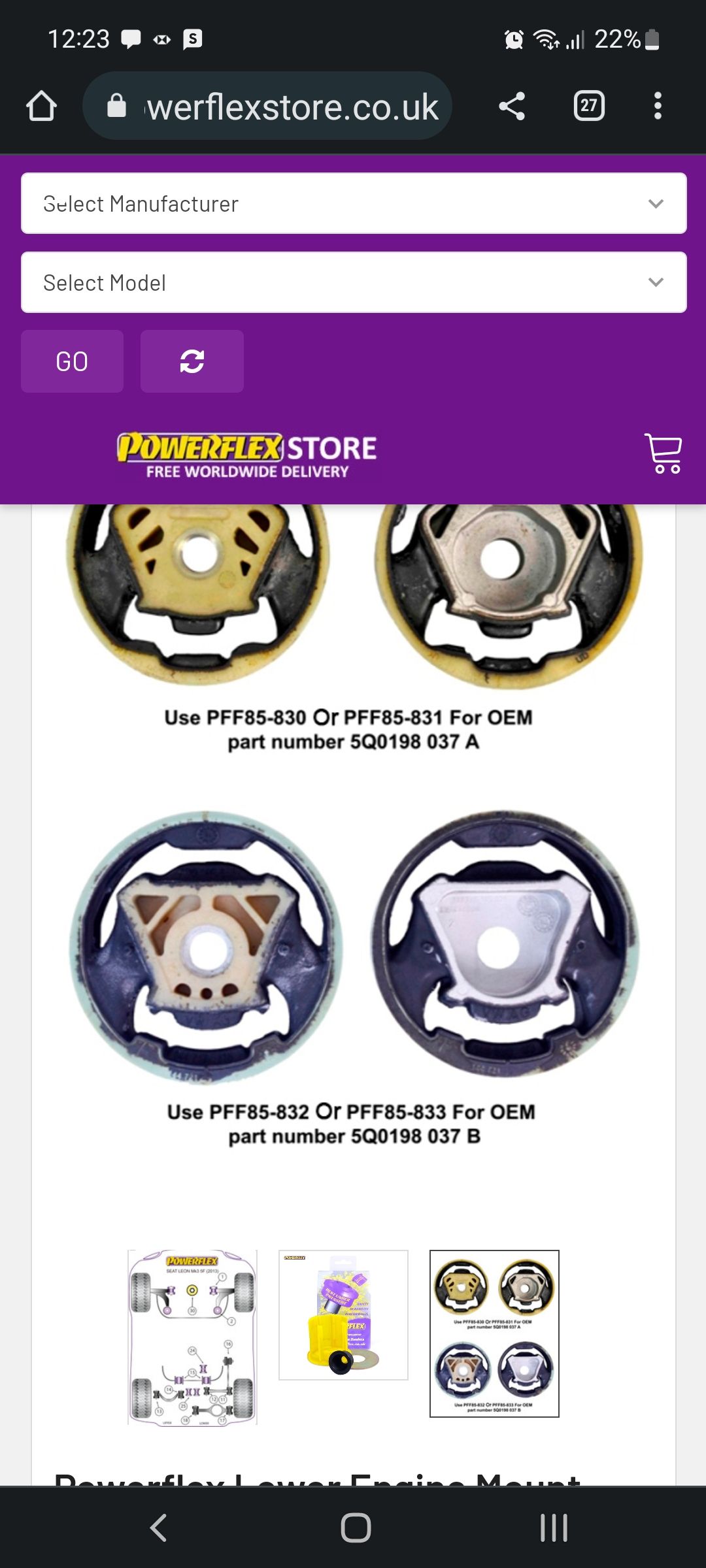

Get under the car turn your flash on and take a picture of your mount then compare the photographs on powerflex website. I have a 1.8tsi remapped and have had the powerflex bush in for around 20000 miles, it makes a massive difference to wheel hop and traction.

Heres the two different shaped mounts from underneath car.

I bought both fittings for my model, then got underneath and made sure which matched, then fitted it and sent the other back.
Reactions: Ayaan D
May 2, 2024
Cheers, had a look today and I will need version 1. Will probably go for the red one too as it’s being advertised as suitable for the diesel engine.
