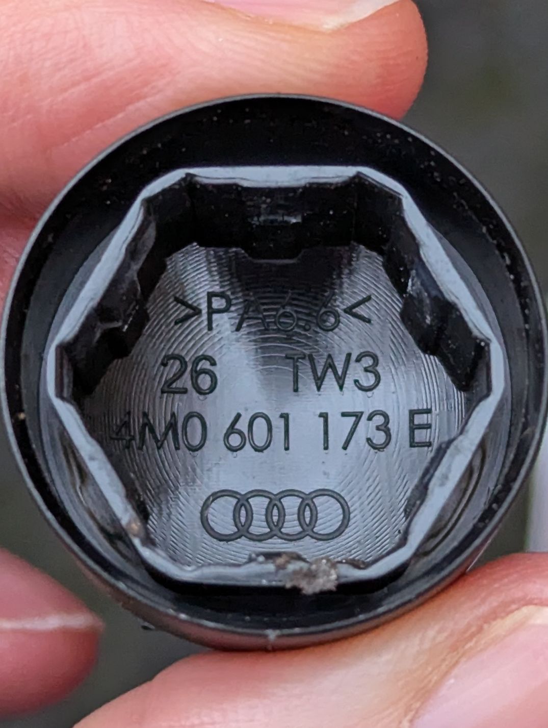

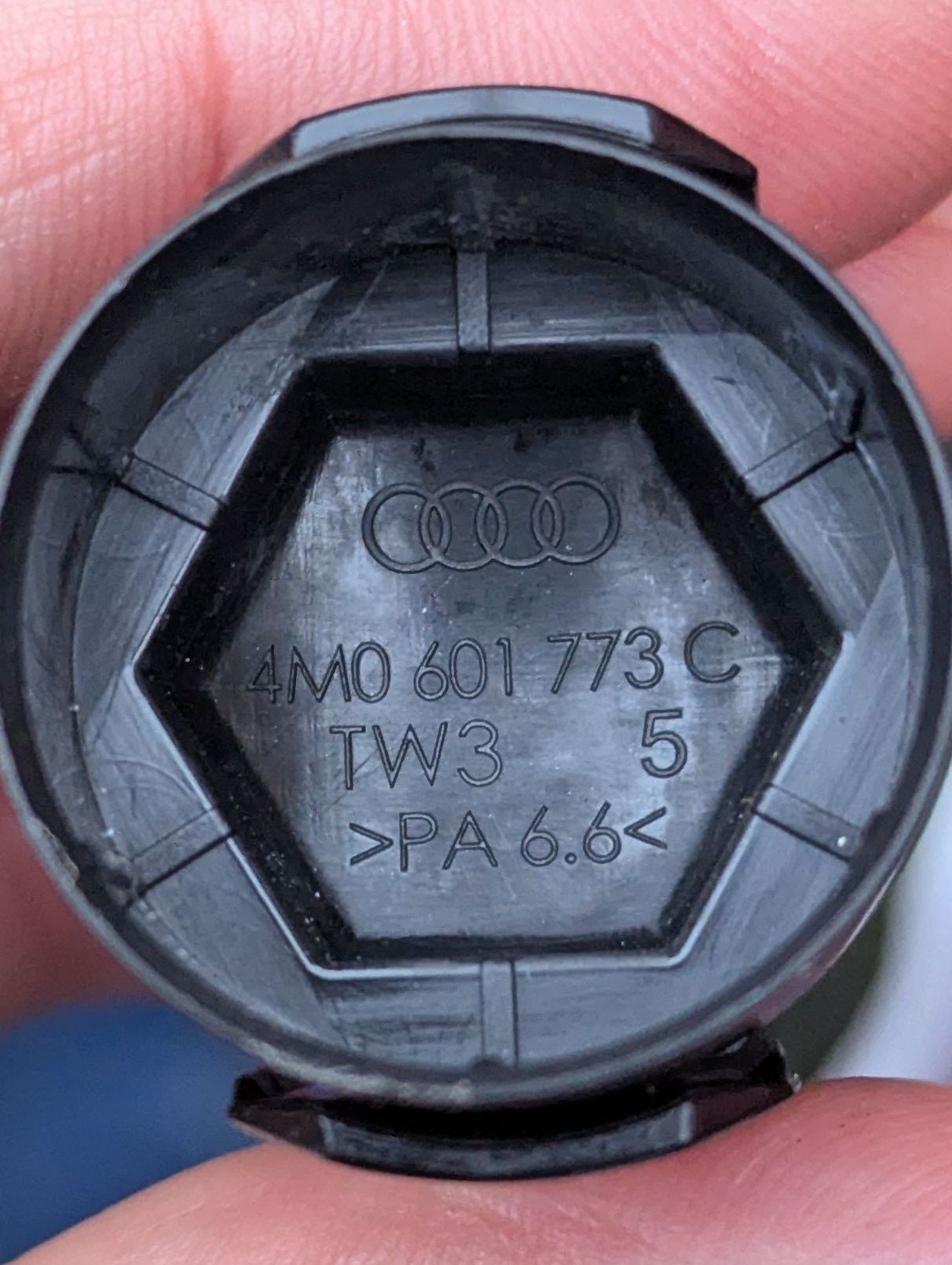

So the normal ones exactly match the part number you said, thank you. The locking looks to be 4MO 601 773 C TW3 which I've not found online yet.
I'll see if I can find the 773 part, but will probably use the numbers you posted.

I'm not sure what the TW3 is referring to, might just be the company/factory that makes them, so maybe just risk using the part numbers by themselves and leave out the TW3.
Edit:- remember that a part listed as for an Audi even A1 that has the correct part number is exactly the same item - as you can see on your caps, they both have the Audi roundels. Maybe best plan is to find out the correct price for both these types of caps from your nearest SEAT or Audi dealership parts department - just hand over the part number especially if phoning/visiting an Audi parts department, as they are prone to not sell you parts for their cars when you say that you are going to use them on a SEAT - I can understand that as they are only protecting themselves from selling you "Audi" parts for fitting to a SEAT.
