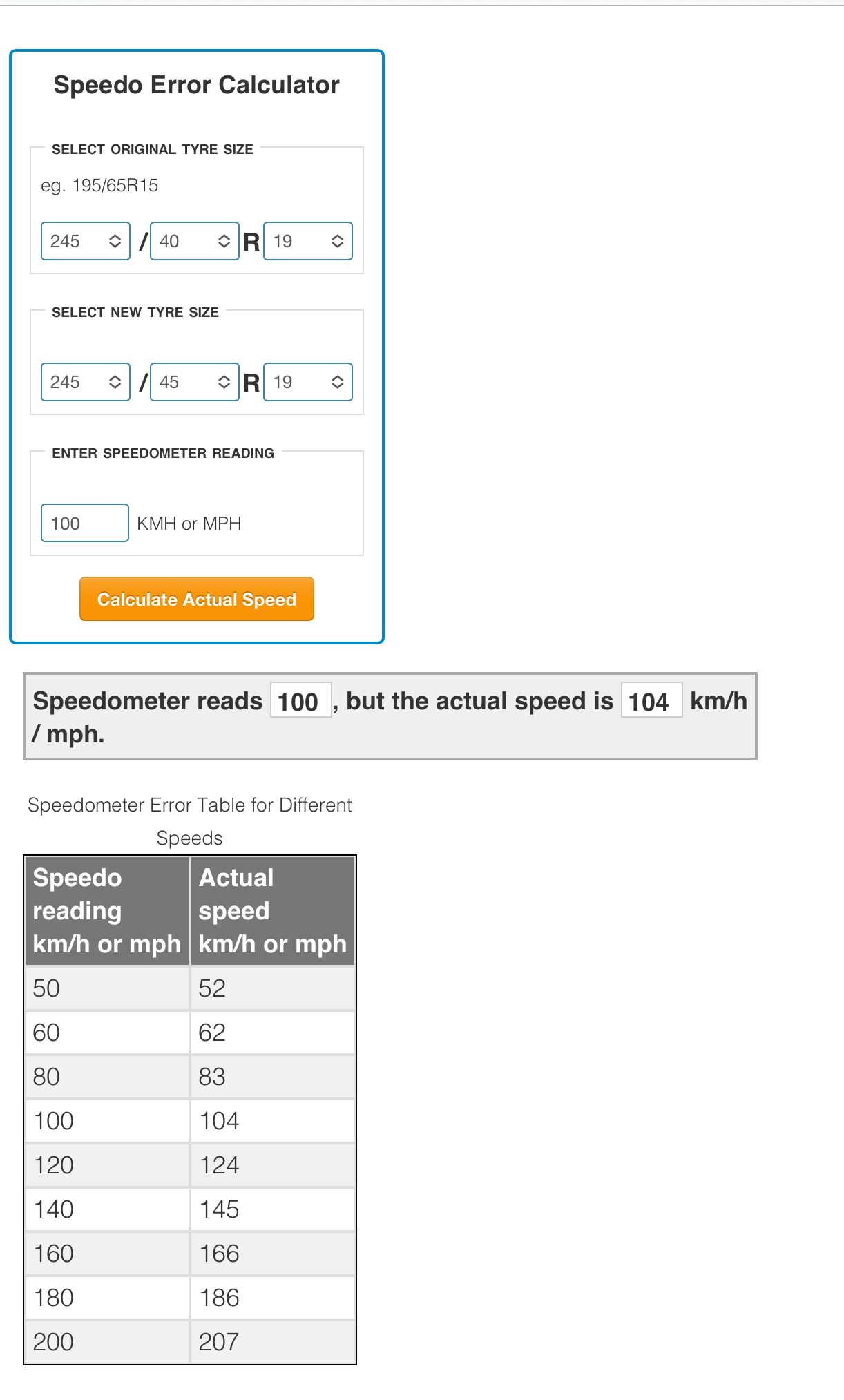

@Sartuzi; be aware that increasing the tyre sidewall height will result in a speedometer reading error. According to the tyre size change calculator at the link below, with 245/45 R19 tyres your speedo will under-read by around 4% compared to the factory fit 245/40 R19 tyres, so when your speedo is indicating 100 kph, your actual speed will be 104 kph. It would be worth checking in your country (Lithuania?) whether or not there are any legal implications of having a speedometer that over-reads or under-reads the true speed being travelled.

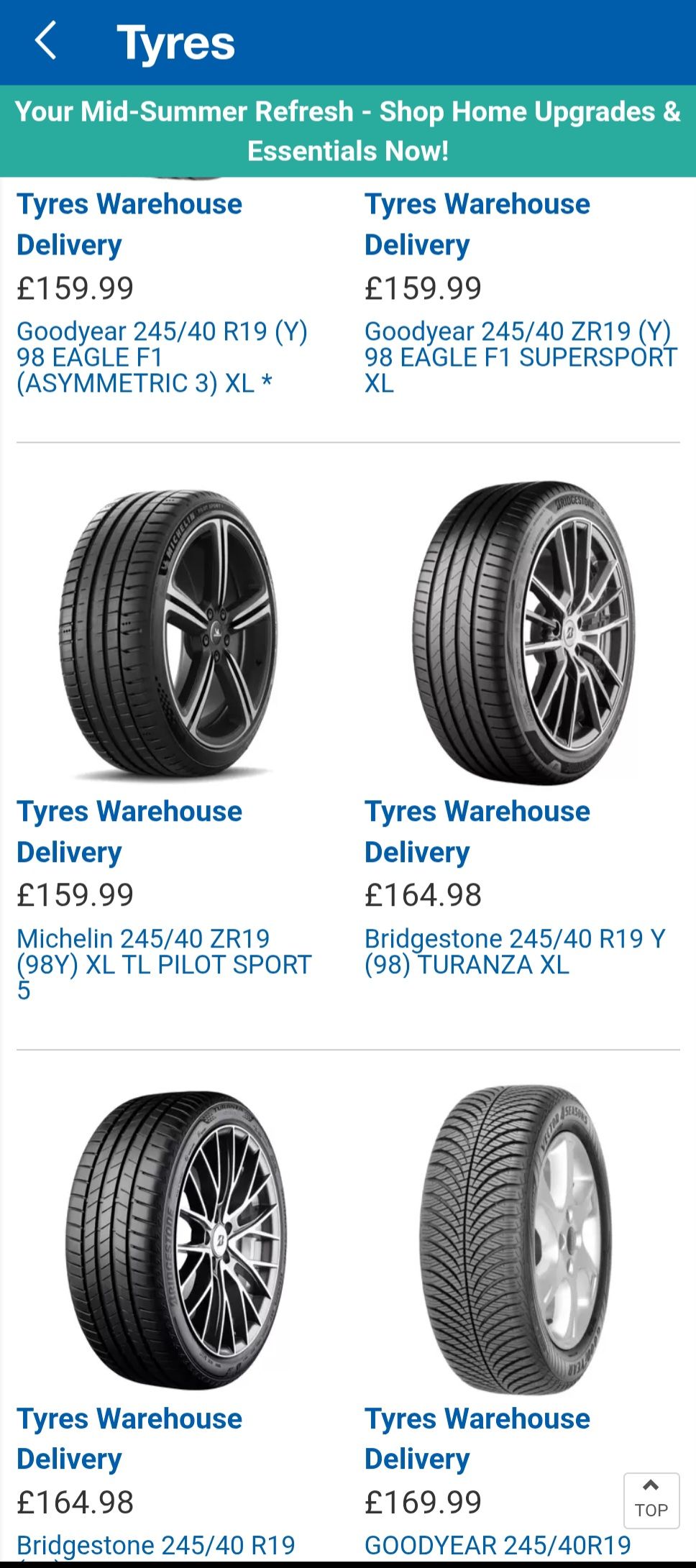

Have a look at Costco prices.
@Wyld Stallyn - if they don’t have to be Michelin PS4S there are other premium brand performance tyres from Michelin, Goodyear and Continental in 245/40 R19 size in the £150 - £200 per tyre price range (fitted) from the likes of Asda Tyres and Black Circles. Black Circles also currently have a money off promotion on certain tyres.
Reactions: Wyld Stallyn
