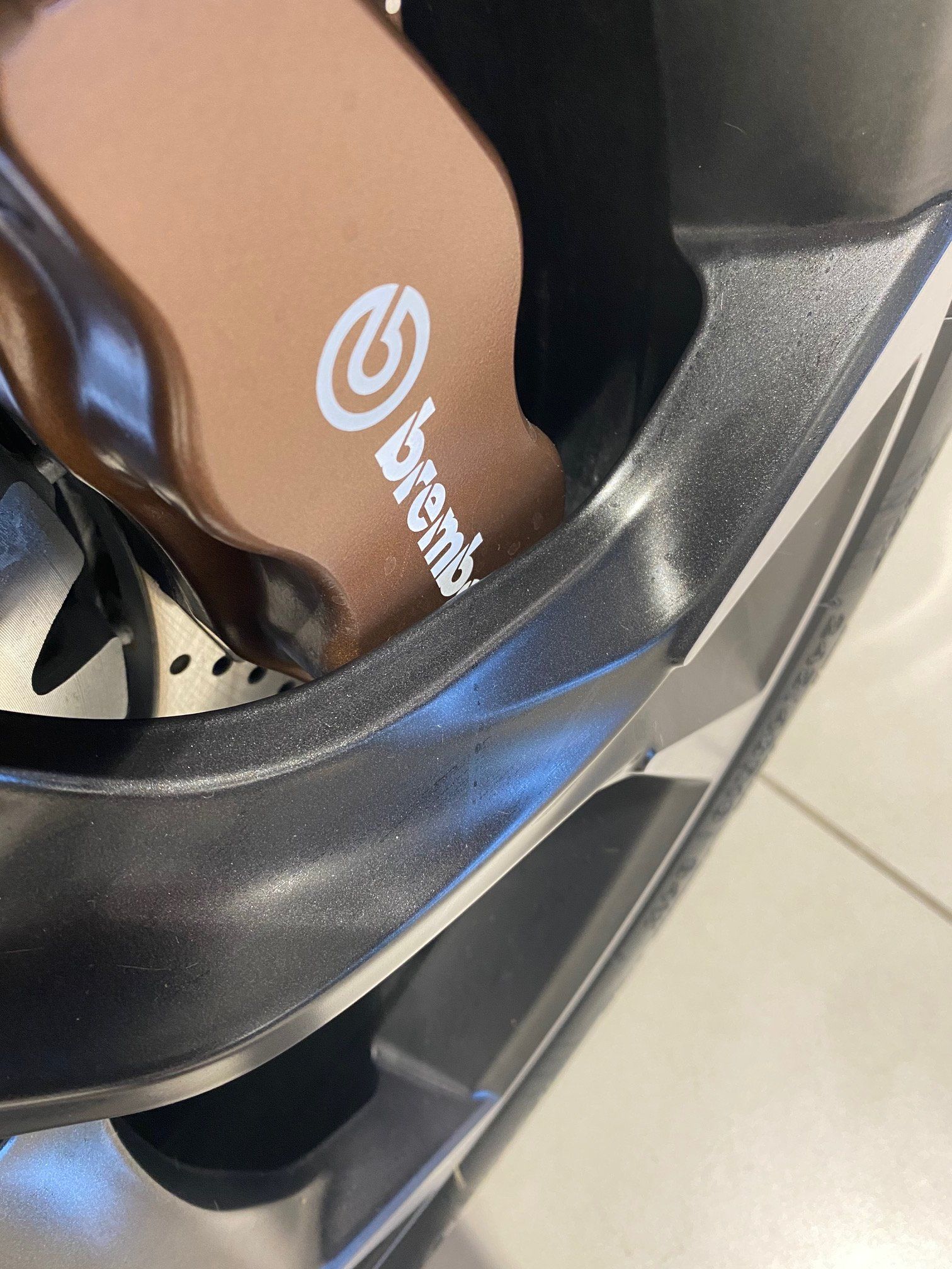

The wheel size suitable is 8x18 on ET40 or ET35 (the most common offsets). 40 will give you the same fit I have on my Formentor: Helluva tight (look on the image I'm posting). ET35 will give you more clearance with the calliper (in fact, 5mm more). I'm trying with this beauty on matt Bronze:
I know, I know... still have some fetish for wheels on such colours (missing badly my Subi B22). As said, at least on the Spanish ITV (same dog as your UK MOT) I can move into a plus/minus 3% on tire diameter hence the 225/50-18 size mentioned previously for a winter size.
Have an appointment just for a test fit a Revo RF018 on my Formentor this forthcoming week. Expecting to have some news soon.
