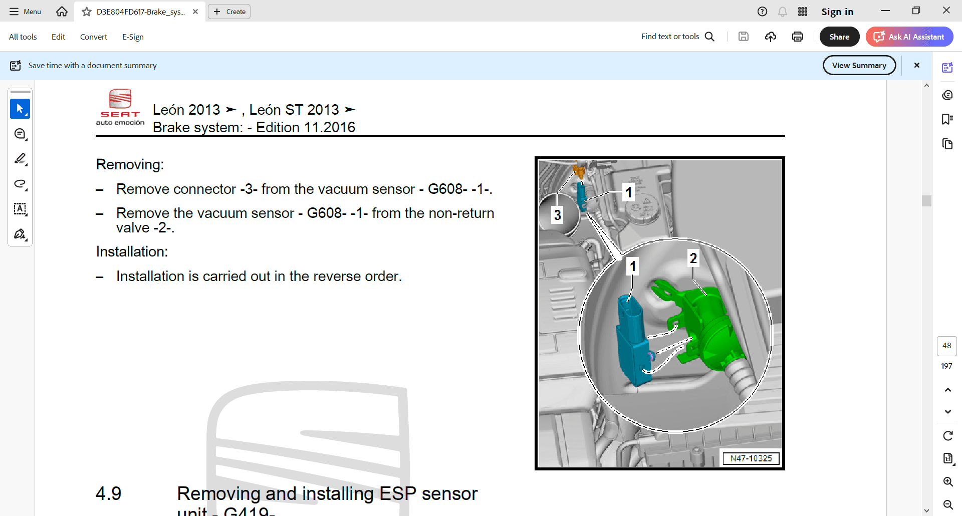

Mark300zx Active Member Apr 24, 2008 1,454 8 Surrey/SW London Jun 19, 2025 #1 I've had code c10a329 pop up and wondered where this sensor is located and is it an easy job?
Mark300zx Active Member Apr 24, 2008 1,454 8 Surrey/SW London Jun 19, 2025 #3 Thanks, don't suppose anyone has a part number?
DEAN0 Old Git Feb 1, 2006 5,447 1 433 Preston - UK Jun 19, 2025 #4 Daft money if you want genuine VAG Genuine VAG Brake Servo Vacuum Sensor - 2.0 TSI GEN 3 MQB Vehicles - 5Q0906207B www.akstuning.co.uk
