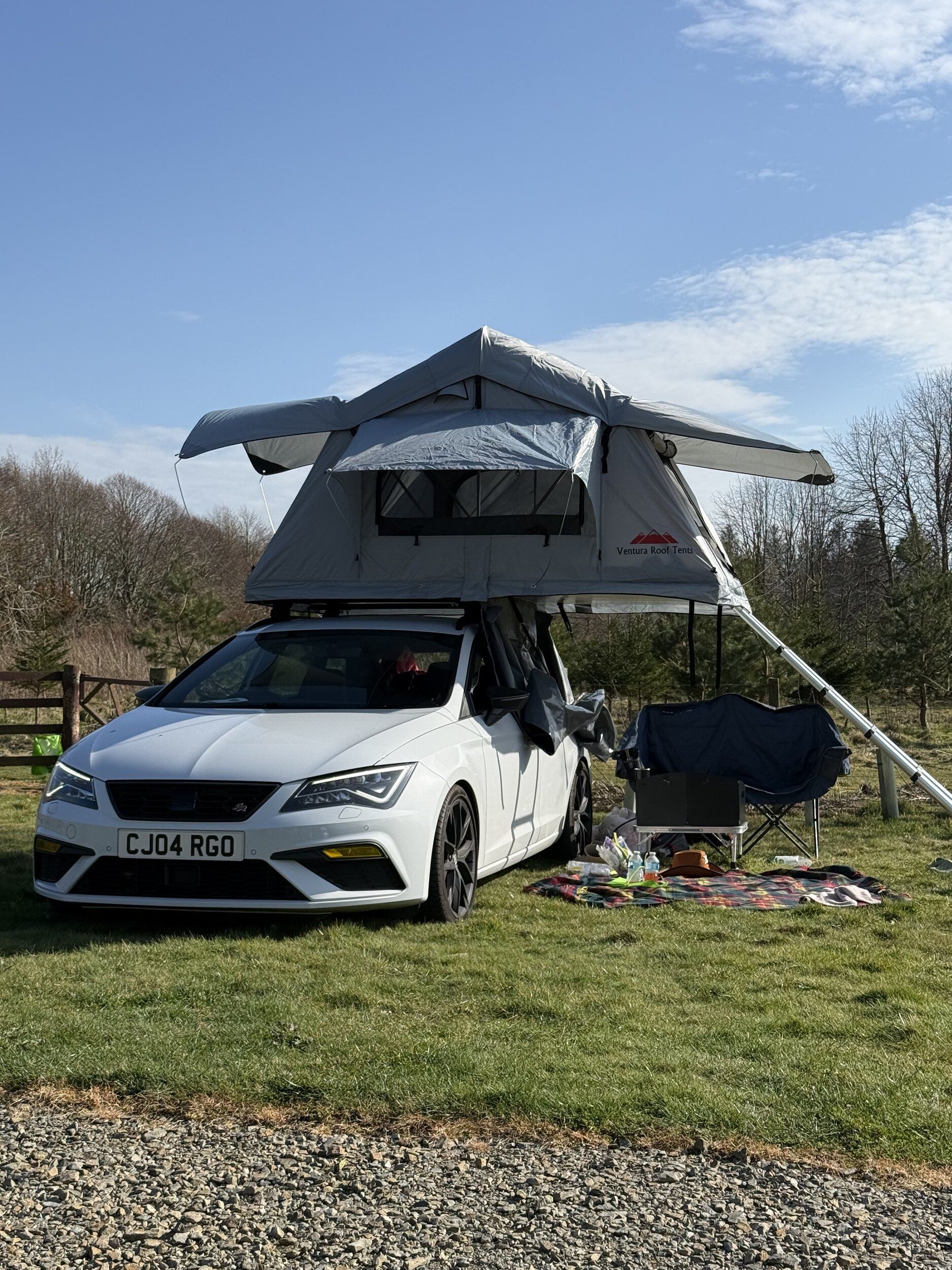

E20-15-021-05-22
Lowering front (approx.) 45 mm / Lowering rear (approx.) 35-40 mm. All Measurements are based off of non-sport models so my Cupra will be slightly less of a drop from factory height.
