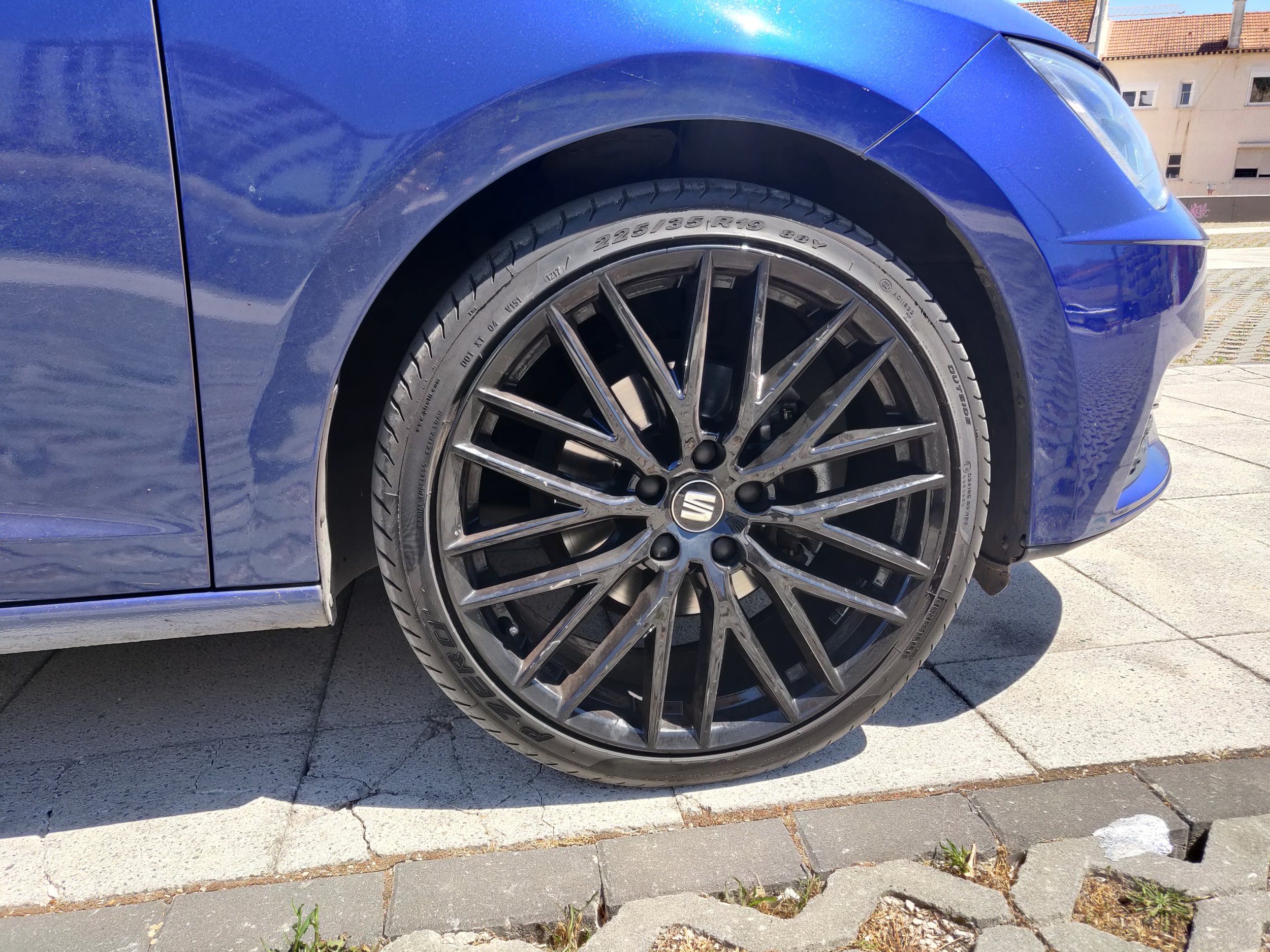

Hi guys,

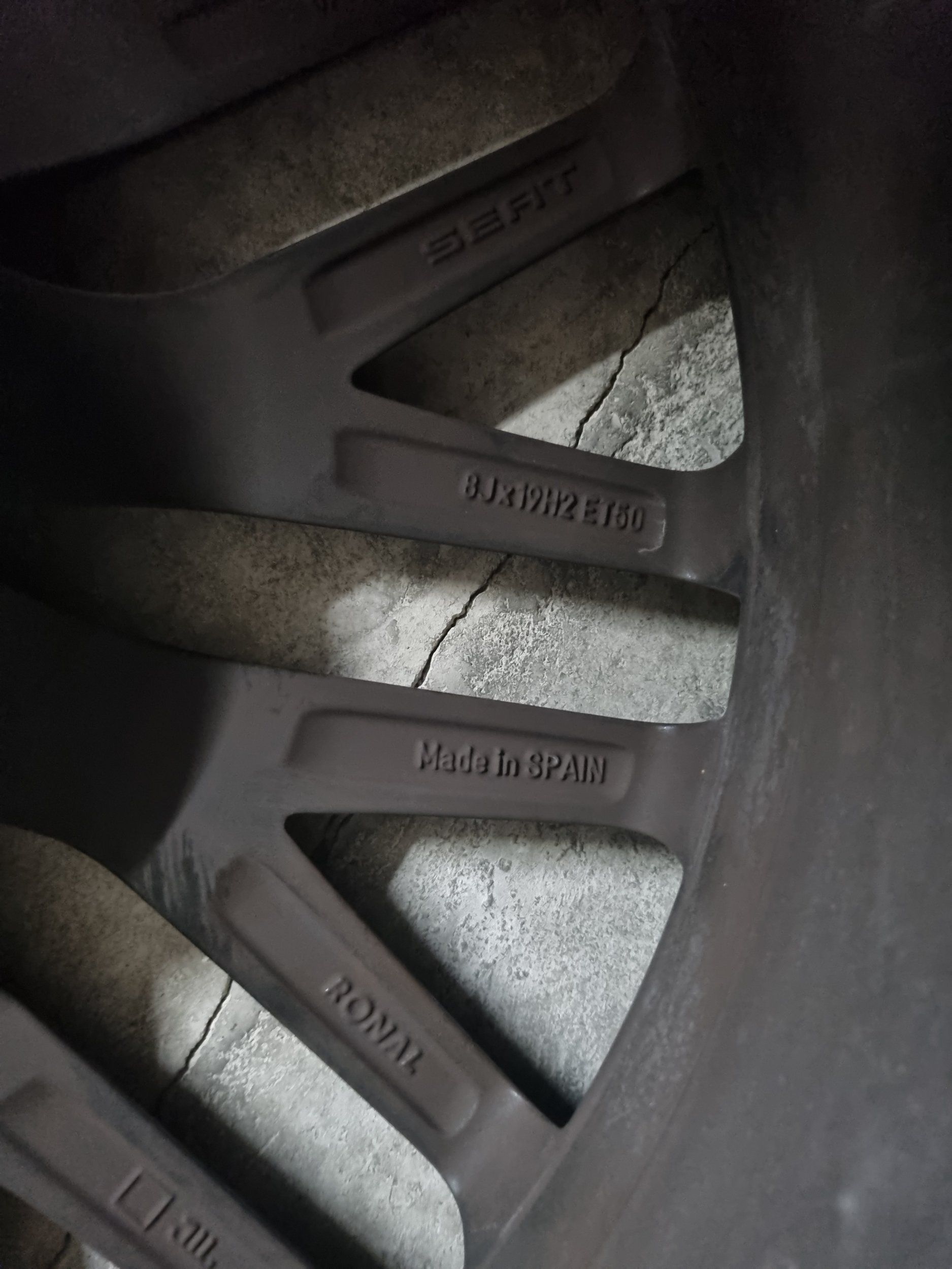

I’ve recently bought my first Leon (2020 5F8 ST FR Black Edition, diesel) and I’m thinking about getting 19” rims for summer. Is it possible, and if so, what specs should I look for?
I’d like to avoid spacers because of legal reasons.
I have in my buying OEM 18’ inch FR rims, but the bigger is better ;)

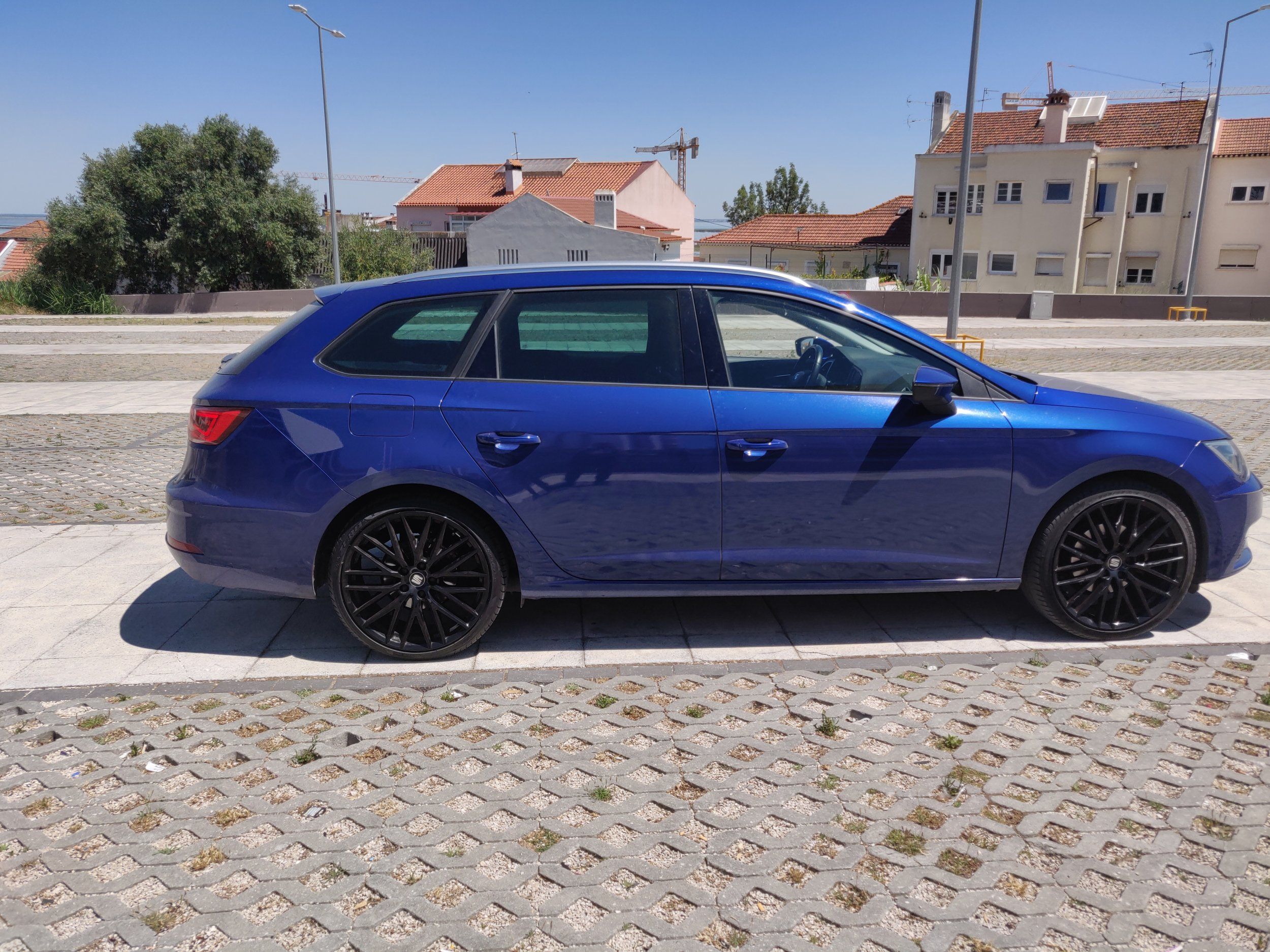

This is my 2015 Cupra ST on the stock 19". No spacers, 235/35/19 tyres
AP1GczPW3bQXT_mna6bkN-3tUW_a-avhbatjFT5wRZelq6kAqYSJ_iHyWjW5ad5K4oefodIrhij2fjHi0soxpyzsOvVAcEvg2DshD5vYCeWu6GqaD4_FTw4sH_pGls4ISN21BpWm2x8s85I3W6gz_2RyZosVbw=w1920-h1080-s-no-gm
A tiny bit tucked in

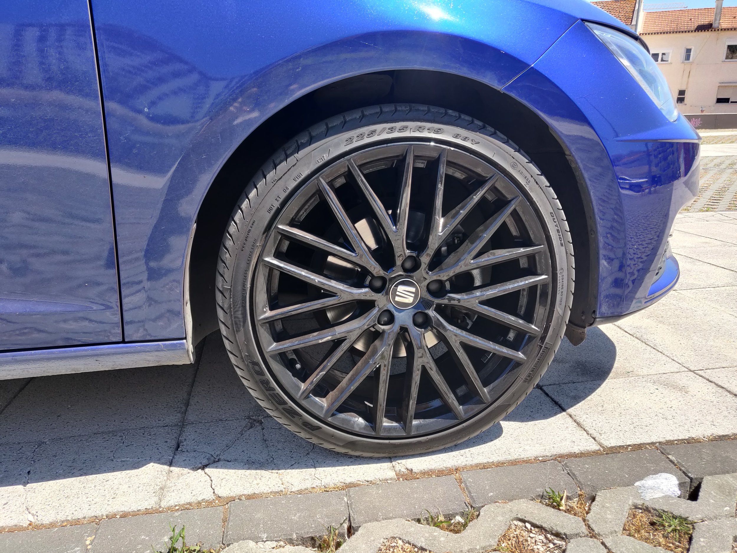

And on my MM MM-06 19" wheels. No spacers, but has 225/35/19 tyres, which doesnt look great I think. It needs the 235/35/19.
I didnt note the specs of these wheels, I will try to check this later this week
AP1GczN8jD9jg4ezjKjEfE_1REuprqGLZr-JsE7uYe2in66ELT4qNEOXRtIkWRdtA4ixLxHThZJjQqp9ySIg0woBIWUxfbBdybYZ8wDy-zGZbcpZ_dlpGuD-ZKfKOyrRWaMn5vi7S4IExwZ46KB390FxdTBIig=w1920-h1080-s-no-gm
Sits flush, which I like
AP1GczPwptHLiaEuV7WYyPAxduPbS4ljrW768CgJWUgyBIlXzR8P-NlrTmnofhasG76cb_Pi5SJ9TS4xezHcnTBohqVwgDZ9BgScPNCgBfdWrwCTVMCyqKakmmriT39qcGnA9BygtiFjO4amt2k2iJvYh-lHmg=w1920-h1080-s-no-gm

Thanks guys for all the replies!
I think I’ll stick with the 18’s since the roads in my country aren’t the smoothest.
