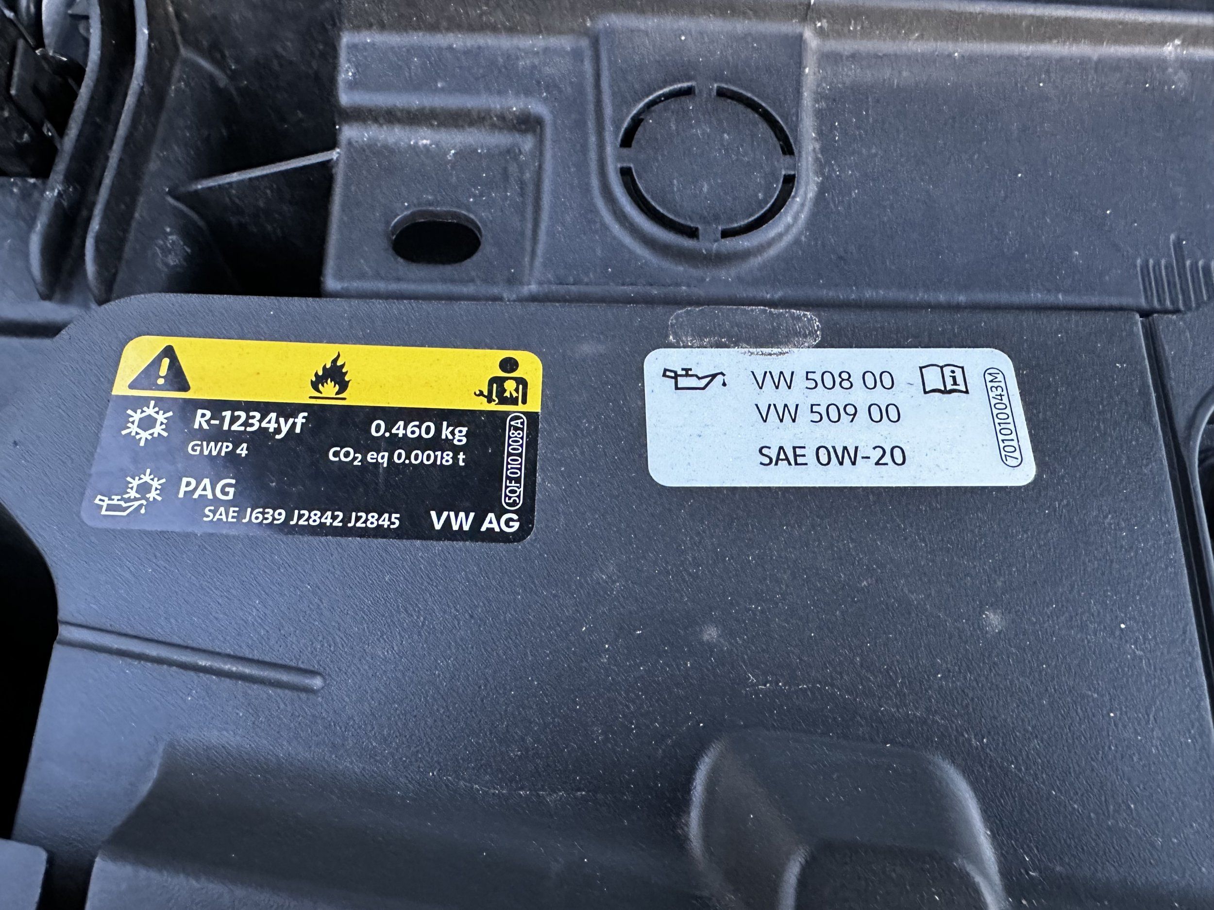

Do you have a label with oil details in the engine compartment as per the image?
Sent from my ONEPLUS A6013 using Tapatalk

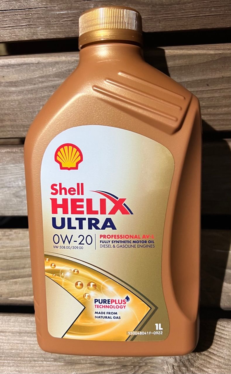

Bought this today for our 1.5TSI
£12.99 for a litre from the local Euro Car Parts place.
Whatever you use for the 1.5 should be VW 508 compliant and 0W20.
