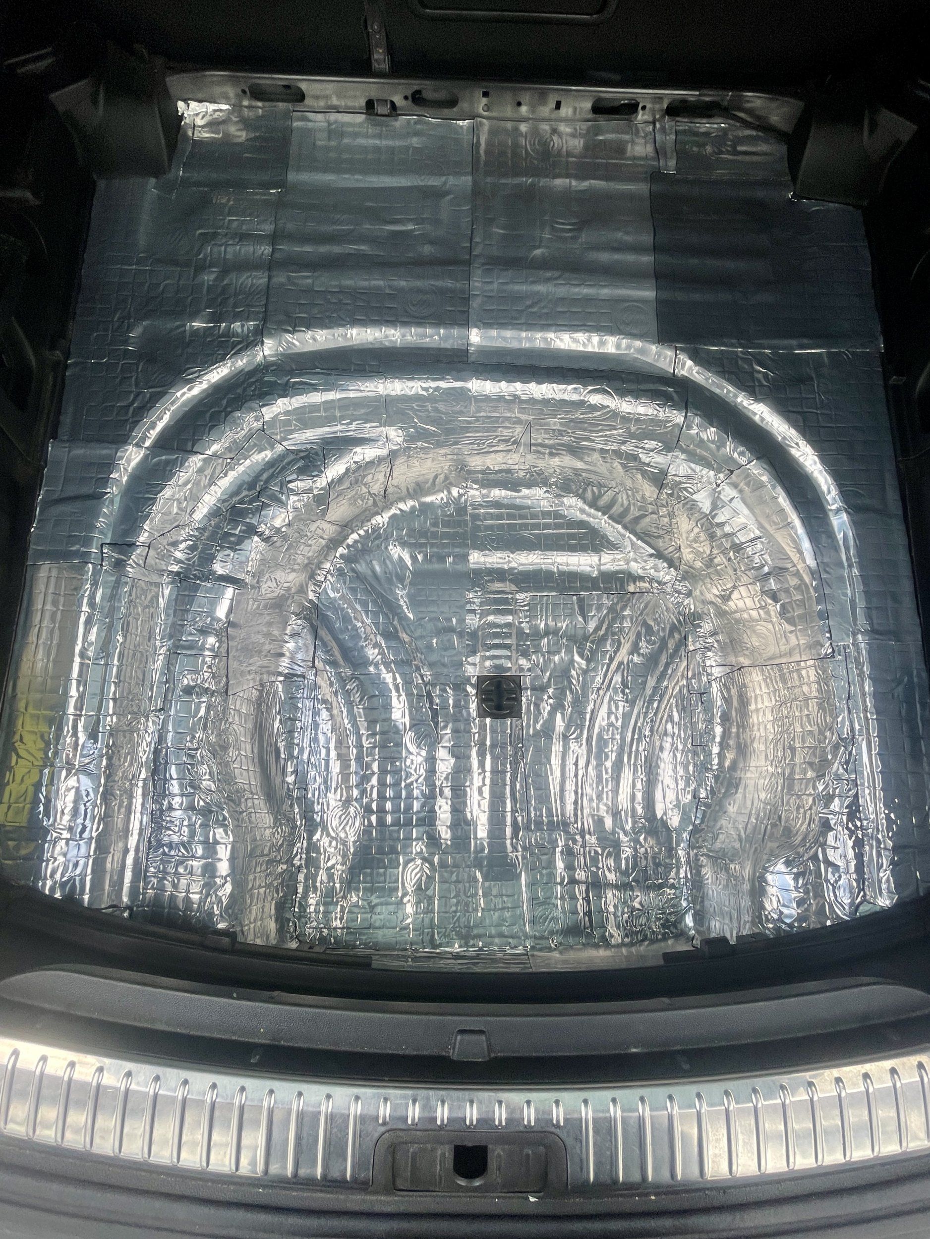

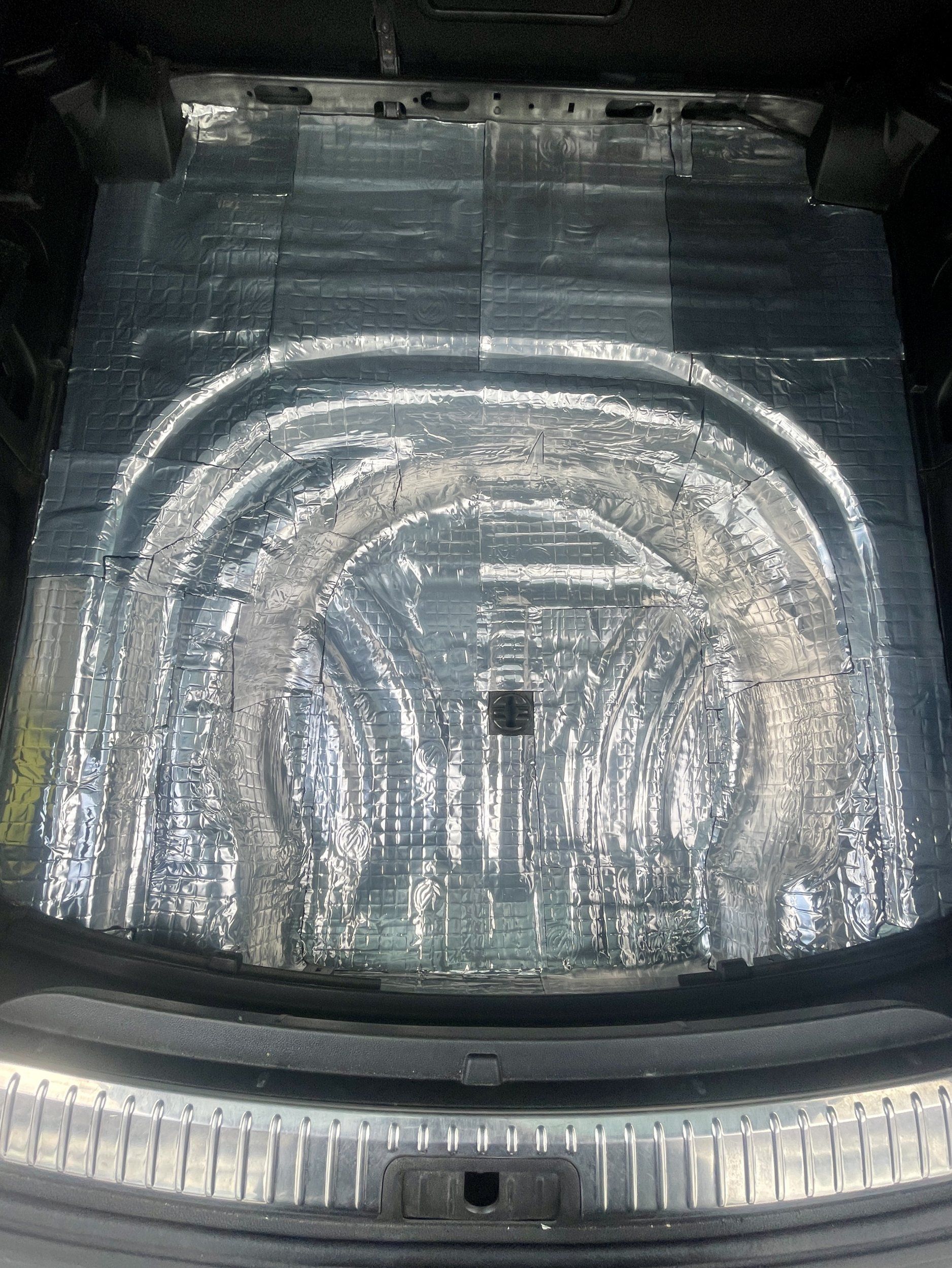

I see some people have added sound deadening to the boot and arches to block the tyre noise. Might give that a go!
Haha I’ll take that advice. Maybe look into a sports exhaust to drown it out haha!
Did this to my ST and it made a big difference to the thudding i used to hear.

I can vouch for the sound deadening helping reduce a lot of noise in the boot, and you can do a fair amount under the rear seat bench too, which is a doddle.
