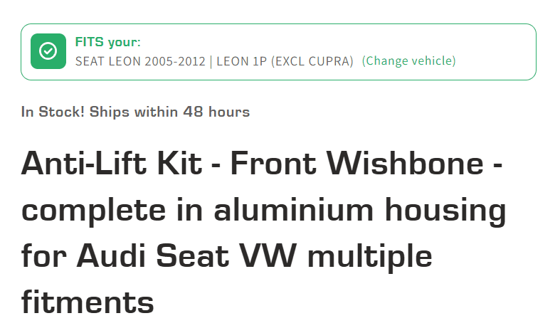

This is the kit

But why does is say excluding cupra? maybe due to the fact the Cupra already has those bishings geometry from factory?
