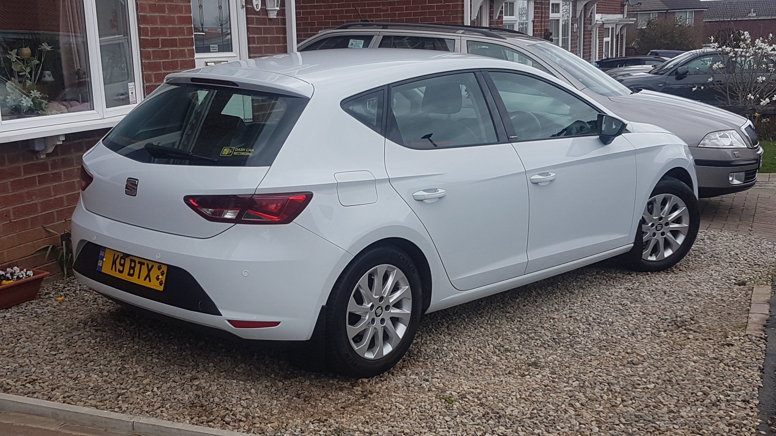

Did my last leon and new one I love the look and a hell of alot easyer to polish with it de badged

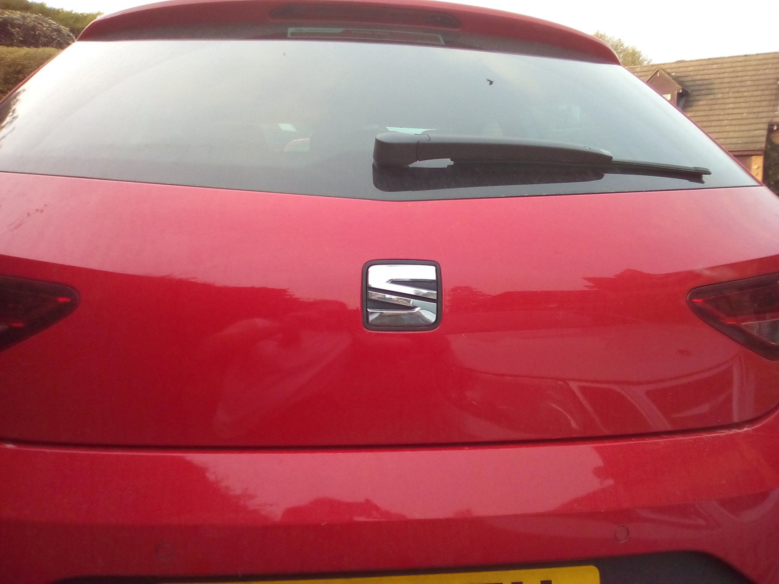

I also removed mine but left the FR badge. I just heated them with a hair dryer and then used fishing line. I then used sticky stuff remover to remove the left over foam/glue. This is before (when I first got the car):
And a few weeks ago:
