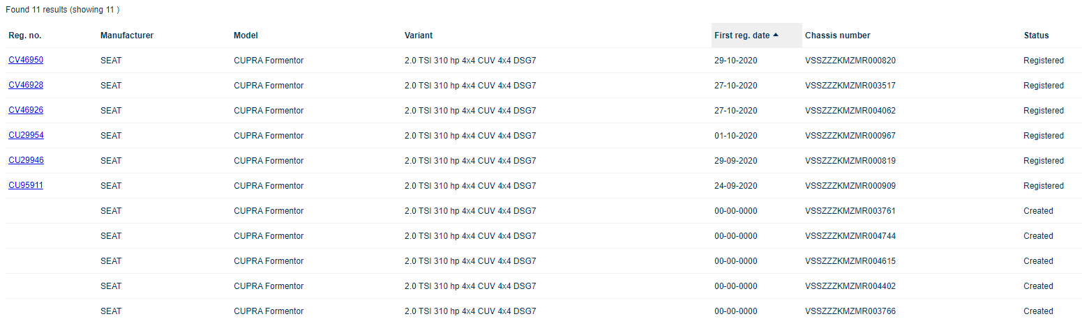

Yeah I know there's some driving around in Denmark but no one at the dealers (at least not here in Aarhus).
Last I checked there was 3 registered but I can see that 3 more has been registered in the meantime - hopefully some dealer cars! ;)

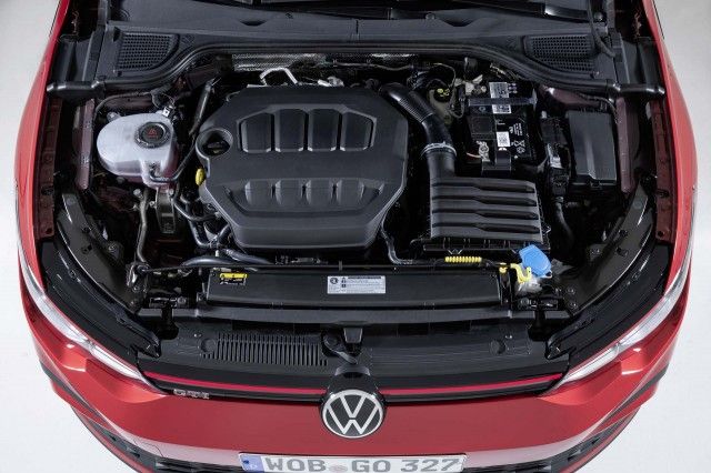

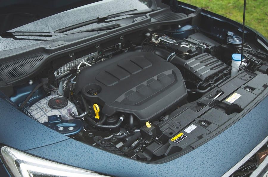

I don't 100% know how to spot if it's an Evo3B or Evo4 because they might have changed the look of the 3B engine, to use some of the same parts as Evo4, to reduce production costs. That said, the Formentor engine bay looks very much like the Evo4 of the GTI, see below.
And just some bonus info: the biggest change of the Evo3B engine compared to the Evo4 is a new turbo (still IS38 though as far as I'm informed) and new intercooler. The use of a digital SENT protocol for the fuel rail pressure sensor instead of a voltage based one because the fuel pressure has been raised from 220bar to 350bar through the new fuel injectors.
New Golf GTI Evo4 engine
Formentor engine

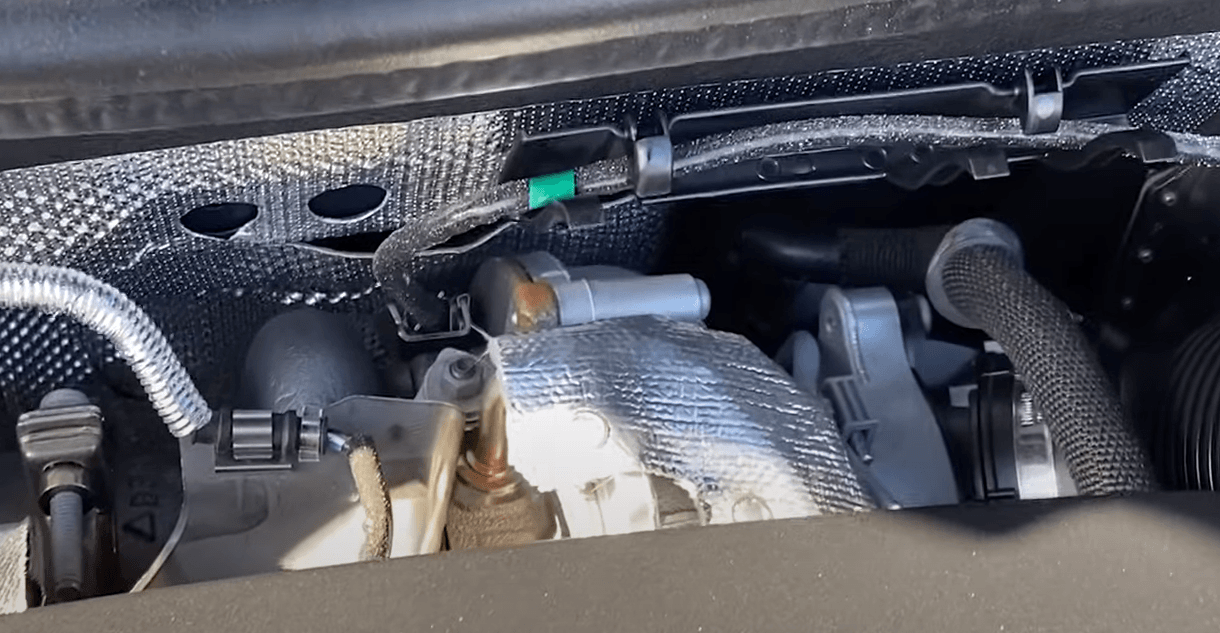

The problem is that I honestly don't know how to spot the difference. Because they might just have changed the engine cover on the Gen3B engine to save production expenses.
Before selling my S3 I took the below photo. I have put a photo of the Formentor turbo beneath it and it doesn't look the same so for now it looks like the Formentor uses the Evo4 engine but lets see when we can confirm it with a definite engine code.

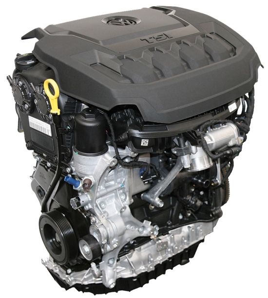

This is the evo3B in the Tiguan if it helps. My facelift Cupra Ateca is still evo3 DNUE code.
EDIT: After a bit more digging my car is evo3B engine, so much conflicting info on the internet it makes it a bit confusing but heyho.
