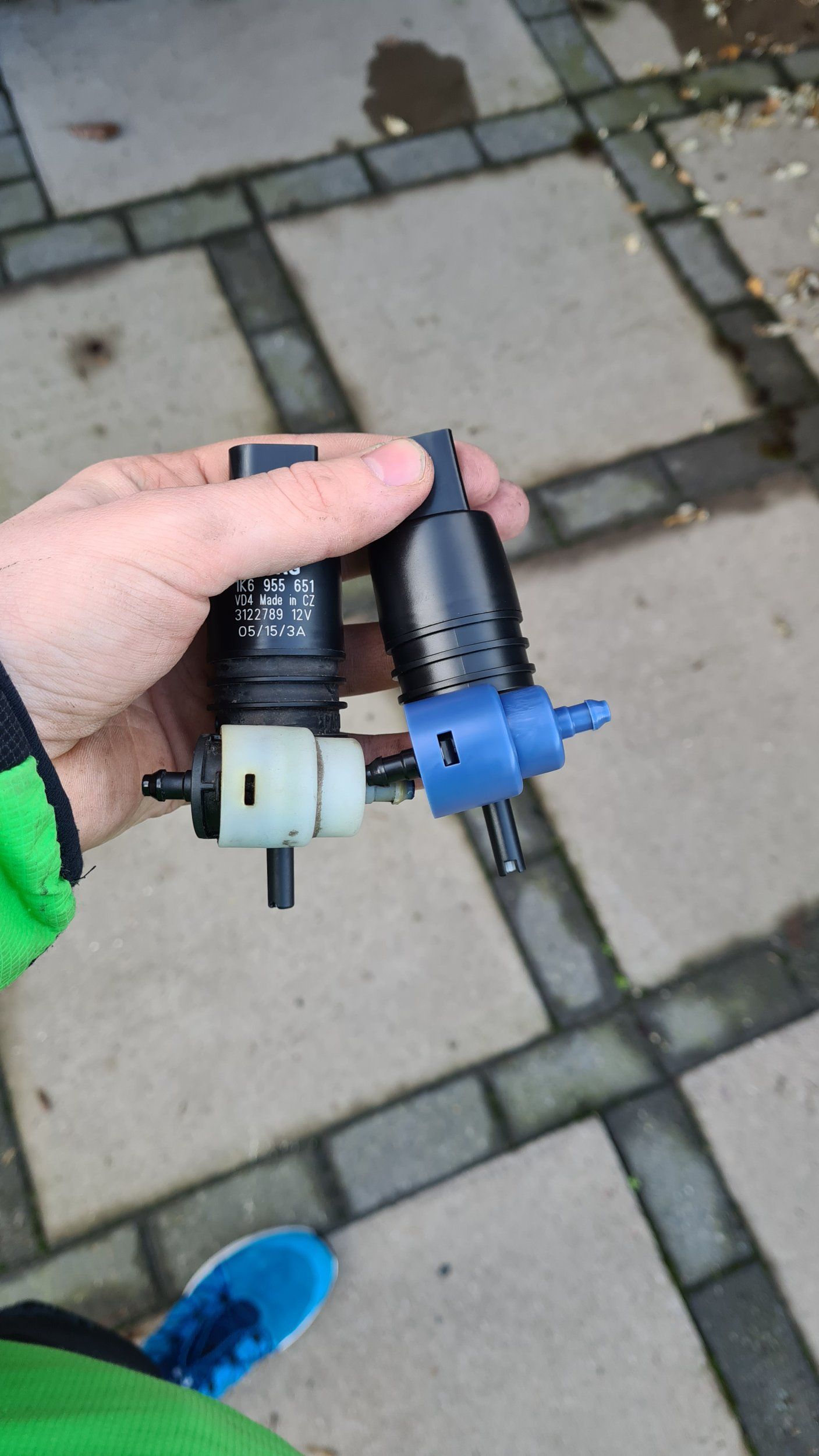

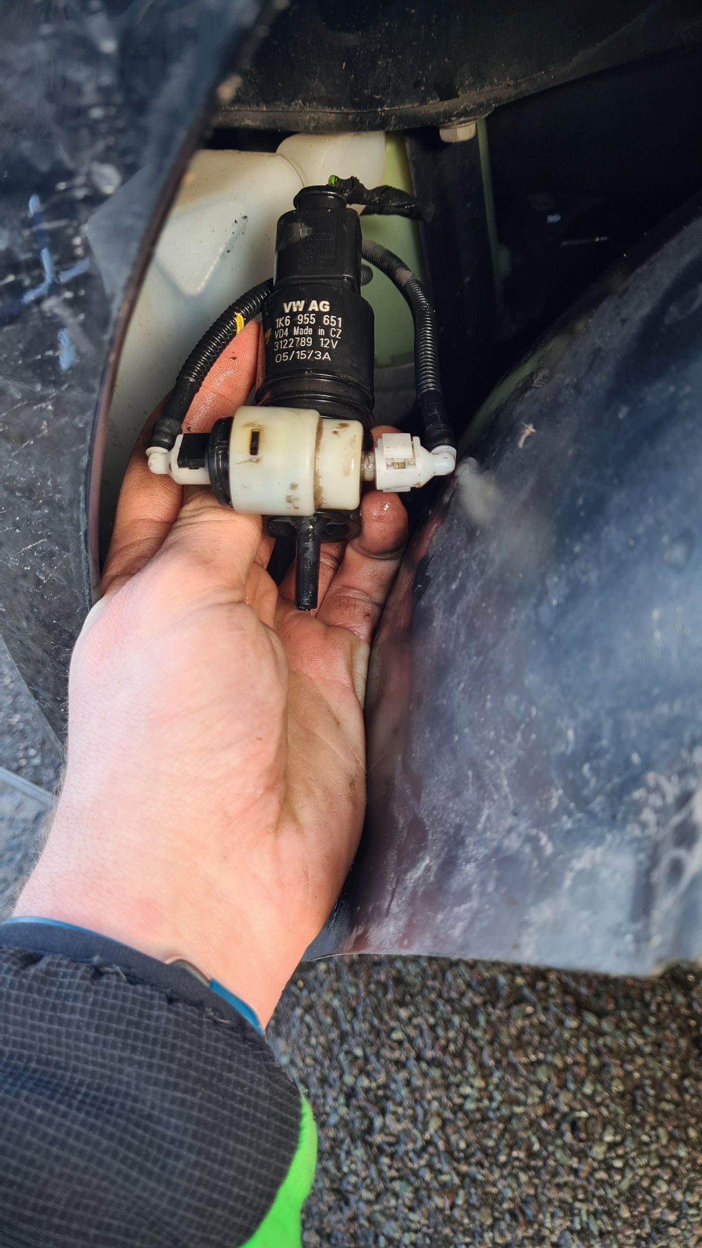

Mine did this, it turned out the pump had split (see image for comparison of split pump left, and new pump right).
Its a simple fix just re
move wheel arch l
iner and the pump is push fit into the bottom of the tank.
Its a simple fix just re View attachment 35480 move wheel arch l View attachment 35479 iner and the pump is push fit into the bottom of the tank.

Cost me about 15 quid then an hour to fit
