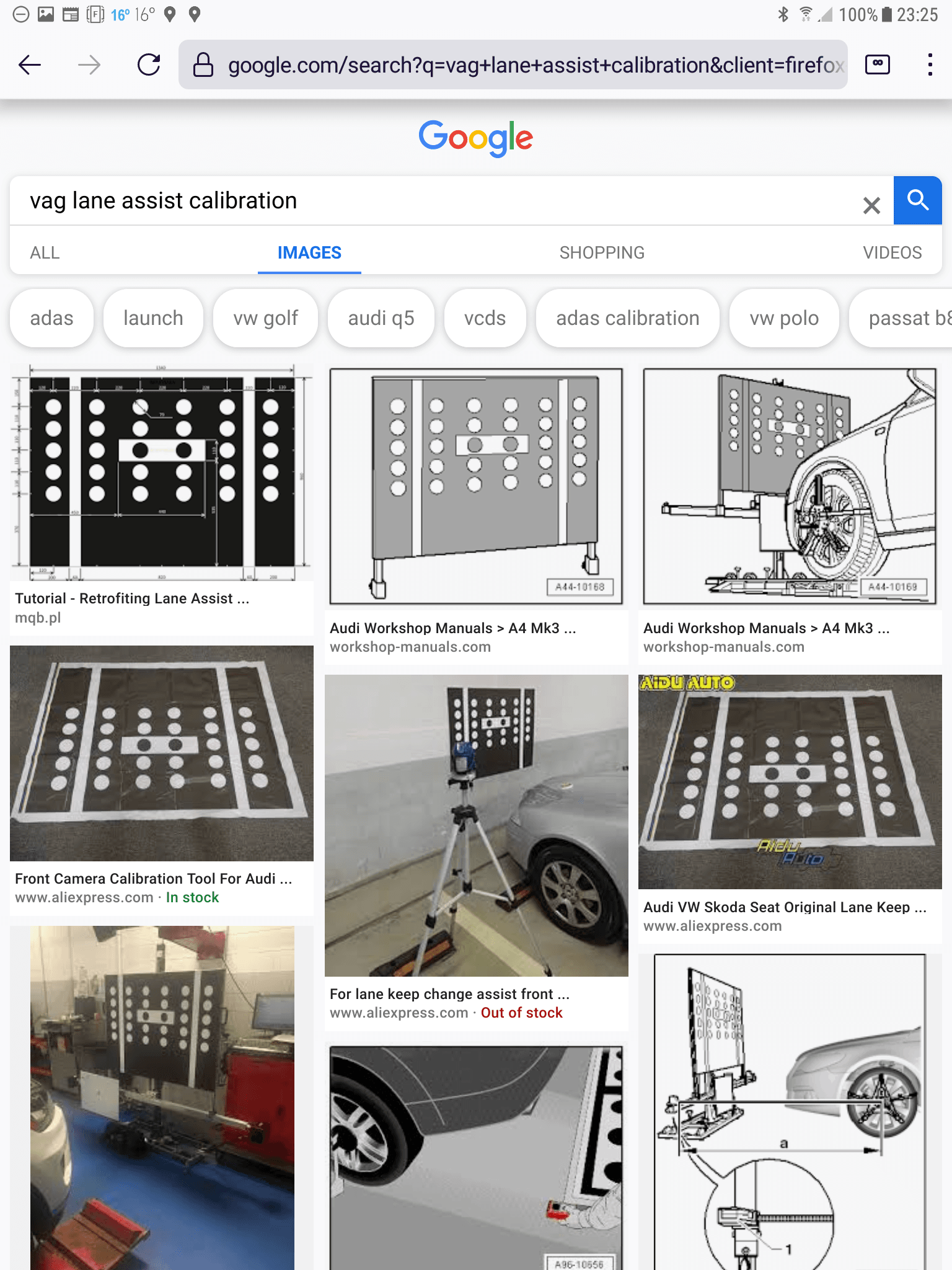

They are suppose to use VAG calibration equipment. They were in short supply / price of the equipment, so the cars get taken to designated places with the hardware.
Tracking the wheels and lane assist camera have to be done together (the story) else the car pulls to one side or another... then you weave with lane assist although there are other lane assist calibration settings to reduce weaving (VCDS). Front steering put at dead centre during calibration.
Suppose to be a big deal when you get the car tracking done when you get your tyres changed. Protyres never said anything to me and I don't use Lane Assist so I kept stum. Tyre people so I've read can bypass the full calibration set up with the board if they set the front wheels at dead centre - not VAG guidance. But changing front windscreen they have to get the camera calibrated correctly for lane assist to work correctly.
Images:
