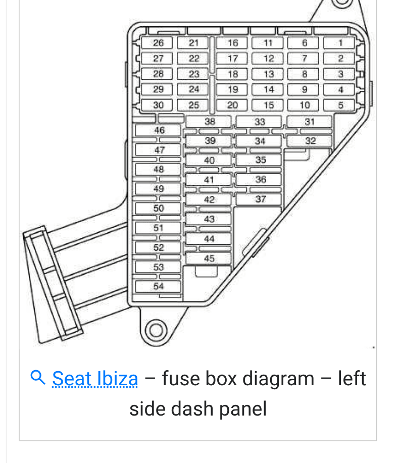

I'm trying to find the location for the windscreen washer fuse. The manual says position 20 in dashboard end fuse board and a diagram I found online agrees with this, but there is no fuse in the position. It's five rows down from the top and three in from the left. Any ideas?
Yes, washer pump it's pos 20 - 10Amp. Also it might be different depending your Ibiza model and Year. If your car has a left steering wheel, the position changes.
