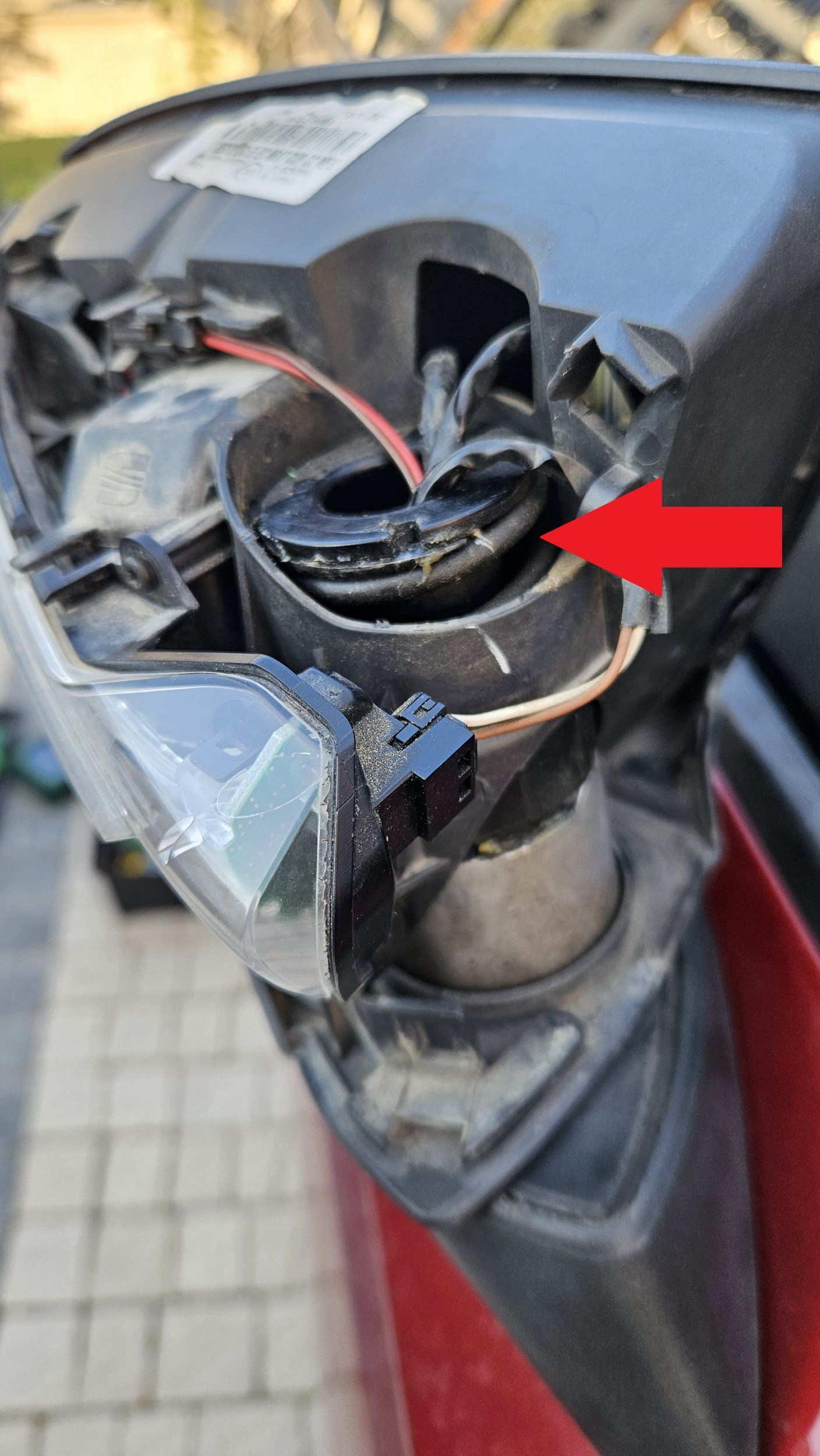

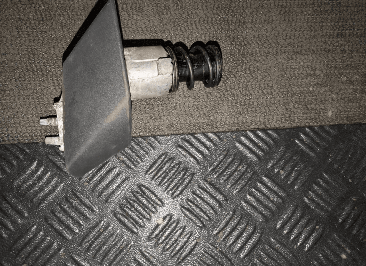

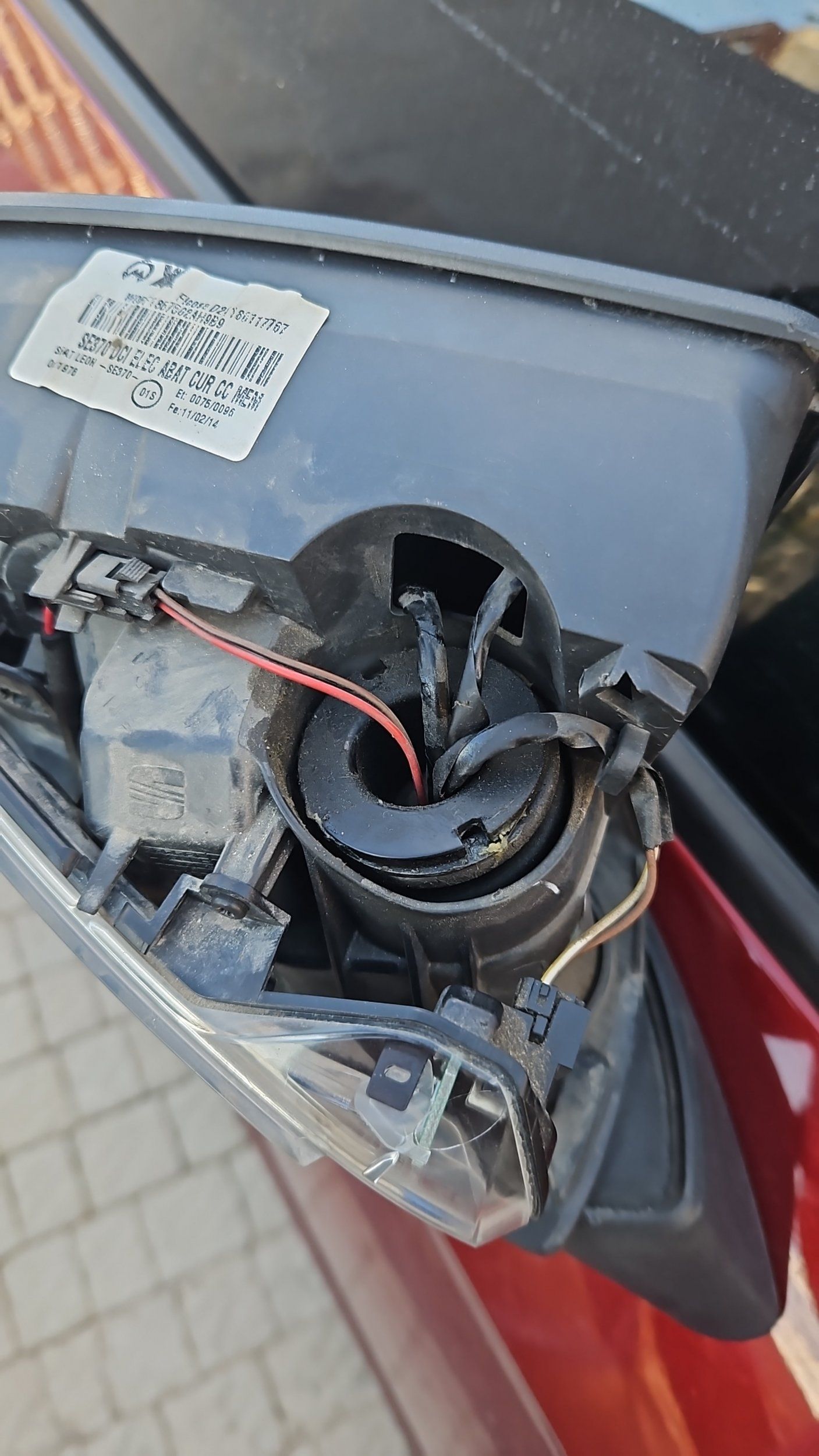

I have a Seat Leon 2014. My cars right side wing mirror not folding. I can remove back cover but cant remove inside of spring. So I cant acces to motor. How can i acces to motor or remove spring? Thank you.

as a supplement... you must first press the spring so that you can unlock
To be honest, the easiest thing to do is just swap the whole mirror. Used ones are not that expensive and the cover just clips on.
I would be interested to know where you can get the folding motor individually as a spare part?
