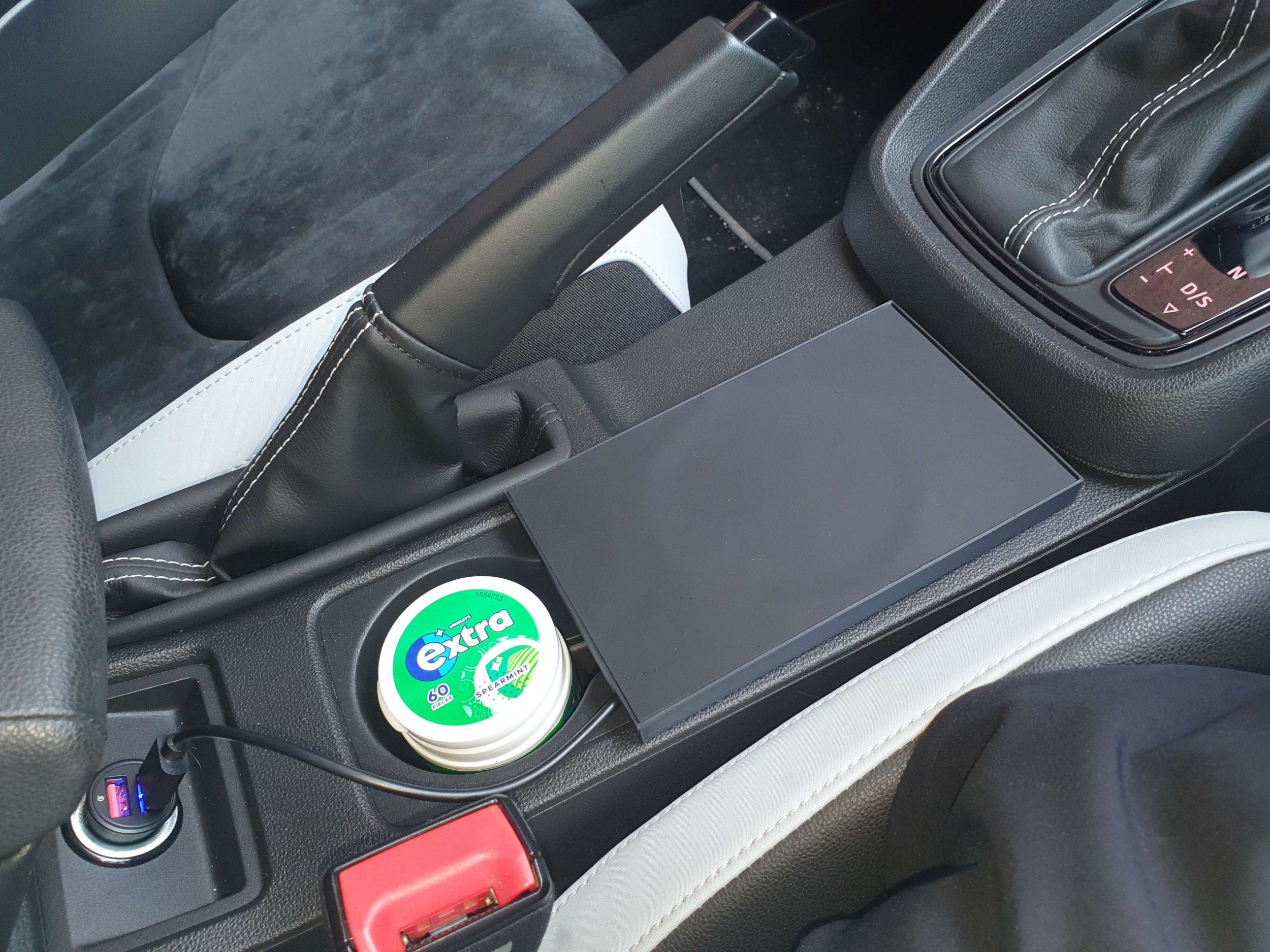

Now I need to figure out a nice method of adding wireless charging. Tempted to try using a USB splitter but aprehensive as to not pull too much current through a single port so may just use the 12v under the armrest with a usb adapter and 3D printed wireless charging mount in the cupholder but may just stick with a wired backup should I need it.

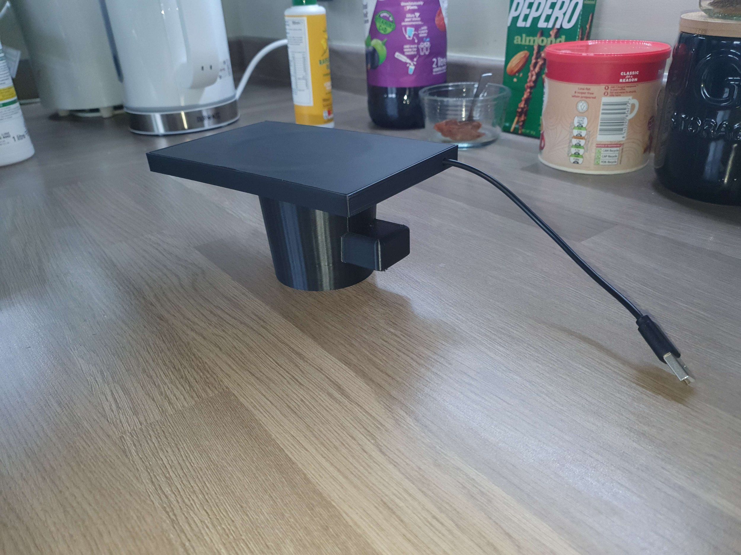

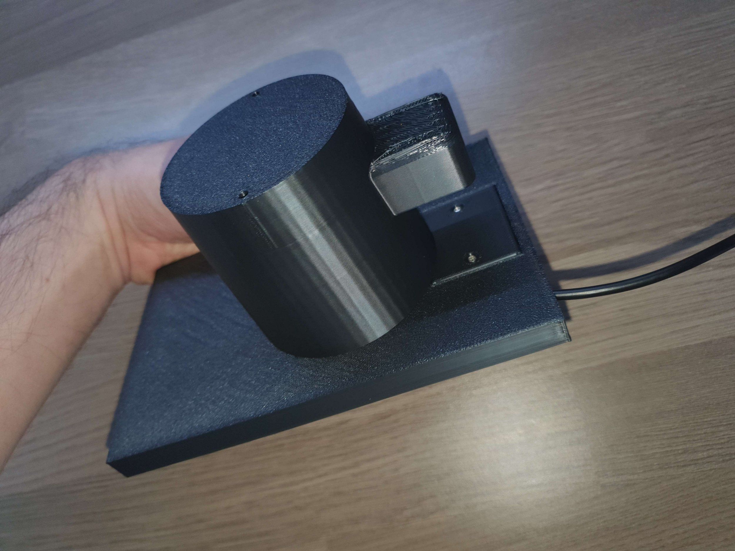

Here's the end result for the wireless charger.
Although its not perfect, I'm pretty happy with it. It should be capable of 15w fast charging but my phone only supports 10w iirc but it fast charges my S10.
Some links for bought parts and attached images + STL file if anyone wants to print one.
Charger: https://www.amazon.co.uk/dp/B09QFQ3CW3?psc=1&ref=ppx_yo2ov_dt_b_product_details
3M anti slip: https://www.amazon.co.uk/dp/B0BKFT1MJD?ref=ppx_yo2ov_dt_b_product_details&th=1
12v USB adapter: https://www.amazon.co.uk/dp/B07XM7YGQ5?psc=1&ref=ppx_yo2ov_dt_b_product_details
You would also need a usb cable and then cut and splice it to feed it through the case to the charger.It's a clean way to get the cable the correct length but I think I'd find another solution if I needed to reprint it but the STL file is there should you want to do that.
I used heat set inserts and screws to connect the two printed parts but you could glue it instead I imagine.
