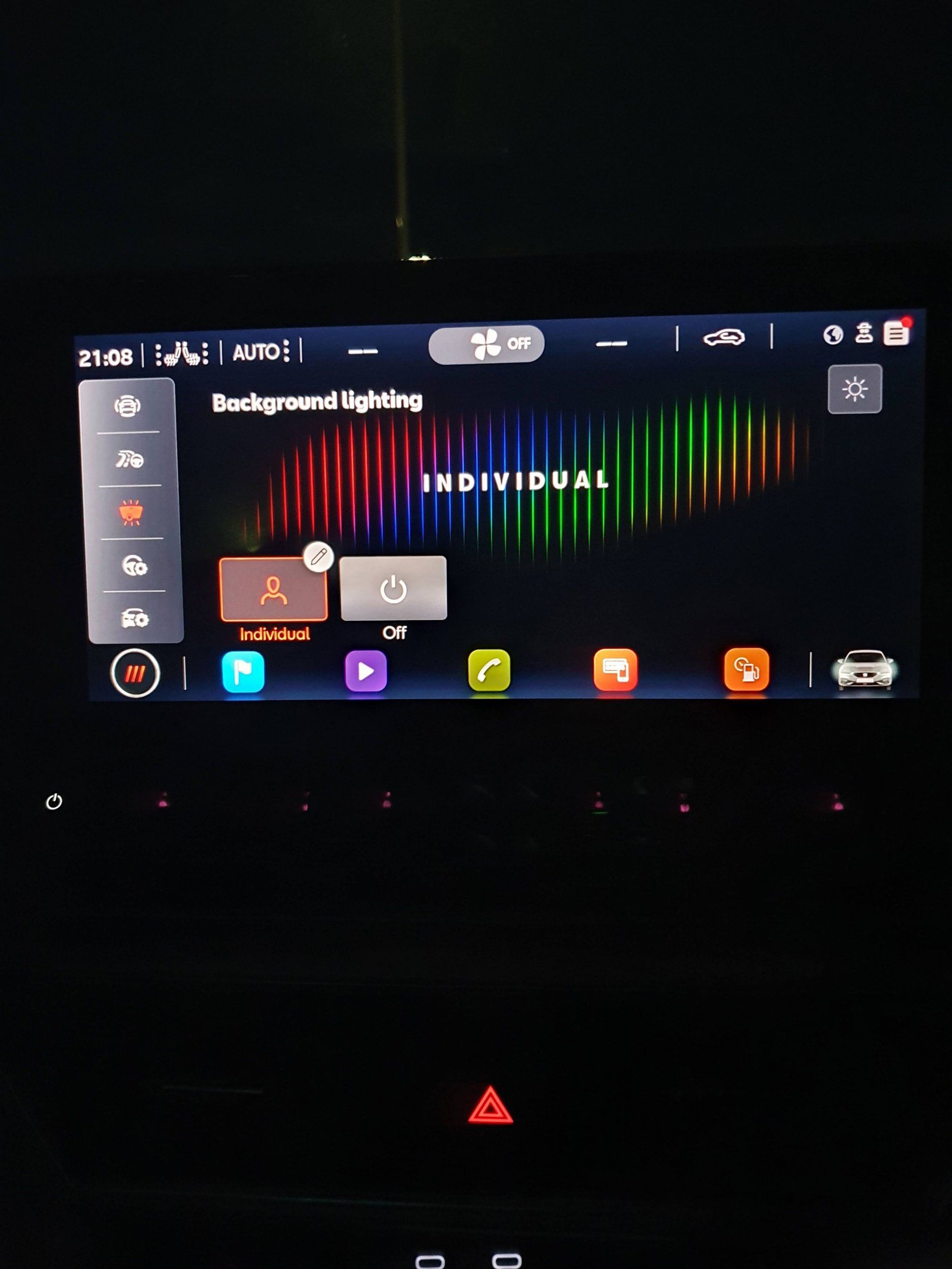

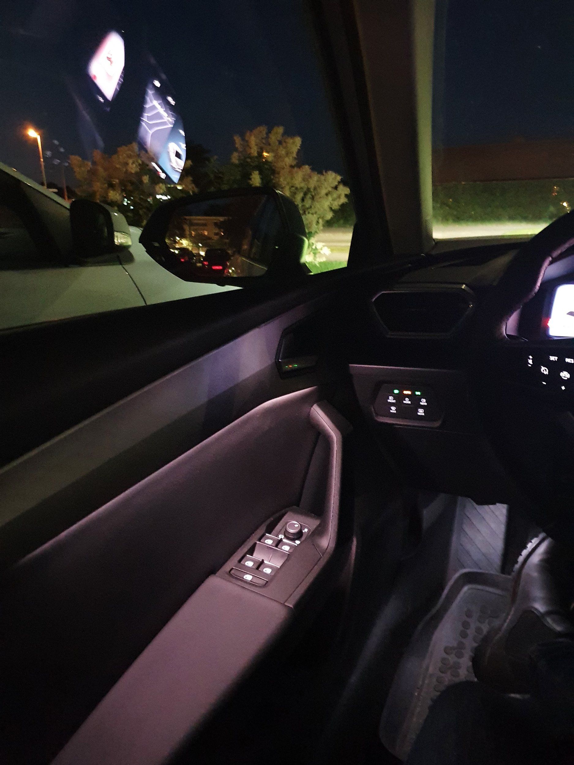

I have bought a seat Leon ST fr 2021 with wraparound interior lighting when I bought the car the light was work and I had many choices to change the color but som how all the choices has been deleted and I have just the choice individual in the background lighting menu as you se in the picture. My question is how to install the color package on my car to make wraparound interior lighting work again. I put my car to seat service they download the latest update to my car but they doesn't help me to fix wraparound interior lighting they say that my car doesn't have this funktion but the truth that my car have this function and it worked when I bought it.

You don't have wraparound interior lighting from those pictures anyway, that's just ambient lighting. You'd have a light bar all across the dashboard too if you had - are you saying that you used to have this?
yes I used to have but it doesn't light because I can't choose from the menu to light it. as you see I have just individual. when I bought my car it worked. the menu should be like this pic

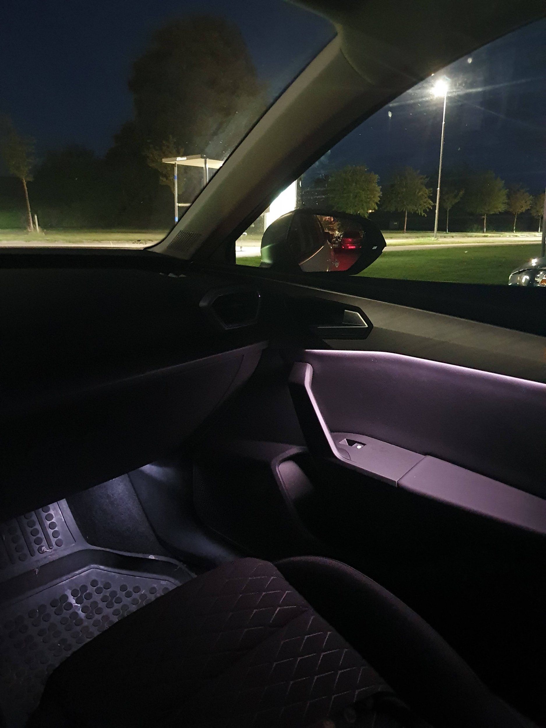

Got a 21 plate arona and just noticed all our options for interior light colours have disappeared. There is 1 option for intensity of the lights but it says we can't use this function. We set the lights to red but now we don't have any options of colour so I think this guy's telling the truth. They've 100% took the option out on an update.

no its not solved. The contact center for seat they said to me that my car dosent support this function they lieing I wish that I have pic to show them. as u see in the pic I have in my car from both side Led light I show them but they said that I have to buy this function.
I think you have ambient lighting and not the fancy 'wraparound' lights that run along the top of the dashboard. Indeed from your picture it looks like you have the lights in the door, however I'm pretty sure you don't. It looks exactly like mine and i don't have them.
