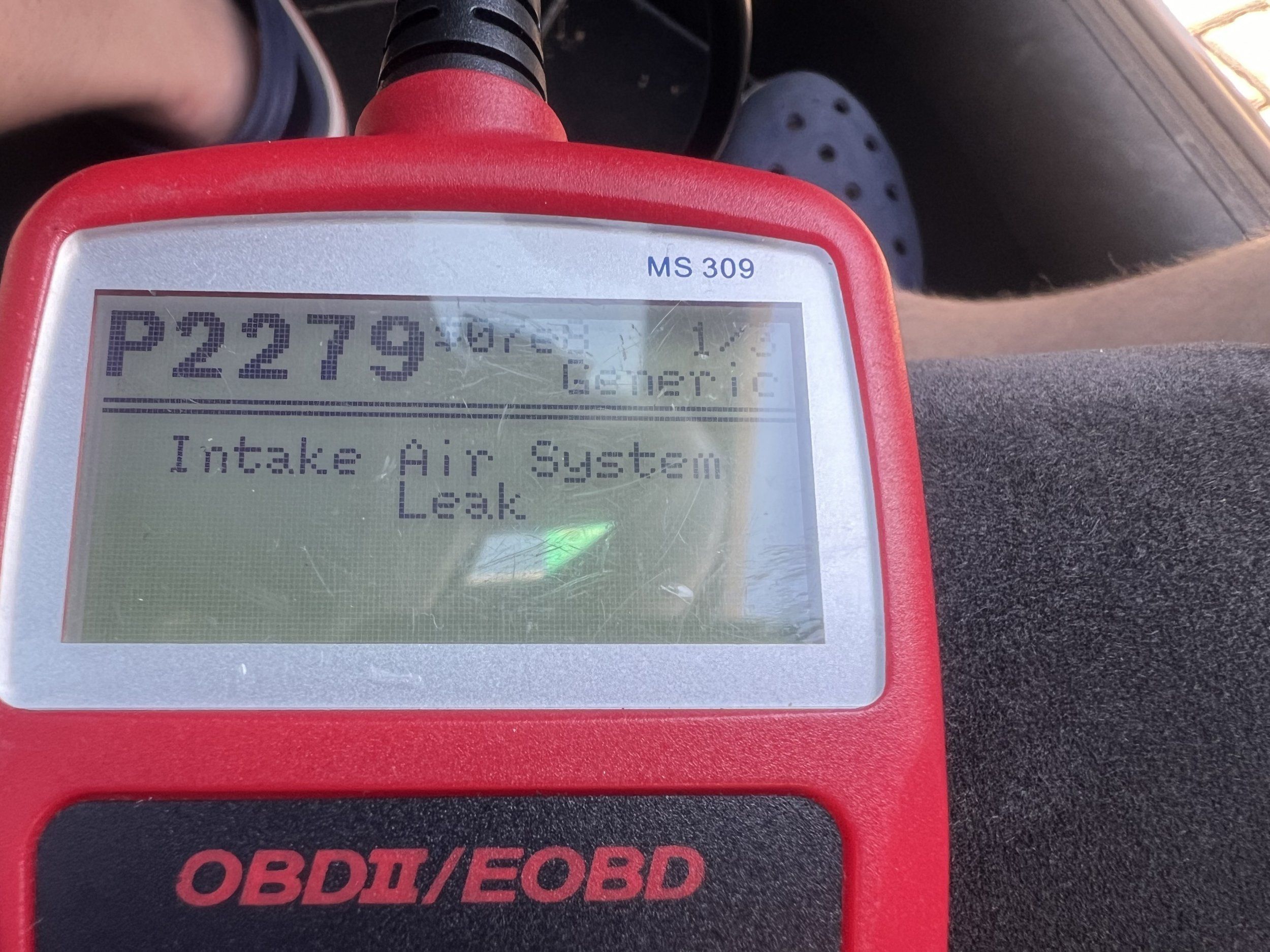

plugged in the OBD II reader and its come up with Air Intake system leak
could that be the R intake pipe? or maybe a sensor?

which bits do you mean? the intake pipe from the air box and into the turbo? did check all around it and nothing feels loose
the only thing I have done different is top the car up with half a litre and then the problem came about 40 miles later.
wondering if maybe the dipstick needs to be replaced and oil cap maybe? car is 17 plate and 100k miles.
I mean all the intake connections from the airbox up to the turbo elbow. Any oil in or on the turbo elbow, or intake hose? Any other error codes?
i switched the oil cap around and seems to be fine after a drive.
I noticed a bit of oil residue on the brake cylinder so maybe it was not on properly. will keep updated.
