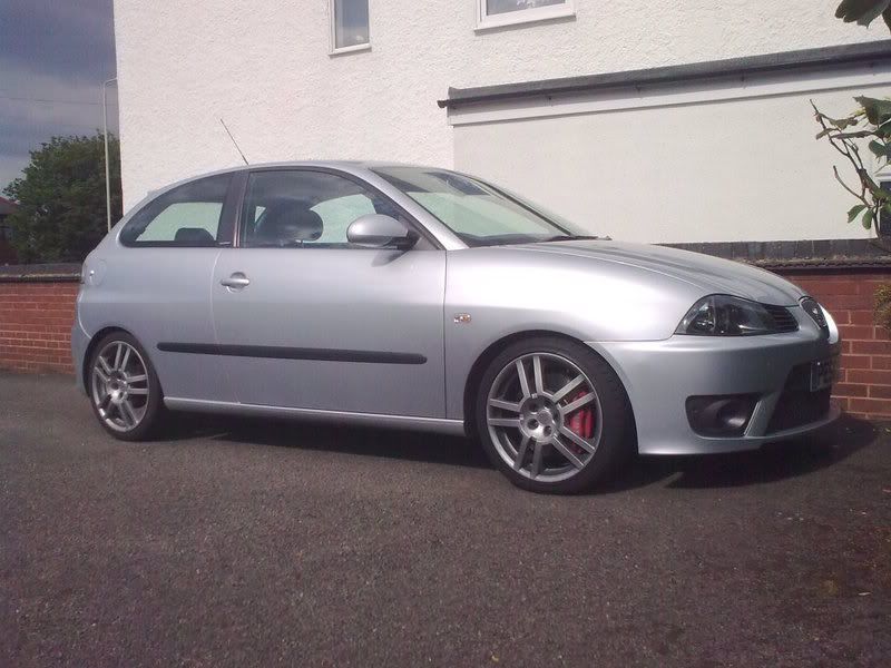

So the car now handles amazingly.. its more comfortable.. its a bit lower, but still gets over all humps ive tried.
How it looks now, plenty low enough for me, there is plenty more it could go down, but i need it too be useable. 20mm rear spacers are a must now.

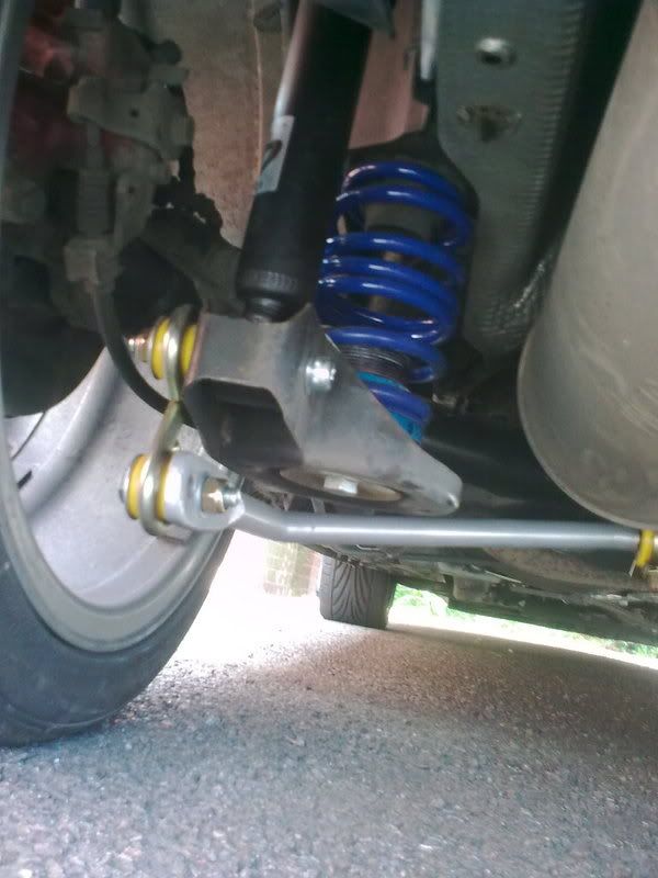

RARB on rear suspension

What setting is your ARB on? Whiteline is 3-position adjustable right?
I`ve been considering one for a while now, I have standard suspension which will stay - just looking to sharpen up turn-in and reduce understeer.
Edit: never mind, just noticed in the pic it`s on medium! :doh:

I have said for a long time now this is one of the best handling mods you can do... it transforms the handling so much! Looks like its on the middle setting in that picture above. Get it on the stiffest (hole nearest the front)!!!
There must be downside of it being on the highest setting, dont want the back end getting lively in the wet etc :)
Seriously effective mod for the money, if you are at all interested in the way your car handles you need one of these. Should have been a first week of car ownership mod!!
+1 ive never had mine on any other setting apart from the stiffest i still have standard suspension but these create a real planted feel and you really have to re adjust your driving when you fit these at it seems to make the car turn in sooner almost like the steering is sharper.
ive forgotton what its like to drive without one now but id never be without the rear arb in a mk4.
