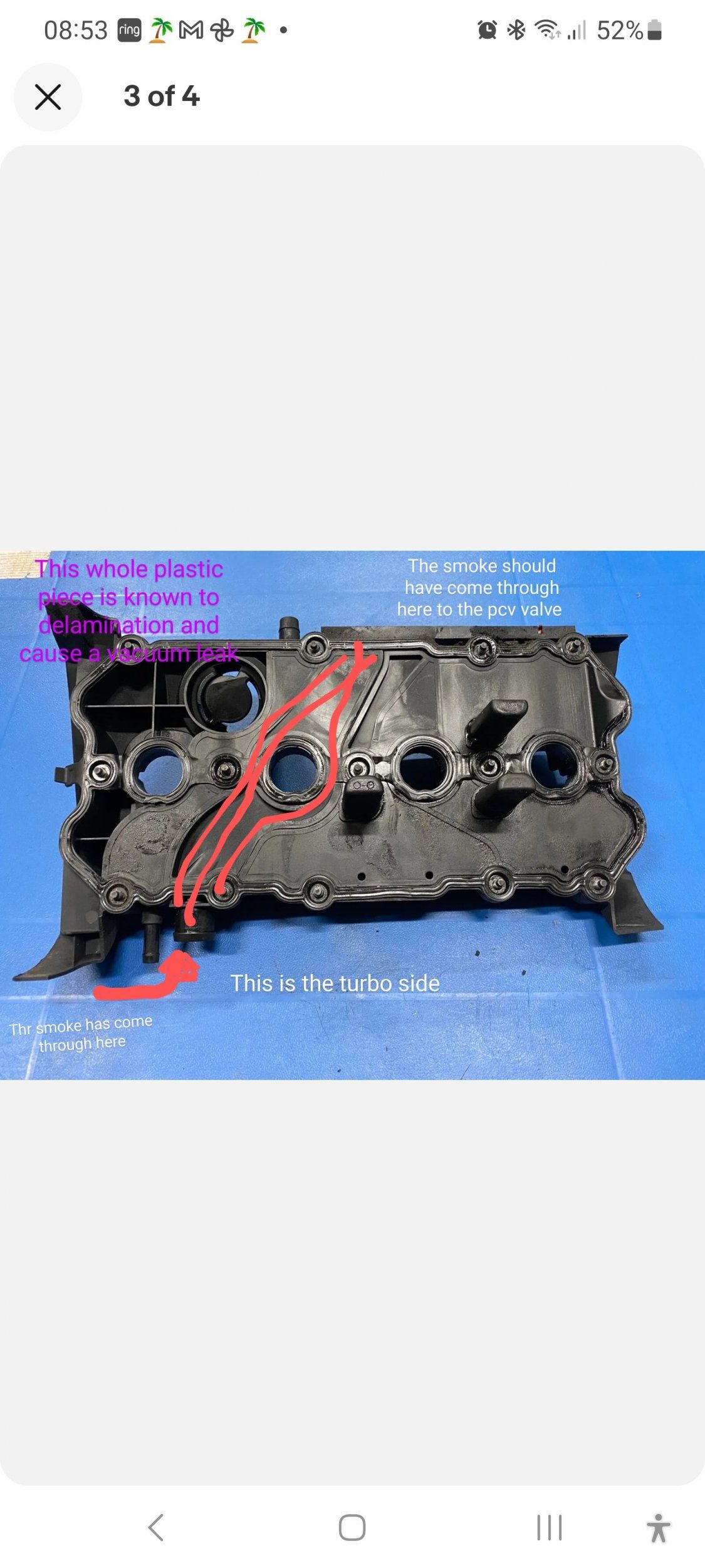

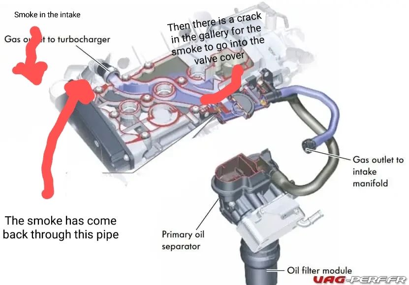

I have finally found the vacuum leak! I bite the bullet and purchased a smoke machine for the vacuum system and boost system.
https://amzn.eu/d/5zC85pa
It turned out to be the value cover, it is part of the pcv system. I put the smoke machine in the oil filler hole, and it come out of the pcv hose. I did a youtube short to show it.
I got that package from r tech and it was brilliant!

It was the whole valve cover. When I put the smoke machine down the intake, smoke was coming from the oil filler. I have ordered a second hand valve cover I'm going to test that with the smoke machine, then I'll give you an update. I'm not saying that is your issue but it is a good idea to test it.

This is how I have come to the conclusion it's the pcv system in the valve cover.

So it's not the valve cover gasket because the valve cover itself is prone to delamination inside causing vacuum leaks because the engine will be sucking air that is not measured by the maf sensor causing the fuel trims to be off when the lambda sensor is reading the exhaust then the engine compensates the extra air with extra fuel

The new (to me) one is due to come in the post any day now. When I take it off, I'll also try and get a video smoke testing it, to see where it failed. The pcv system on these cars is so complicated. 😂

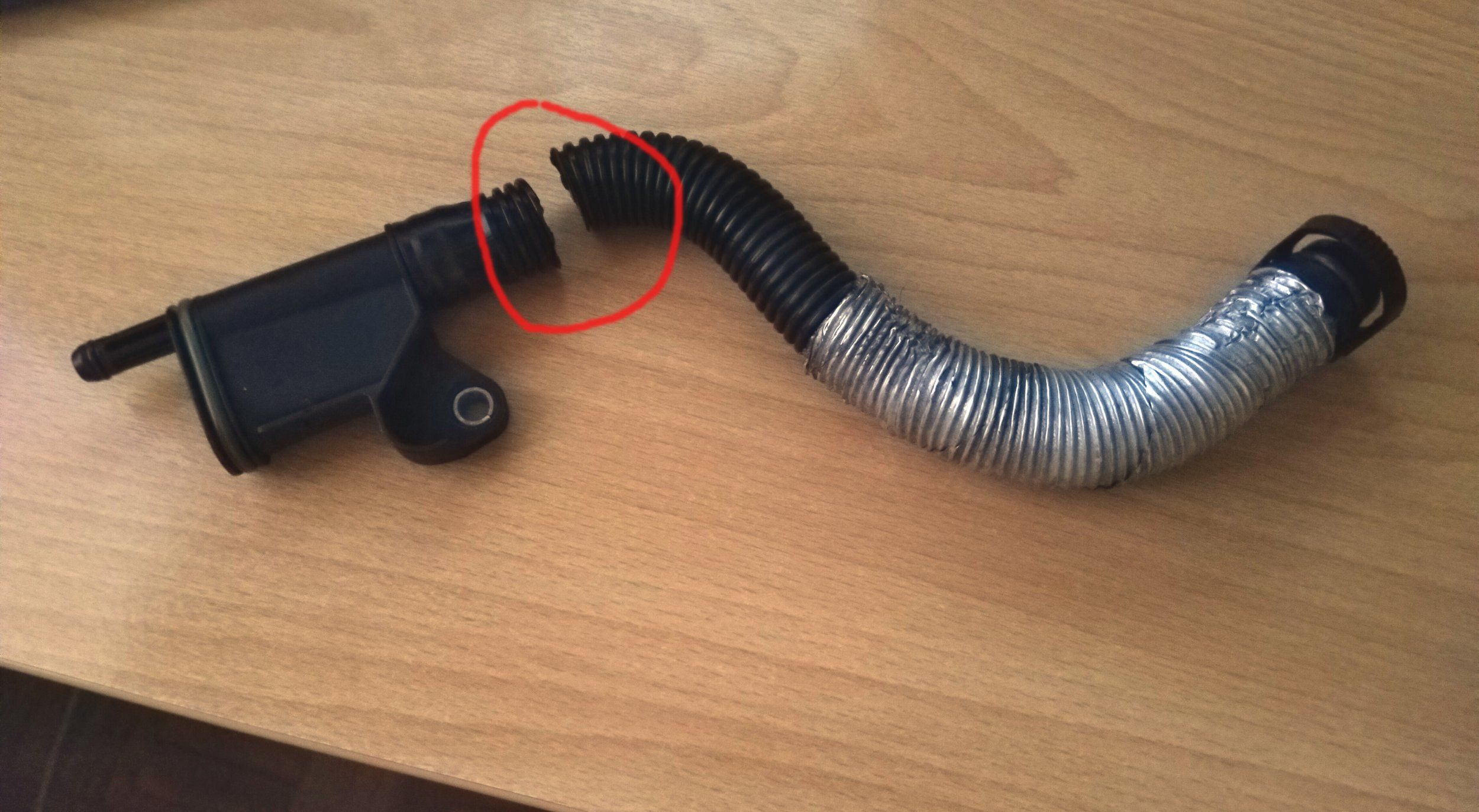

Not sure if this helps, but I ended up finding part of the problem on my car. It's a perforated hose that was cracked and very hard to spot. I think the mechanic said it was one of those evap hoses
