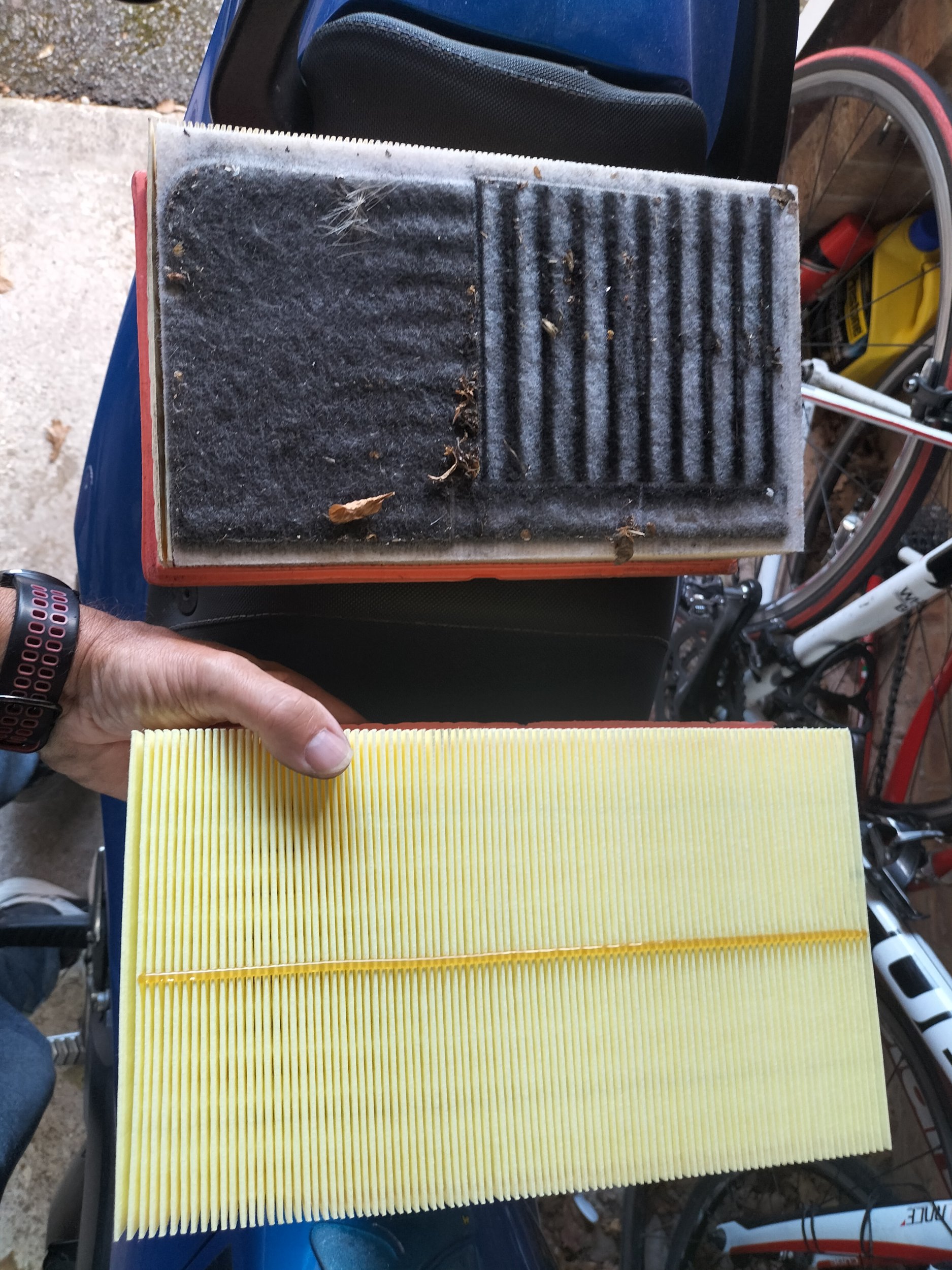

Changed the Oil and Engine Air filters this morning.. definitely needed doing, both dirty!
The old air filter was interesting as it had a very fine (and dirty) additional filter on the input side which surely must have been restricting airflow quite a lot!?

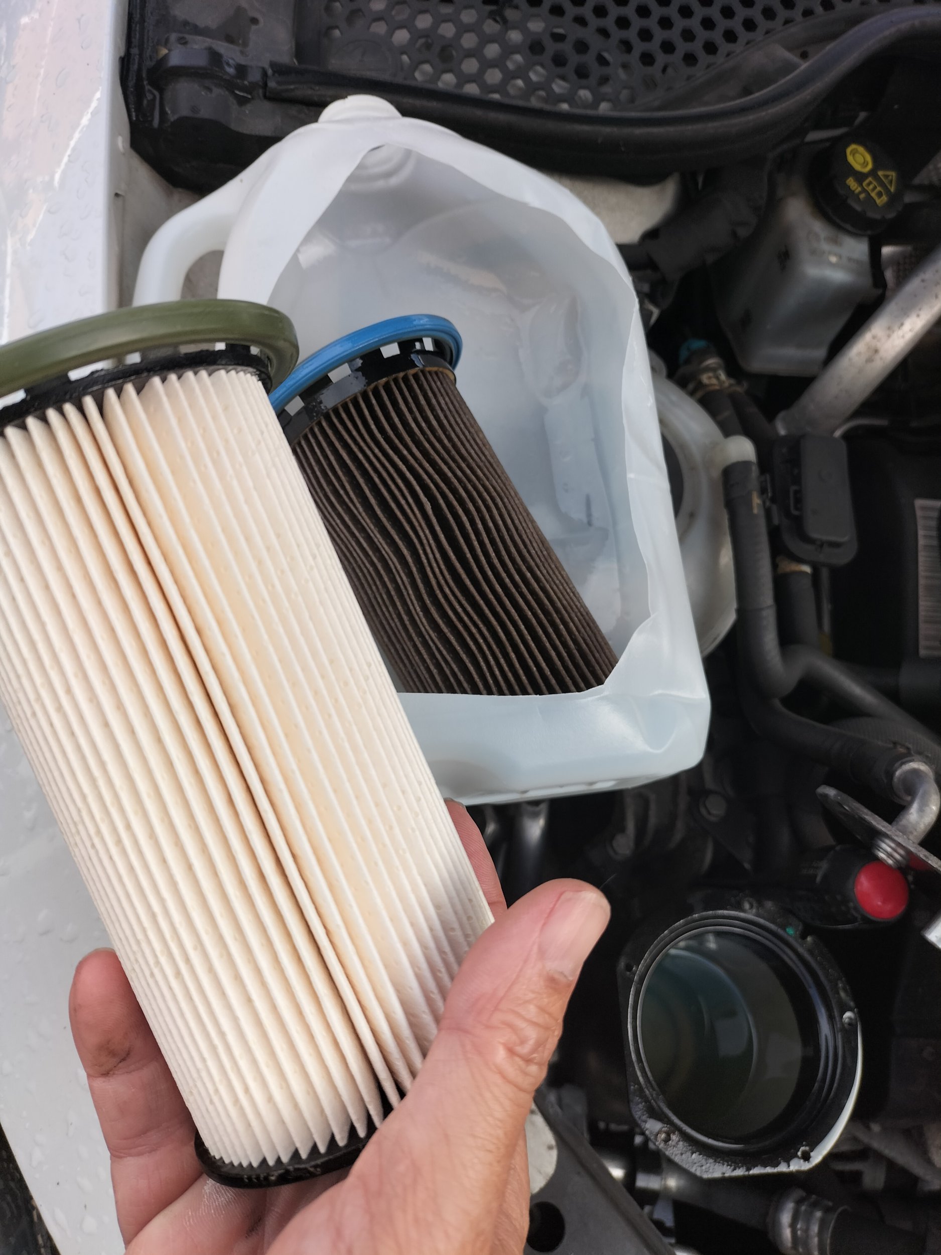

Minor panic when car didn't start at first after the fuel filter change - got some air in which is inevitable I think. Started ok second time!
(Car is currently on about 105k miles if that helps anyone! Not exactly sure when the fuel filter was last done (if ever)).

New vs. Old filter, spot the satisfying difference!

It's a diesel, will check the service interval when I get home. Definitely dirty due to something!
Edit: an internet search suggests for 2.0 TDI engines the fuel filter replacement should be every 40k miles or less.

That's the case with Petrol - but Diesel fuel filters need changing usually 30-40k miles.
Reactions: serdar_18fr
Yes of course, but diesel never had a place in my car world so I could never get used to the fact that people could be talking about diesel, not petrol 😄
