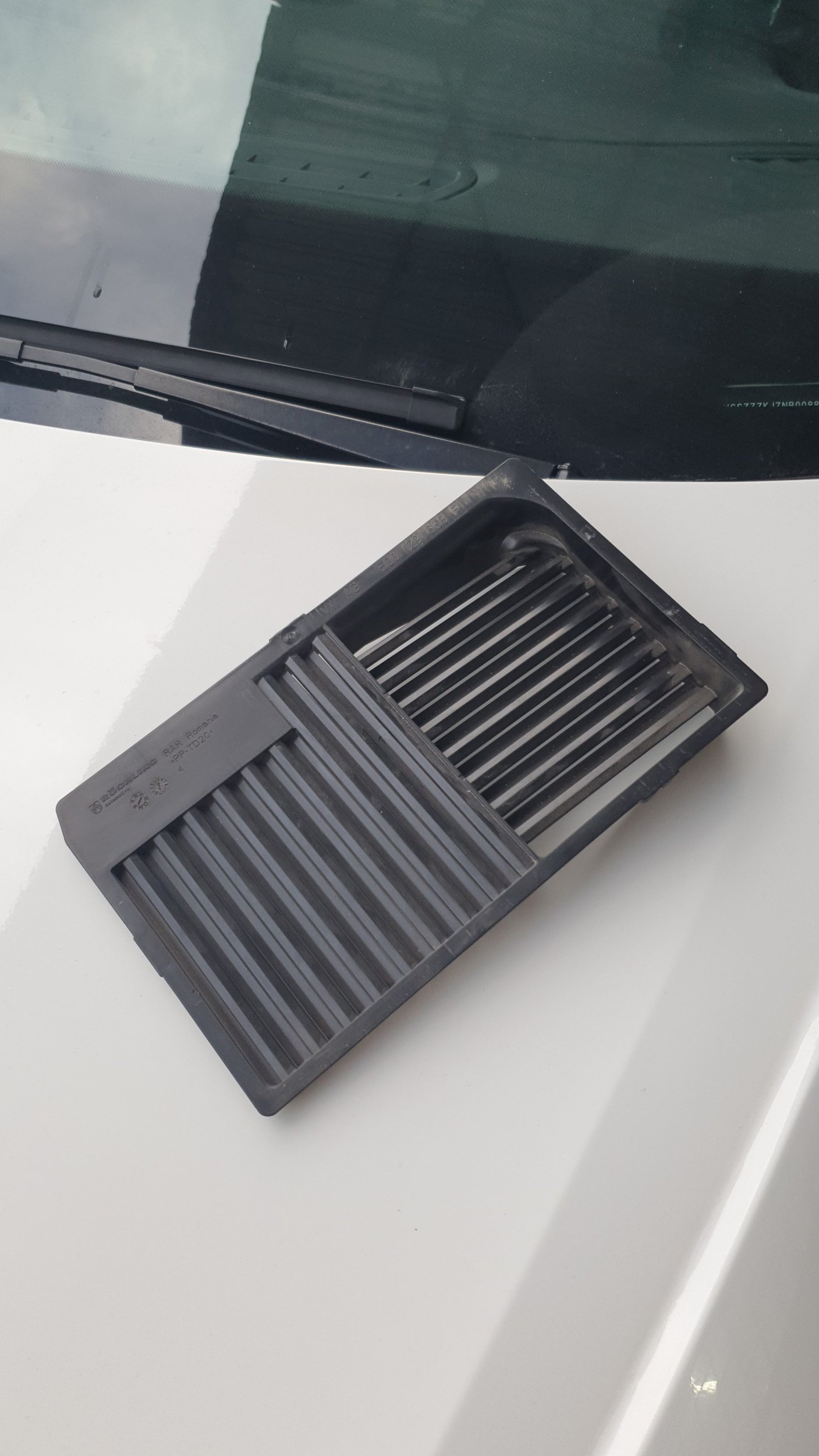

My car: | 41AC676 | 2021 Seat Ibiza 1.0 EcoTSI DSG (engine code DLAA, 110 HP / 200 Nm, DQ200 gearbox).
After removing the hood insulation, I wanted to hear more engine sound.
For this reason, I removed the grid-like plastic piece inside the airbox (part number: 5Q0129668F), which sits before the air filter and directs the airflow.

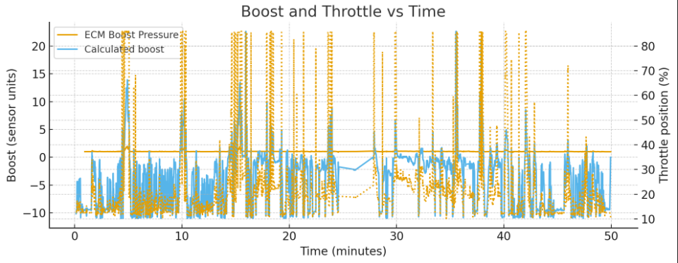

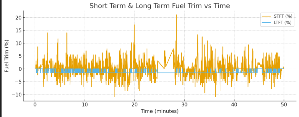

Test conditions:​
  • City driving in Istanbul (traffic, stop&go) + some light aggressive throttle.
  • OBD parameters monitored:
    • STFT (Short Term Fuel Trim)
    • LTFT (Long Term Fuel Trim)
    • IAT (Intake Air Temperature)
    • Boost & Throttle
    • Coolant temp

  • STFT mostly ±0–3%, with short spikes up to +10–20% → pretty normal.
  • LTFT steady between −2 and −0.8% → healthy long-term adaptation.
  • IAT ambient 21 °C, but stayed 40–48 °C in traffic → normal, but could rise more in summer. (Even though it looks healthy now, the vehicle is reaching these temperatures due to its own engine bay structure and it also shows that there is still some room for improvement for me. In the future, I will also make improvements related to the airflow or the intercooler.)
  • Coolant average 93 °C → normal.
  • Sound: Slightly more intake hiss and turbo whoosh noticeable inside the cabin.
  • Performance / fuel economy: No measurable difference, fuel consumption remained the same.

  • Removing this part did not negatively affect engine health; trims and temps remain within normal healthy range.
  • Only NVH changed: intake sound is sportier, which some may like.
