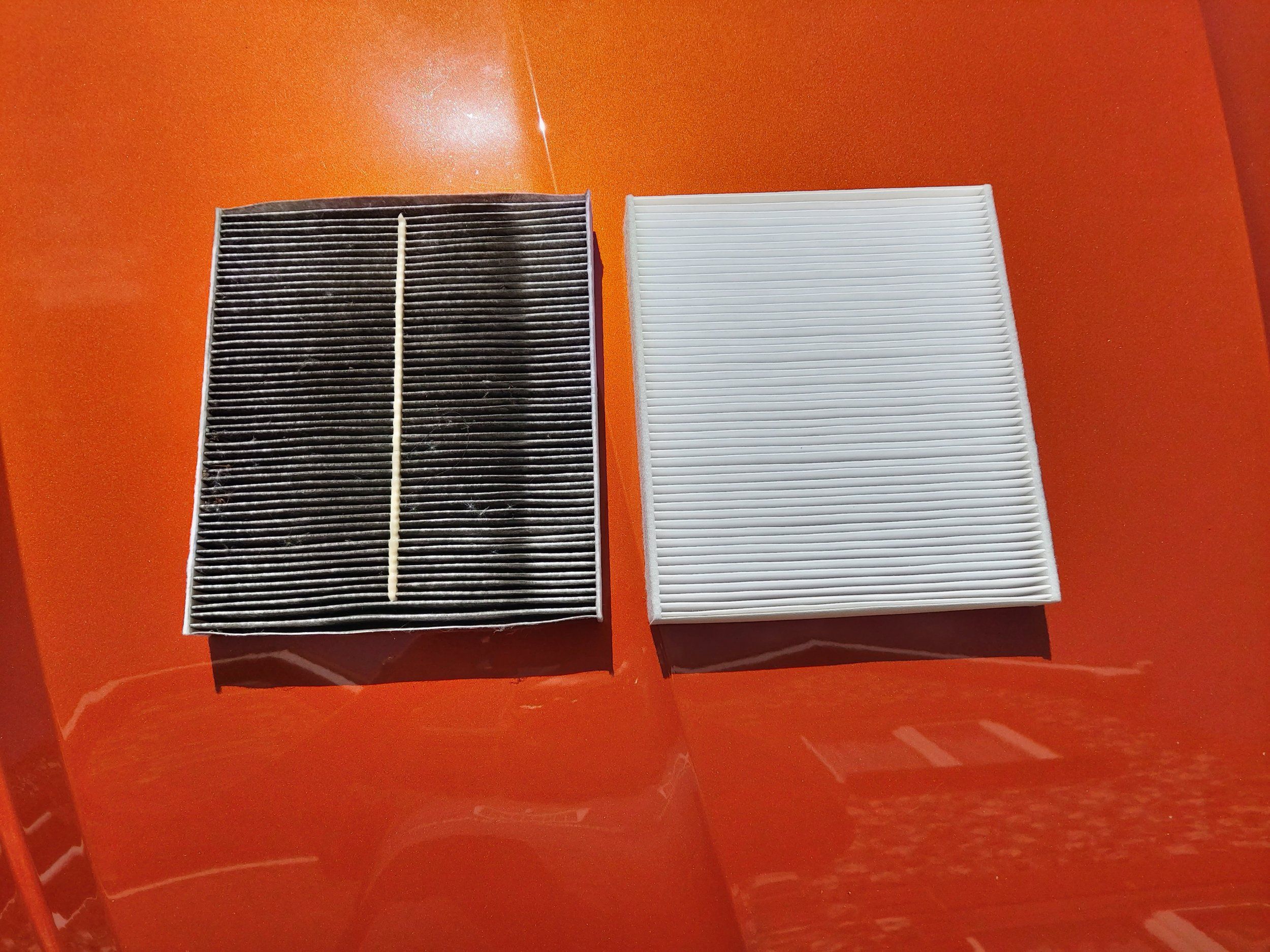

I inspected the cabin pollen filter that lives behind the glovebox in the 2019 Ibiza. I was very surprised at just how blackened and filthy dirty it was. I think I will replace at 3 years from now on.
I replaced the original Mahle LA816/3 with a Bosch M5135 although I could have used a MANN CU26021. The image below shows the new and old filters. The old filter was originally white.

You could be right actually. The non carbon (activated charcoal) Mahle filter is I believe pn LA816/3 and the carbon one pn LAK859. I cant recheck as I have binned the original. The carbon filters are light grey in appearance.
It's still very dirty though you can see blackness which I'm presuming diesel soot. You can see dead flying insects as well if you zoom in.
