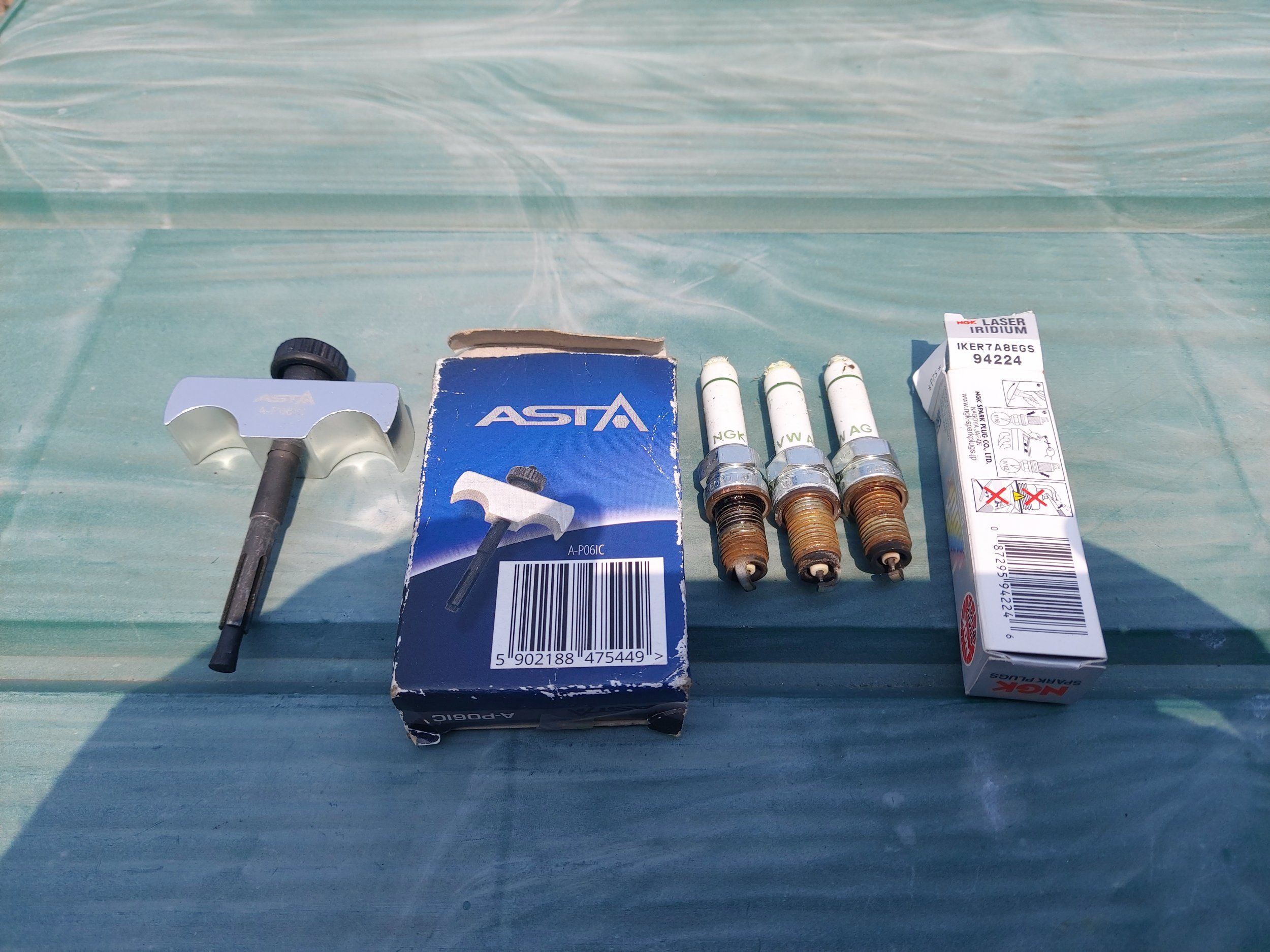

The Ibiza is coming up to 6 years old and 22k miles and I reckoned it was time for another air filter change and a first spark plug change ! The car is a 2019 1.0 tsi 110hp 6 speed.
The 3 new plugs supplied by ECP were NGK IKER7A8EGS pn 94224. Do not get them mixed up with ILKER7A8EGS which are the long nosed versions for the 1.5tsi.
The reason for posting this thread is to highlight the fact that the original plugs from the factory had corroded (the steel plug threaded noses had rusted) in place and were very difficult to remove. I have never experienced this before and had to use a torque wrench as a lever and more force than I felt comfortable with. The new plugs went in OK with a drop of engine oil on the thread and torqued to 20Nm and a little nip.
The upside is my coil pack removal tool an Asta A-P061C was really useful. Below is an image of the rusty old spark plugs, new spark plug box and coil pack removal tool :
I belive thats normal on a turbo engine. When I changed the plugs on my Saab turbo back in the day I thought the plugs would snap when I tried loosen them
Update on this situation. The brown deposit on the plug threads can be removed with a wire brush to reveal clean gold coloured threads. So the brown deposit is not rust as I originally thought. Some YT clips state that it is a charred heat resistant anti seize compound put on in the factory.
The official plug torque is 22Nm but NGK suggest an angular method hence my 20Nm plus a nip. Also the top of the plugs and seal have some silica based gel on them. I am tempted to put a bit of copper grease on the thread next time after this experience !

Direct from the horses/NGK's mouth! - do not use anti-seize or lubricant on the spark plug threads:
Oiling a thread reduces the torque required to achieve a certain preload - Oil can increase the preload by 25% (some debate on this figure with ranges from 10 - 40%) so your oiled 20Nm + nip could be getting on for 30+Nm equivalent for a dry plug.
