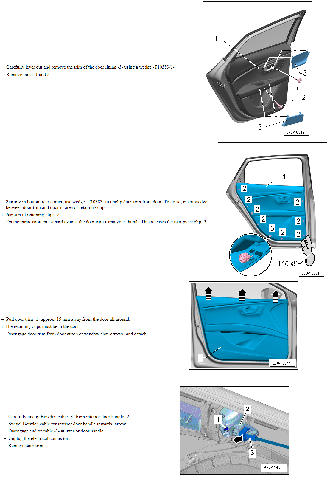

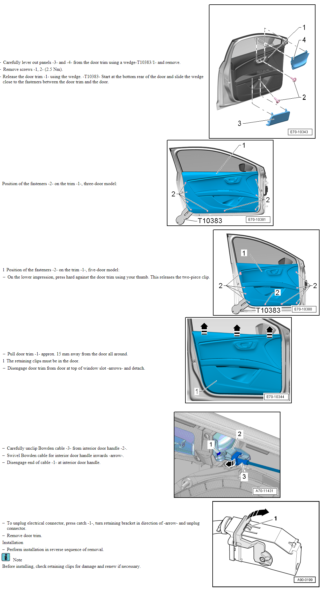

Here are pics for removing front and rear door trim
Thank you for this post - a very useful post - will be very helpful to me as want to have a go at additional soundproofing.
Any more instructive diagrams like this would make a good sticky post.

Where can you get the tool from?
