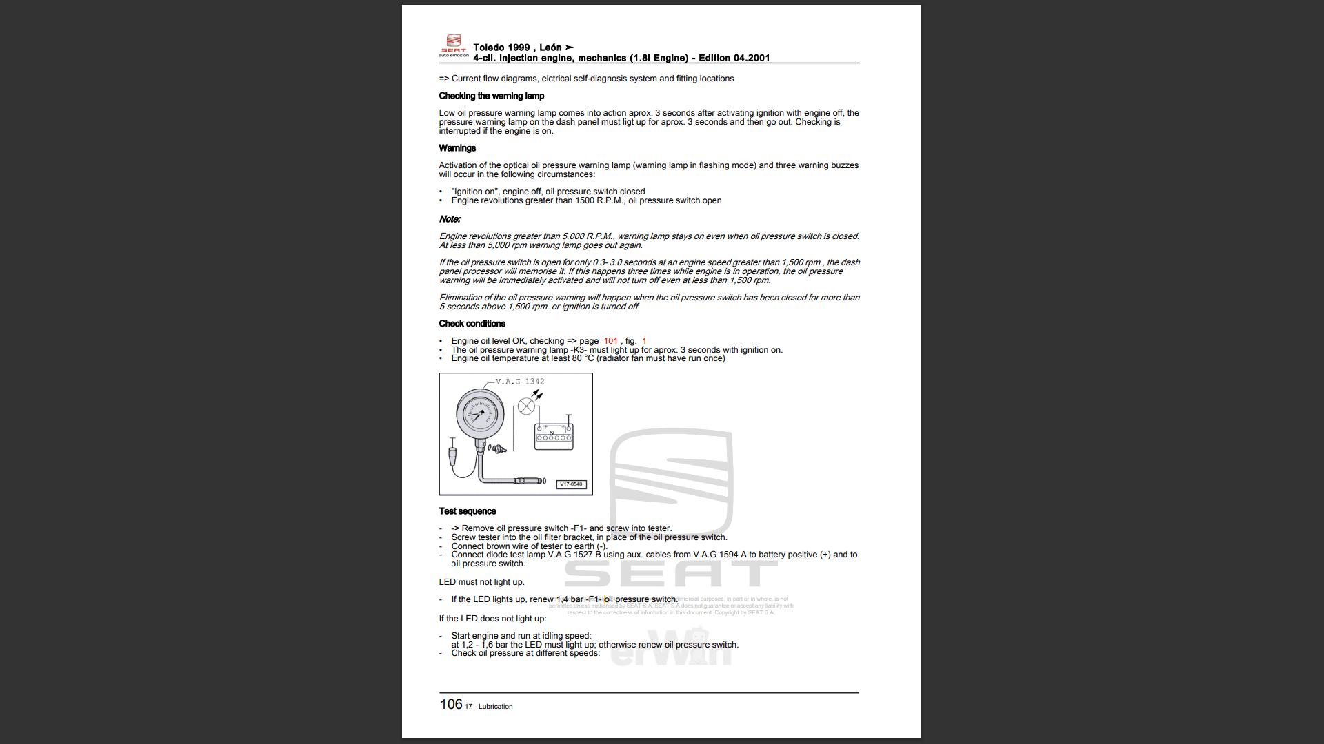

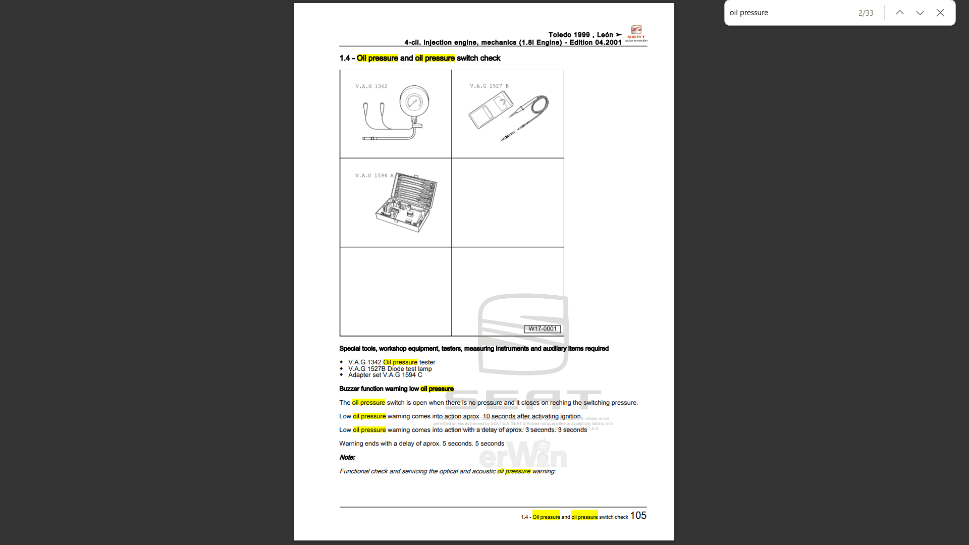

I have another question, I replaced the oil pump, filter, cleaned the oil pan, cleaned the clogged oil pickup tube, but the oil light comes on again after 2 days. And I changed the oil filter again and cleaned the oil pickup tube again, after I changed the oil pressure sensor and the oil light is flashing again, im using full synthetic 10w40 oil. Why oil light comes again after i do everything possible to oil system. İ changed everyting.
I'm really not sure on that one mate. It sounds like you have changed everything that you can. Maybe there is an electrical problem that is causing the oil pressure reading not to get to the instrument cluster. Maybe try checking that the plug for the oil pressure sensor is ok, and there isn't any corrosion or broken wires inside the connector. Also check the wiring between the switch and the instument cluster, and that you also have a good ground/earth as well.

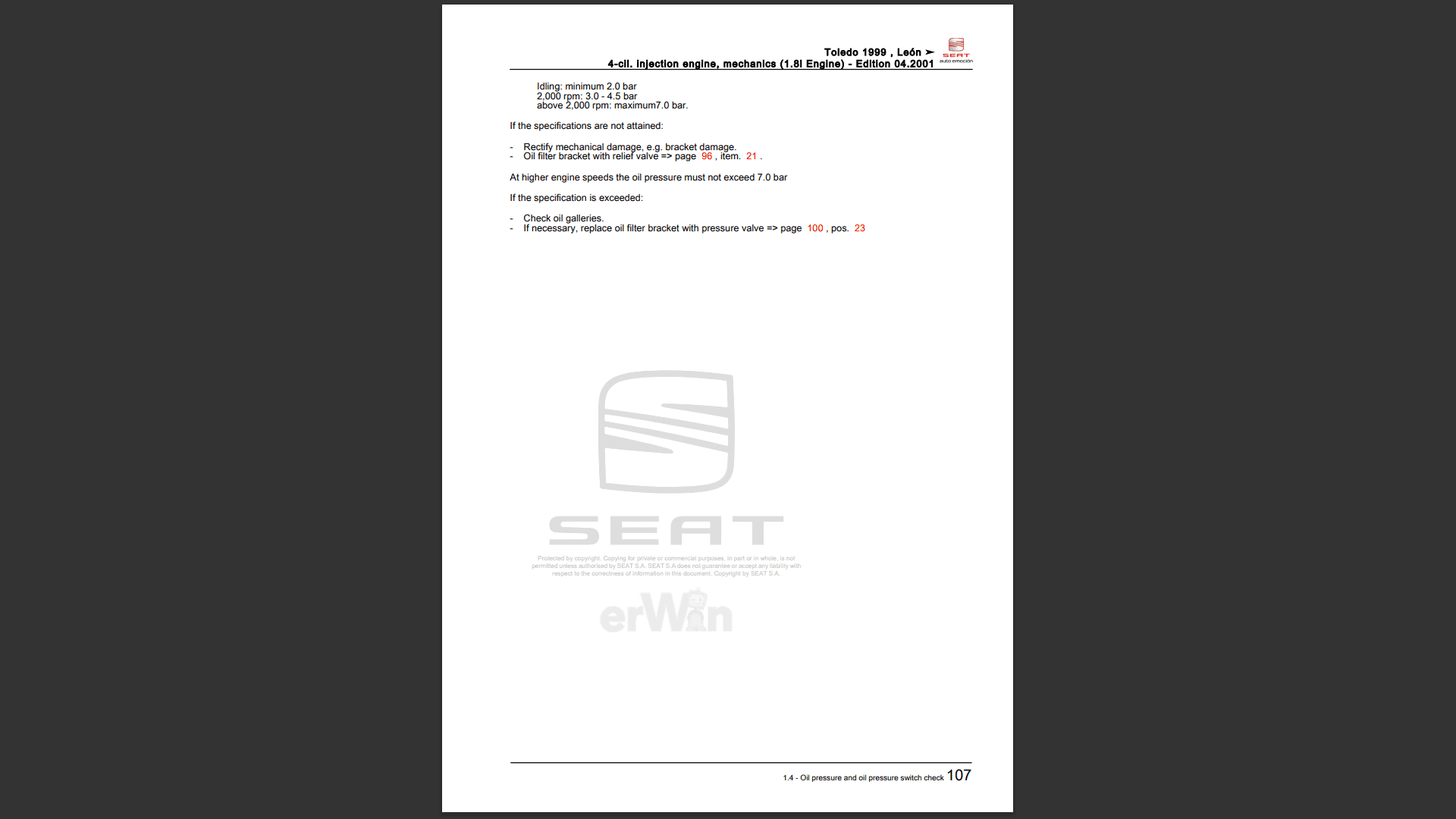

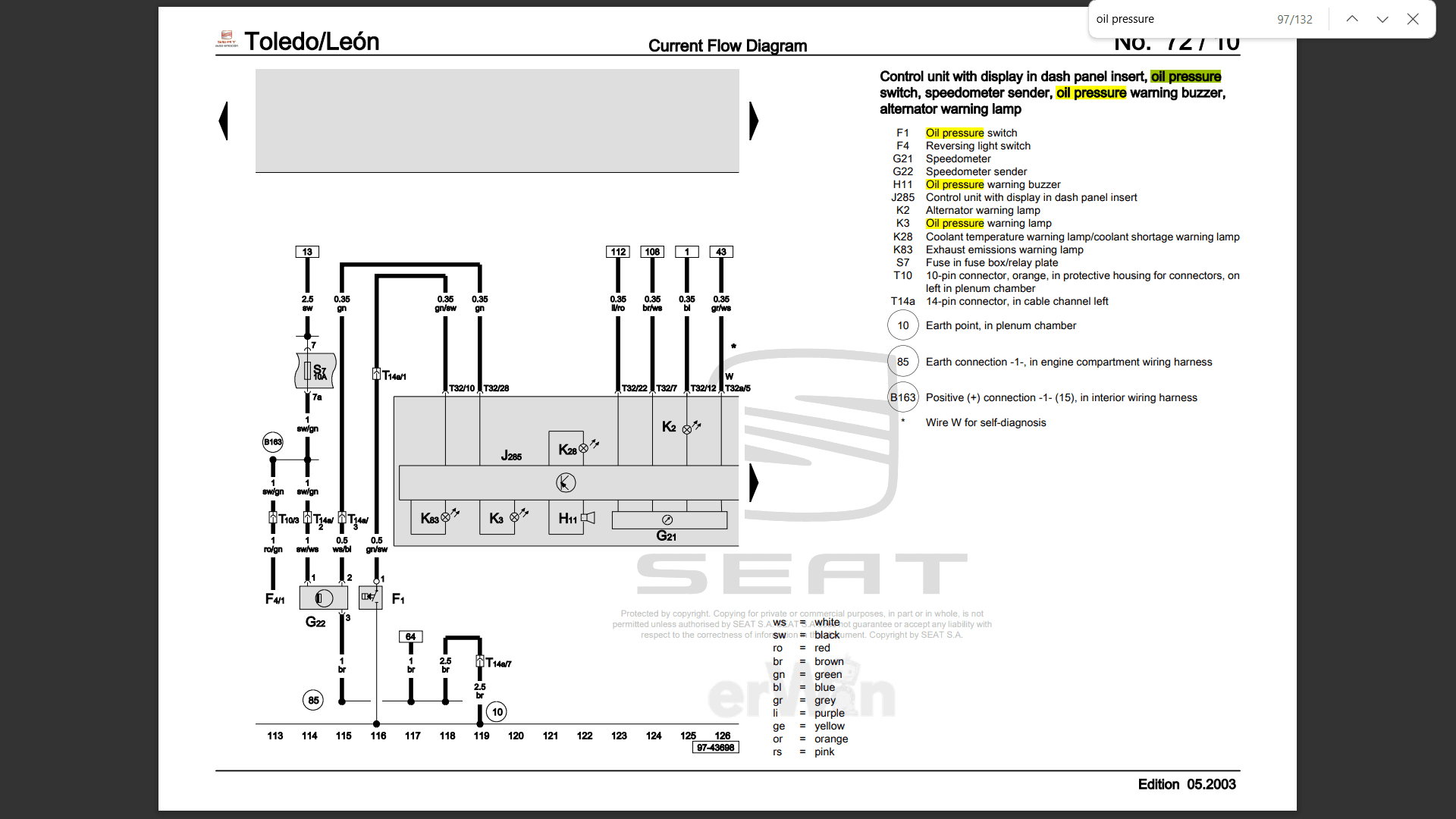

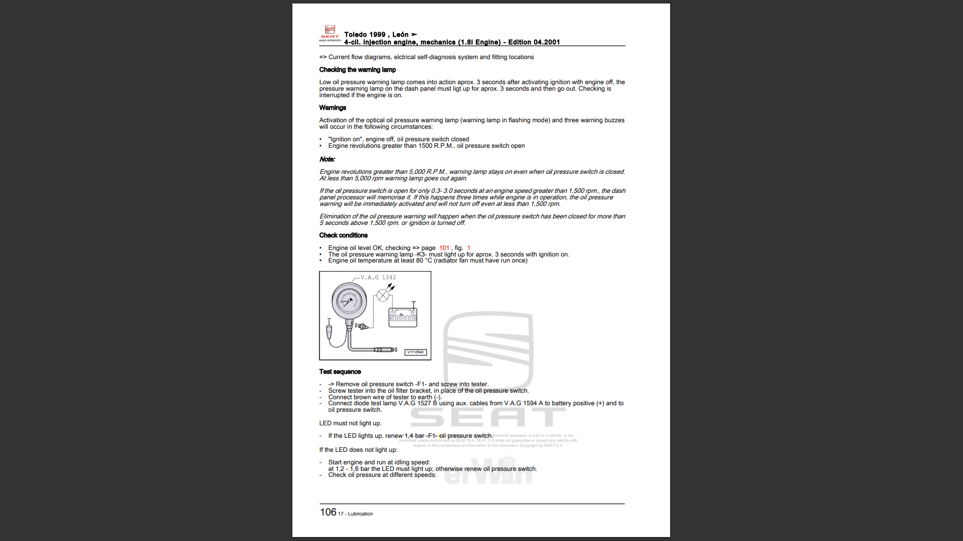

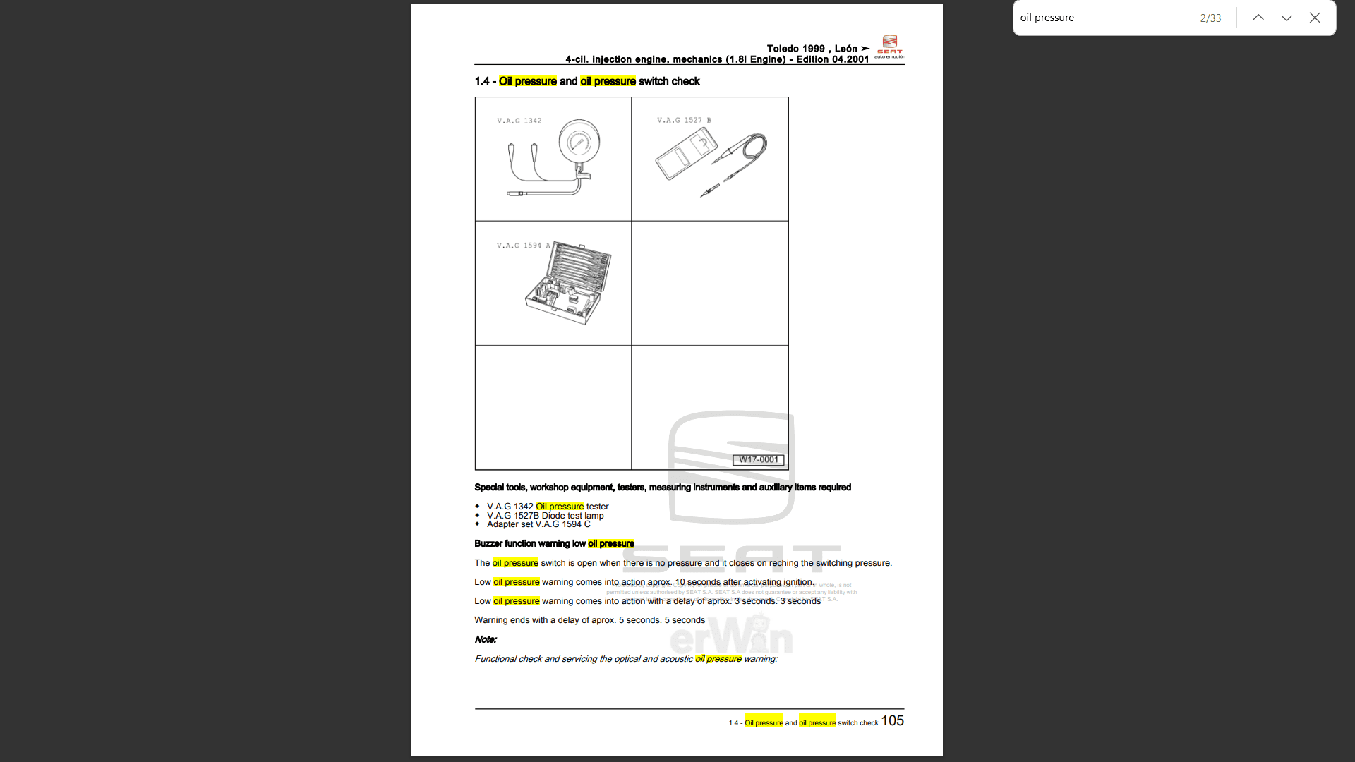

Bro if i put the oil pressure timer in same path (like turbo timer) it will be efficient? Without changing any system. Or what will i do? What can i add to give efficient + i dont have any electrical issues and plugs are okay and cables are not broken and dont have any corrosions but cables are bit deformed but cable inputs are good
View attachment 43344View attachment 43345View attachment 43346
After last opening the oil pickup tube was filled with oil sludge and plastics again.
@mty12345 what can i do can you give answer about this?
