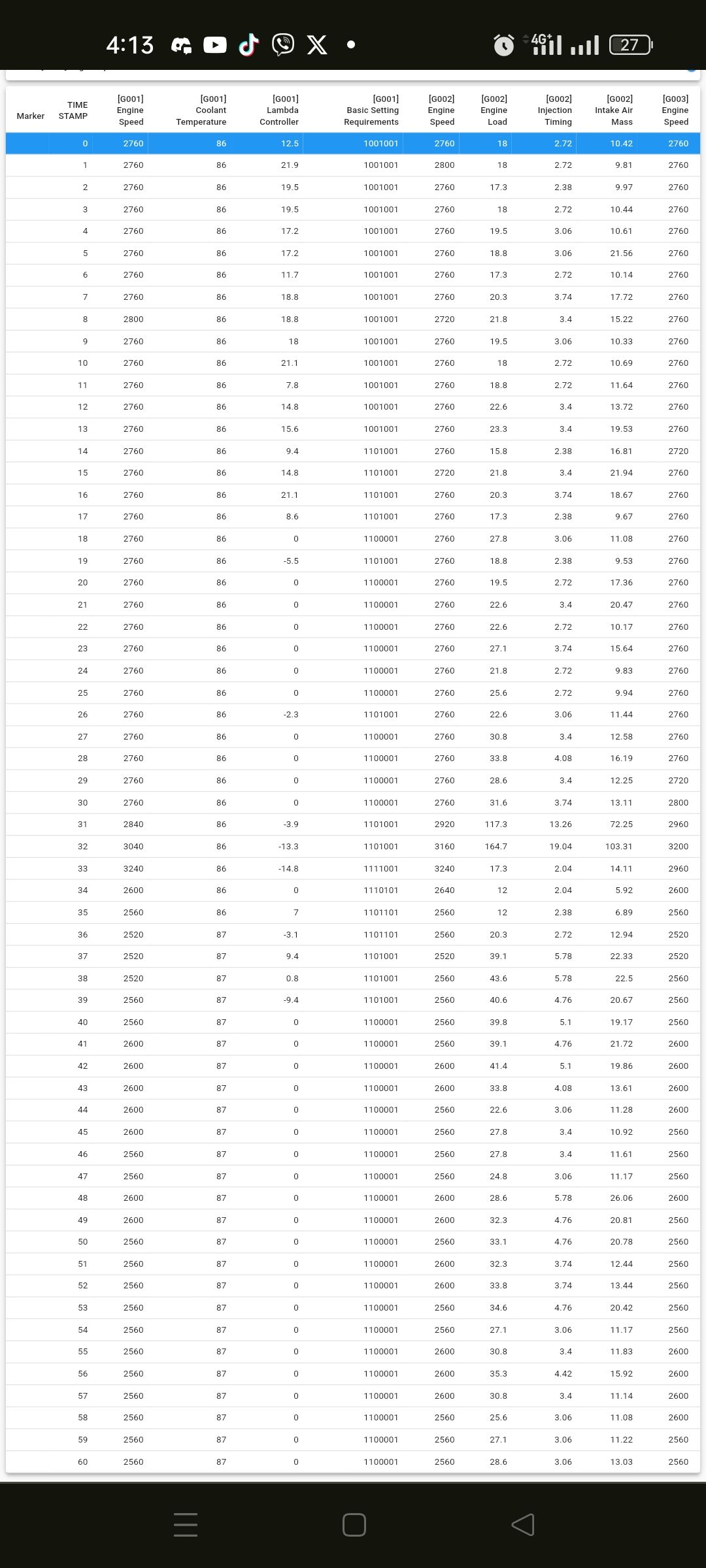

Hello I have Leon fr auq engine 20vt 133000km the car has miss fire on idle till 2700-3000 RMP not at WOT pressure 1.35 over somethimes boost come and go . is stage one Revo from factory I do bypass n249 (n249 is connected hoses and plugs) and close EGR from Sai because Sai motor is broken . The has missfire we see the program at 3 shops and the engine compression leak test etc at 3 shops

All cylinders at WOT go pretty well but the car has Revo at vcds torque is 39kg and max at pull is 25kg is ok this? Compression is perfect.otor has only 130000km same compression all cylinders yesterday with the new oxygen sensor 1st (,3weeks old ) I have code low performance of heater etc and didn't read at vcds today works ok the oxygen sensor it's crazy those things at full throttle I don't have missfire. I have new maf and map Bosch
