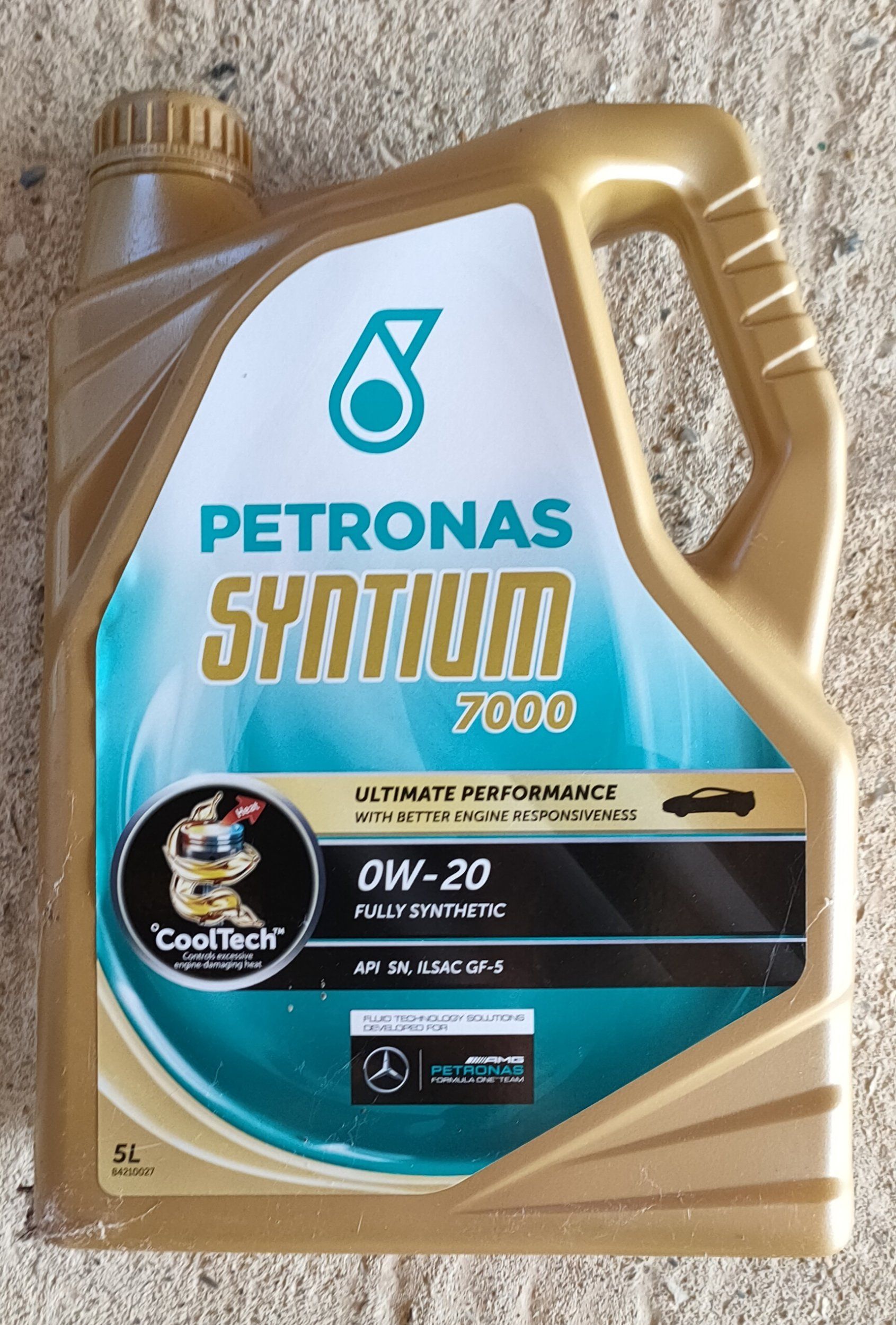

I've just noticed that my engine oil level could do with topping up but I seem to have misplaced my handbook. So I was just wondering what engine oil I should buy? I have however got some 0W20 fully synthetic oil left over from my previous car and I was just wondering If this oil would be suitable and safe to top up my oil level?

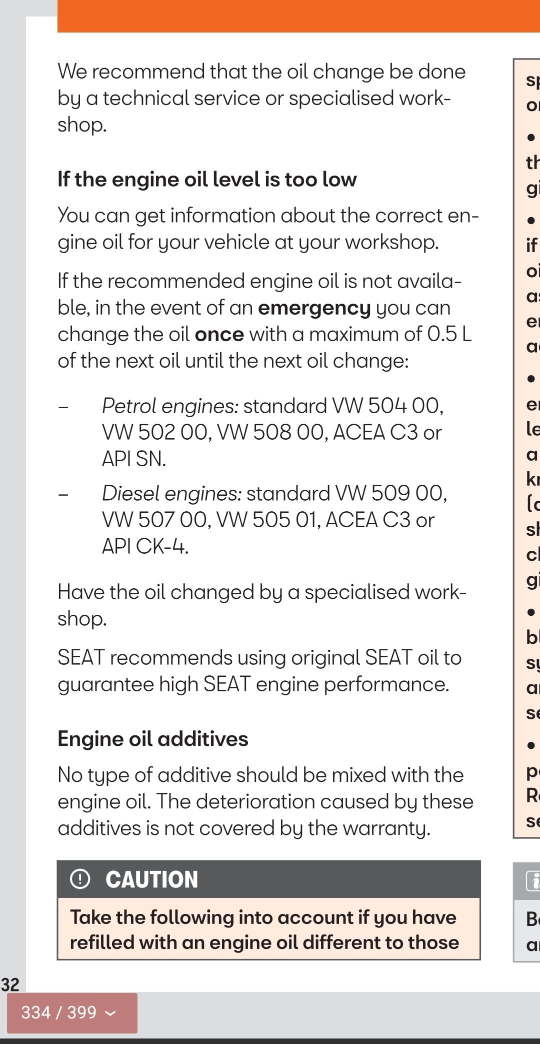

@motormadmarc - The oil should also meet VW’s specification. Sorry, don’t know what the VW oil spec is for the current VAG 1.0 TSI engine in the mk4 Leon.
If you’ve misplaced your handbook, you can access the online version on the Seat website - either downloading the entire manual or accessing just the content for a specific category (e.g. safety, maintenance, operation etc.).

VW 504 00, VW 502 00, VW 508 00, ACEA C3 or API SN
They are all VW oil spec standards, but are they all suitable for a 1.0 TSI petrol engine with a GPF? - e.g.
  • VW 502.00 is for petrol engines without a particulate filter and presumably a 2020 1.0 Leon will have a GPF.
  • I think that oil meeting VW 508.00 standard isn’t backwards compatible, which presumably means it can’t be mixed with oils with an earlier / older VW spec standard.

The manual is a joke, the specifications given are for 'emergency' use of 0.5L, otherwise you must contact your workshop?

Thanks for all the replies guys. I've phoned up a couple of main dealers this morning and they both gave the same Info. This Is the answer that I got from the last main dealer that I spoke to :
"The oil you need is a 0W20 (VW508.00 specification) something like Castrol, Shell or similar standard".
