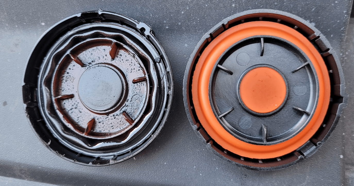

I've just today changed my PCV so hopefully that with a change of oil should sort the situation. As you can see the old one below was pretty distorted
So the PCV you ordered off eBay fit ok ?

The eBay PCV fitted fine. The link I used was
This was for the injector O rings and washer. Should be noted the end washer seemed a little thicker than the one that came out on the injector, however I can't say whether it's because it had been flattened when tightened up
The PCV part was
I bought some injector seat seals however the old ones looked in such decent condition I left them as is
I took it out for a drive and it's been ok so far. That was only half hour or so drives though
The PCV part was
Cheers mate .
Think ill do my PCV shortly when i do my oil change ive no oil residue in the pipework so ill be it as preventative maintenance.
