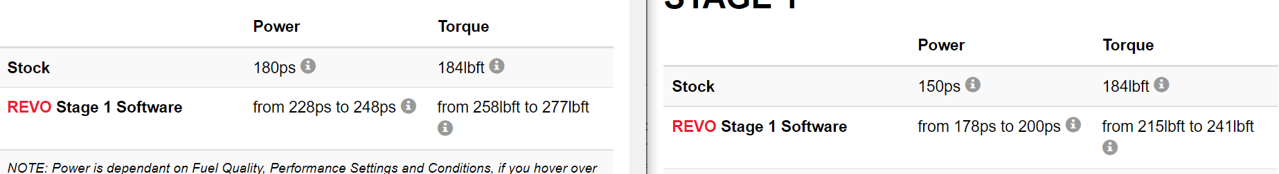

Looking at REVO example below they quote slightly higher power & torque for the 1.8.
