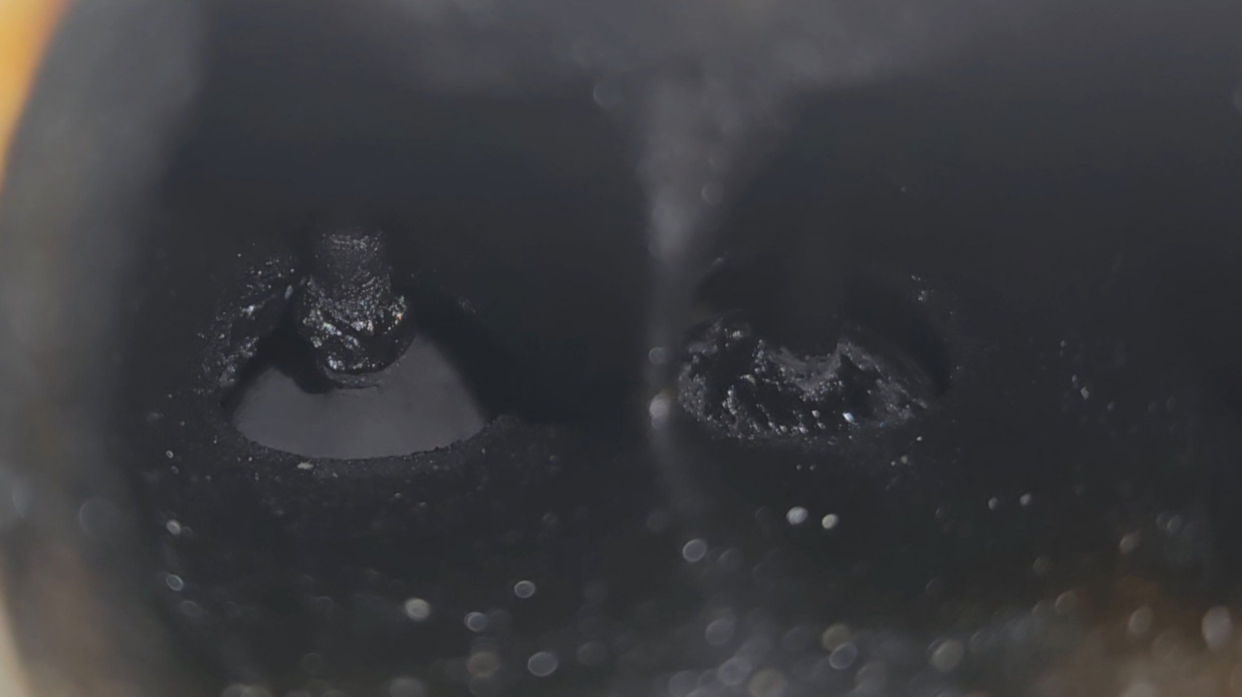

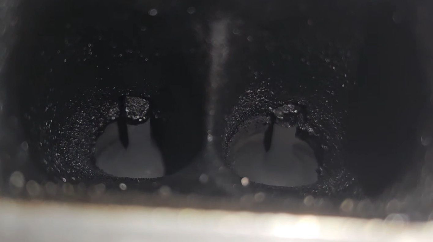

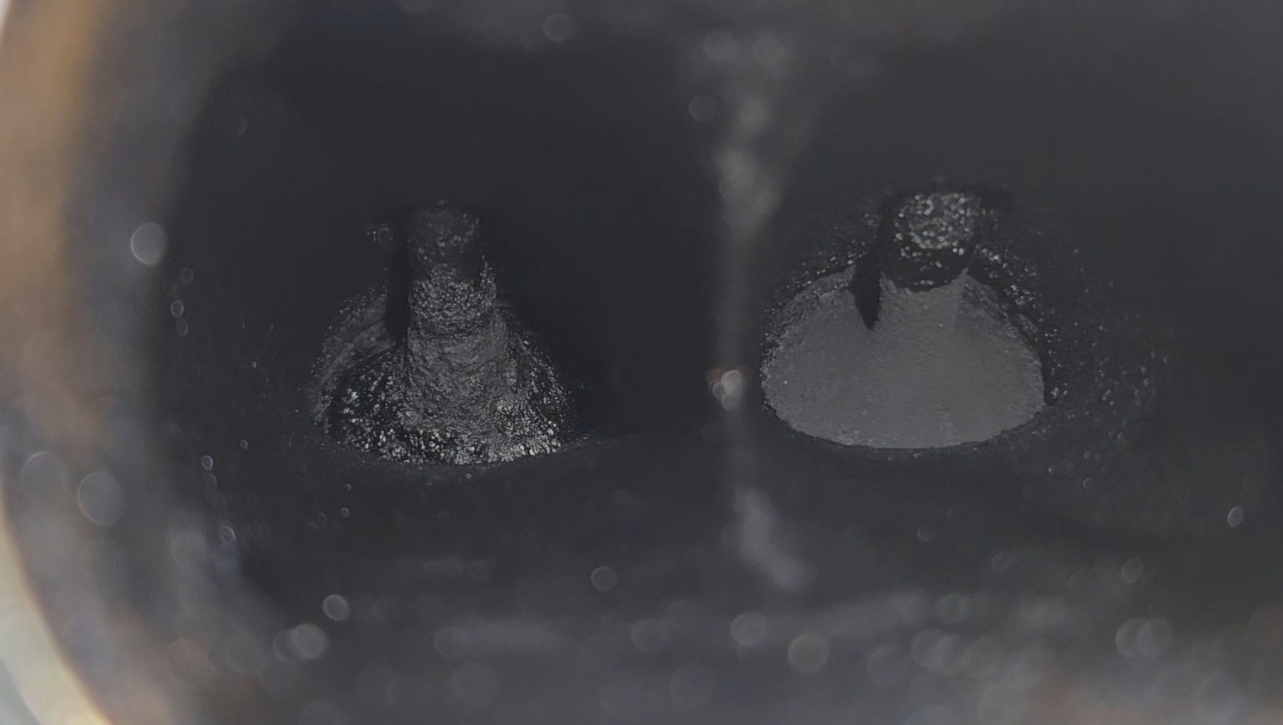

I decided to pop the intake off and take a look at the intake valves. I think they may need a bit of a clean up but I'm not totally convinced its causing the issue.

Cyl 1
Cyl 2
Cyl 3
