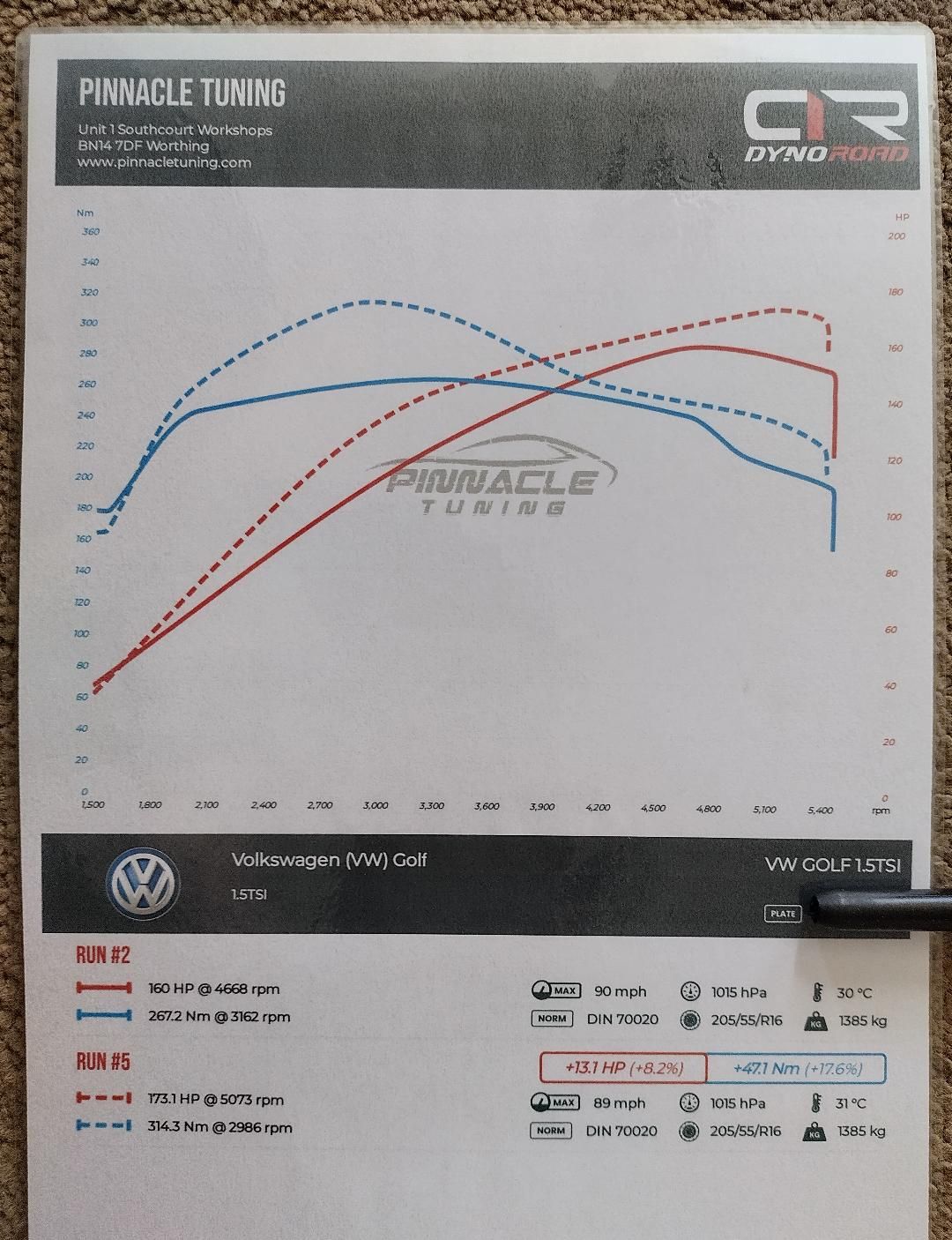

I'm raising this thread from the year-dead as there have been some recent developments with my 1.5 TSI,
(150 EVO, code DADA) Golf that may be of interest to others on here with SEATs using the same engine.
A quick recap to save people searching, my late 2019 Golf had a mild case of hesitation from new, the dealer
applying the official VW 'fix/update' without argument when the car was about 6 weeks old after I had raised
the issue.
This update did go a long way to reducing the problem and the engine felt livelier/more responsive, but it's
running for a few seconds after a cold start was still not brilliant.
Since then, the car has behaved itself and returned impressive average economy figures, but it's 3rd birthday
is looming and I wanted to get it a 'Stage 1' remap - to be done at the same time as insurance renewal that
was due earlier this month for convenience.
Eventually I chose a small outfit near to where I live on the South Coast that have upto-date equipment and
a good rep AFAIK.
The car is stock standard apart from a modest Golf GTE-style airbox mod and snow grate removal - and of
course the 'VW fix' remap mentioned earlier.
The tuner requested a tank full of 97-99 octane fuel, (I went with ethanol-free Esso Supreme) and although it
was a hot day, (31 deg. C) the engine was quoted as producing 160 HP, (119 KW) and 196 lb/ft ,(267 Nm) - an
increase of around 8% from VW quoted figures for a DADA of 148 HP/184 lb/ft. This post is getting long, so
the next will reveal the results of 'after'...

We had discussed what sort of remap I was looking for, I said that I wasn't too bothered about fuel
economy, nor extracting every last HP at the top end - but did want the 'peaks' of max. power and
max torque to be as far apart as possible.
My thinking was to achieve the broadest spread of power which always works well and so is satisfying
to drive on a road car IME - effectively I was asking for a middle-ground 'blended' remap, between the
usual maximum economy and the max power remap options.
The 'before' 160 HP & 196 lb/ft Test Run had a range spread of 1506 RPM - the remap produced
figures of 173 HP, (128 KW) & 231 lb/ft, (314 Nm) - with a range increase of over 38% to 2087 RPM
between these peak values. Which is nice.
The figures themselves may look unremarkable taken at face value, but the effect of the extra 47 Nm
of torque in particular is very noticeable, along with the smoother running and, (so-far) curing of the
cold-start hesitation issue.
I'm still mostly in the 'playing with the extra grunt' phase, so recent economy figures aren't the most
reliable, but it all seems fine so far. I've just returned from a week's holiday upto North Wales and the
car certainly picked-up speed smartly on the motorway when required - really gets going in the 2.5K -
5K rev range as I'd hoped.
A nice little bonus is that the car's 'Performance Monitors' meters have been re-calibrated, (either
automatically or by the tuner?) and are now showing the extra 18 KW being produced at full throttle
- compared to the standard reading of 110 KW it always indicated before when run on 95 unleaded.

Thanks for the acknowledgement - I'll post some more details if anyone's that interested.
Earlier this evening I did my first 2nd gear 'hoon' full-on acceleration. The lower ambient
temperature of 18 deg. C must have helped, as the Performance Monitor 'KW' gauge hit a
'steady' high of 135 KW, (181 HP) - although I'm dubious as to how accurate the gauge is.
In any case, it offers comparison to the highest reading of 110 KW before, (when it was
running on only 95 unleaded) and the car certainly delivers some welcome extra urgency...

From what I've read, VAG consider engine code DPCA to be the proper fix for the DADA,
so little surprise that there isn't an official upgrade for this engine.
I did ask the VW dealer at the time, (early 2020) which TP number was applied, but they
didn't tell me. Pinnacle tuning stated that the car's history indicated an official remap had
been installed - but then I had already informed them about that.
When researching about the remap, I noted some 'leading-name' tuners stating that they
couldn't access the ECU through the OBD port, but Pinnacle confirmed that's how they did
it and that mine wasn't the first DADA they'd done. I suspect there may be some outdated
info out there on other tuner's sites.
My car's before and after print-out with Pinnacle's address details is below - the results
reflecting the high ambient temps of that day.
