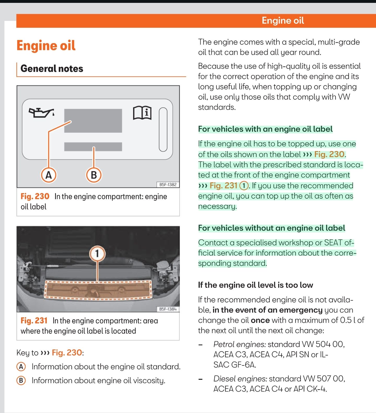

Couldn't you find the physical label in the engine compartment?
The owner's manual also mentioned ".... oil consumption can be up to 0.5 l/1000 km...." - ironically the exact phase used in the owner's manual of my previous Audi (EA888 Gen1) which was 17 years older than my 75-reg (EA211evo2) 😅😅.

Yes, I found the label now ! I might have looked there first but I park alongside a hedge and Seat unhelpfully put the bonnet release on the passenger side. More embarrassingly I also now found the reference to the label in the handbook ! But definitely NOT the actual oil specification, just a reference to the label.

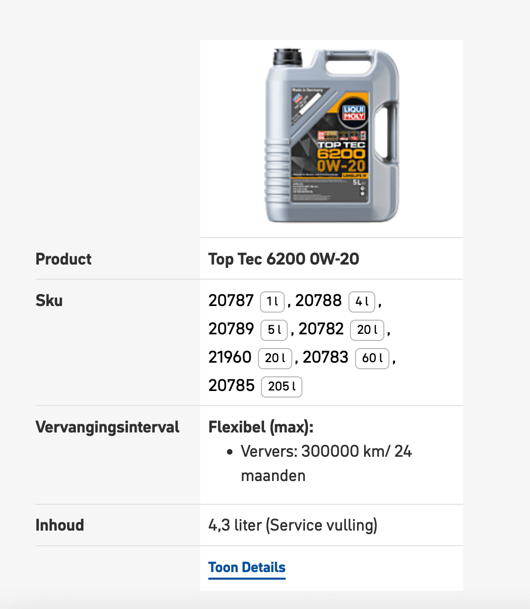

I usually use the oil recommendation feature from a couple oil suppliers like Liquimoly and it also shows 0W20 for your situation
Thr owner's manual nowadays will not tell you the exact oil specification needed, only referring you to check the physical label in the engine compartment.
The manual only tells you what specs you may use during emergency (e.g. up to 0.5l of VW504 if you cannot find VW508).
