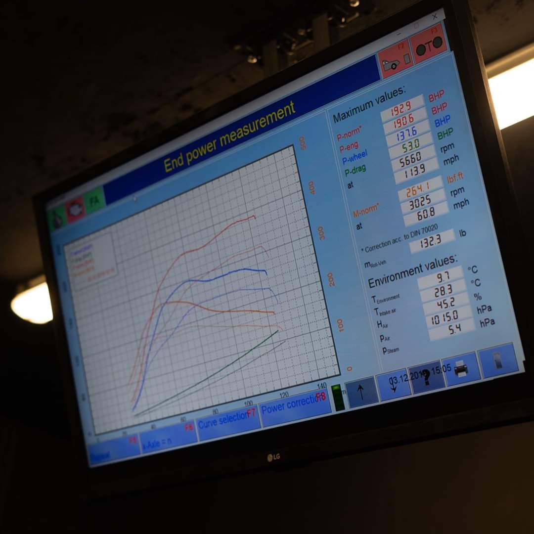

I know it was a while ago but this caught my eye!
The 'guesstimated' engine power is about 40% higher than the measured/calculated wheel power!
That it just not possible - The drivetrain, especially from a new efficient FWD car is not absorbing 53bhp or nearly 40,000watts! of heat!
This is an interesting read:
"If you are starting from a wheel bhp figure then you have to apply those equations in reverse - add 10 bhp then divide by 0.9 for FWD"
So the measured 137.6wheel BHP is more likely 164 engine BHP.
