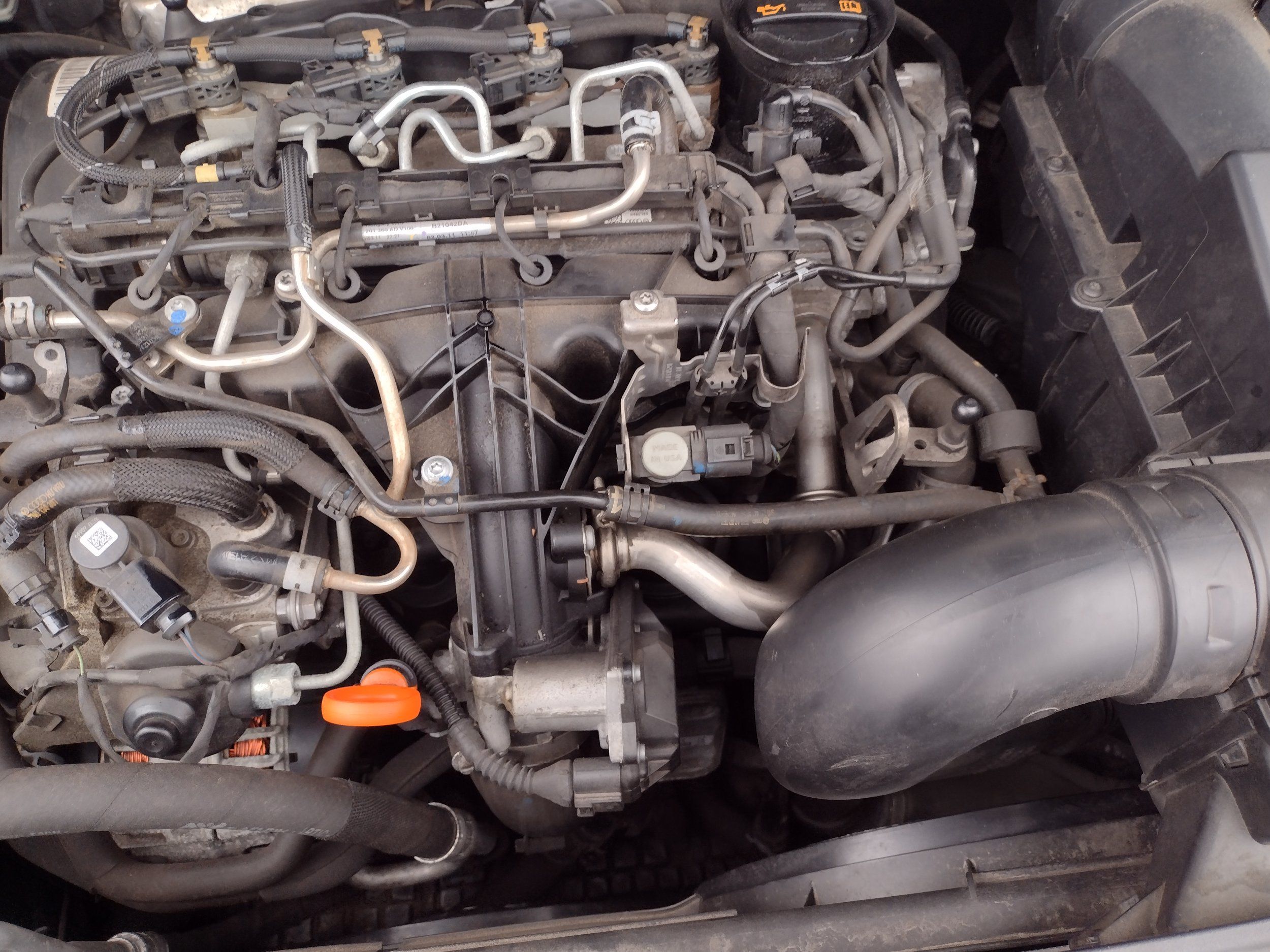

Just incase anyone needs the pics info.

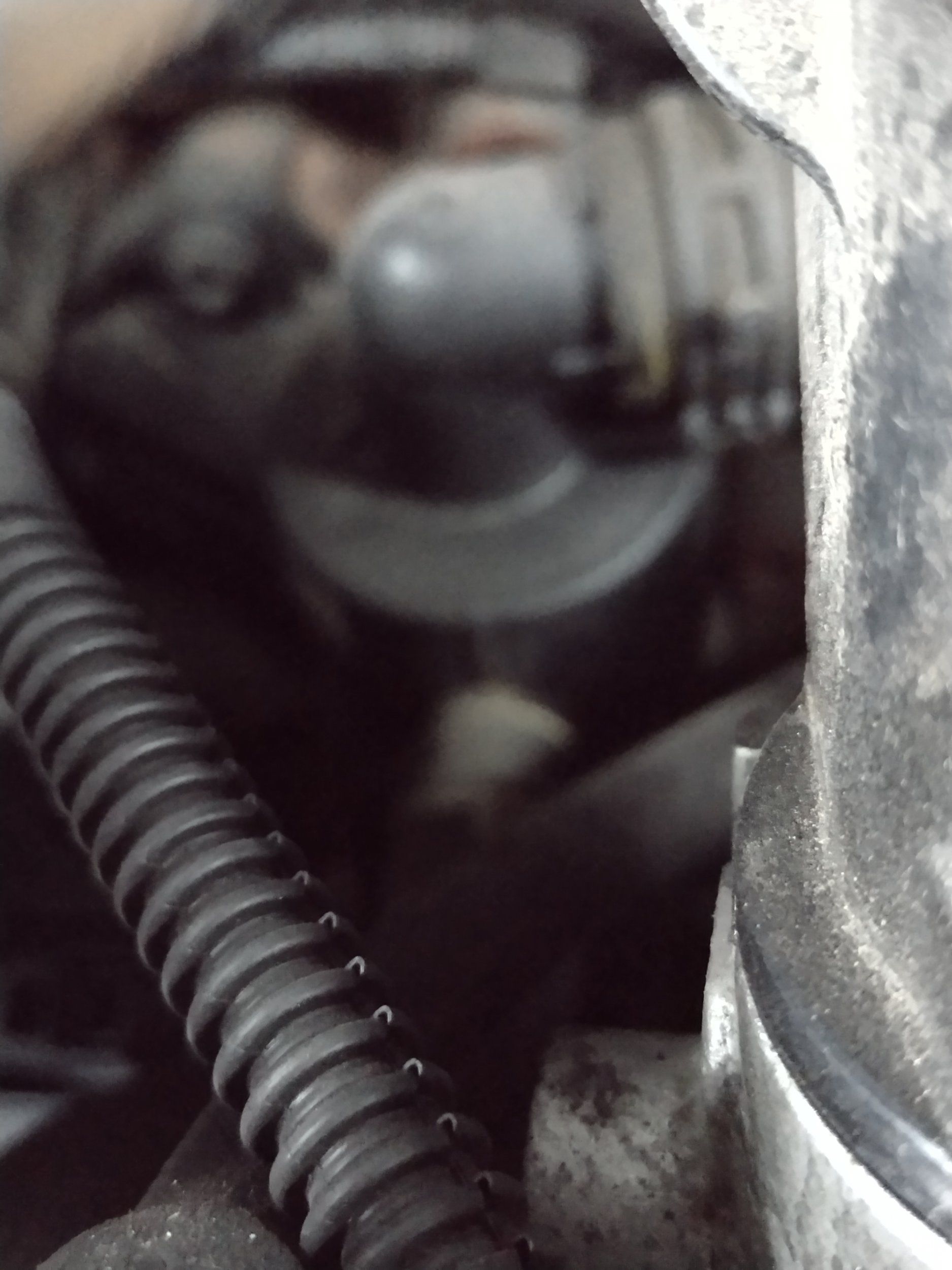

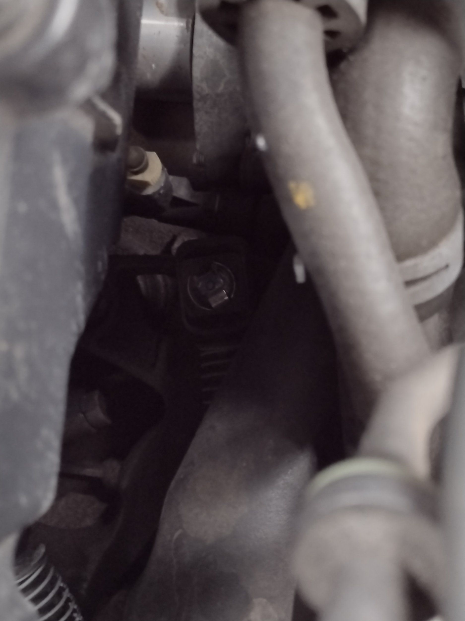

It's located behind the engine, right hand side, under a water pipe.
I had to move large air pipe and remove fuel filter to gain access, I also ended up ordering the wrong sensor!
Was told it should be a 'green 4 pin' but was actually 'grey 2 pin' sensor.
