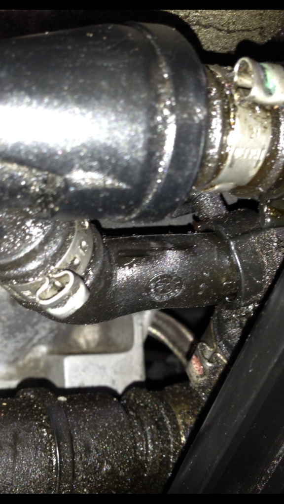

I think that's a boost leak mate, check all pipes around tip dump valve n75 valve and all the pcv system around the rocker and under then inlet manifold, I had the same
problem and it was a tiny split in a pcv pipe under the inlet and it left a spray of oil on the pipes , may just look greasy or dirty but will be a split pipe somewhere maybe, I ripped it all out and fitted a catch can and blanked it off on the tip and vented it to atmosphere , hope this helps
