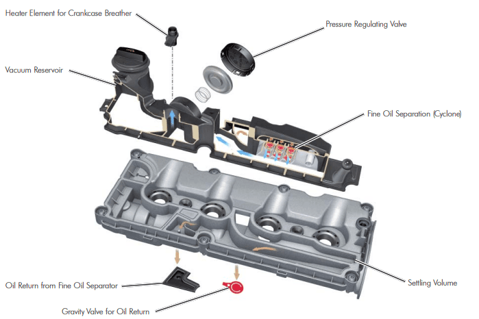

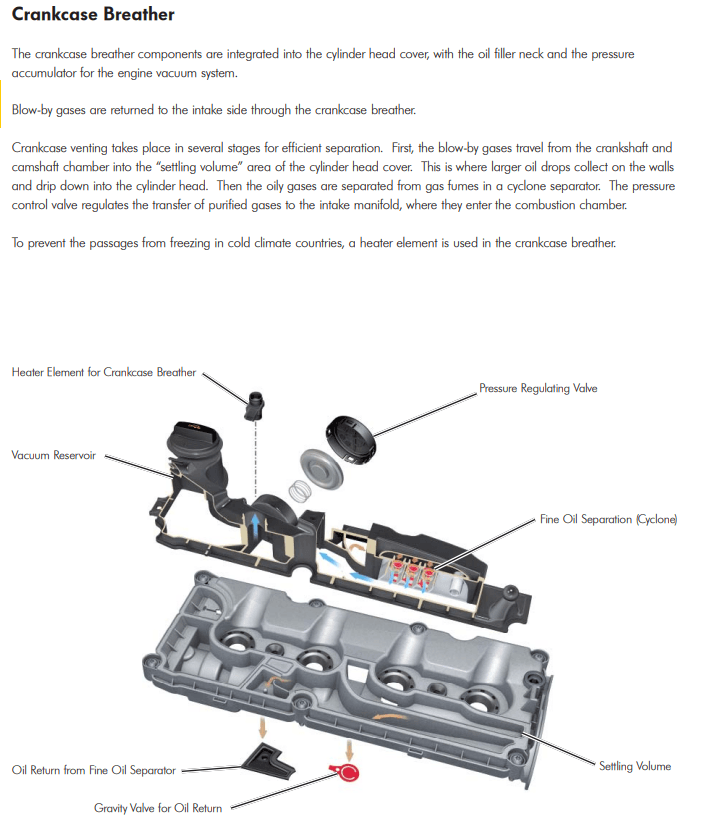

No idea if it would help your problem - but looks to me like you can change the regulating valve diagram with the cover in place?
There is no official VAG part number - so would be a new cylinder head cover - but some companies on line look like they sell just the rubber diagram?
From here:
Regarding oil consumption this is an interesting thread:

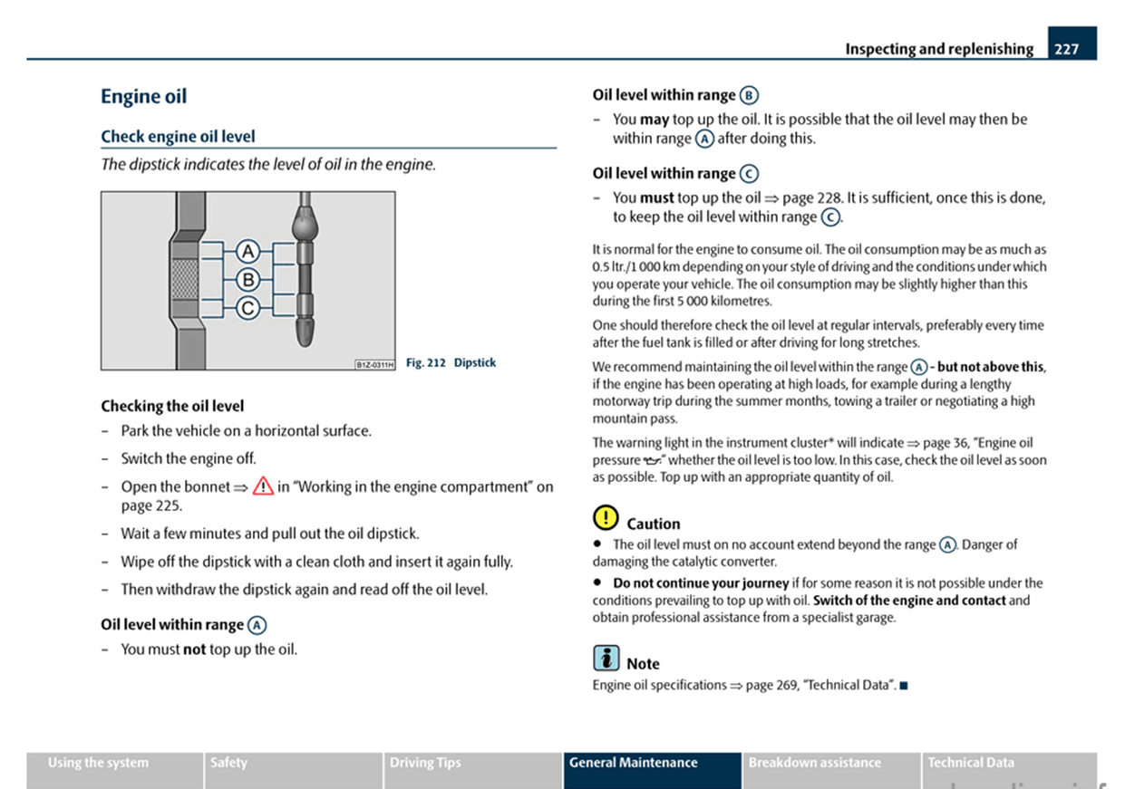

car is consuming roughly 700-1000ml every 1000 miles or so
The VAG 'allowance' for oil consumption is 0.5L per 1000km - which is 1L per 1240 miles! or 0.81L per 1000miles.
Your 0.7 - 1.0L per 1000miles straddles this so personally I'd just monitor closely for the next few months - mileage done per oil added to try to get an accurate figure?
Just for reference - VAG do not consider oil use high until is exceeds 1ltr per 1000 km ( 1ltr per 620 miles !!!! )
This for a modern engine is a shocking amount of oil use to be classed as normal.
No - it's 0.5L per 1000km! or 1L per 1240 miles.
As I said - they do not consider it HIGH until 1ltr per 1000km
You are quoting what they consider NORMAL
Going from their stated standard of 'oil consumption can me as much as 0.5L per 1000km' I would suggest they consider anything above 0.5/1000 high!

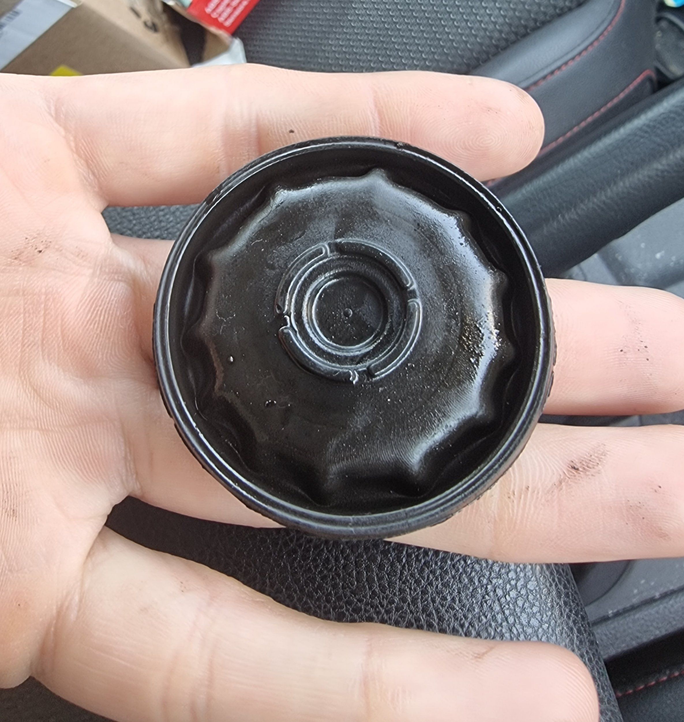

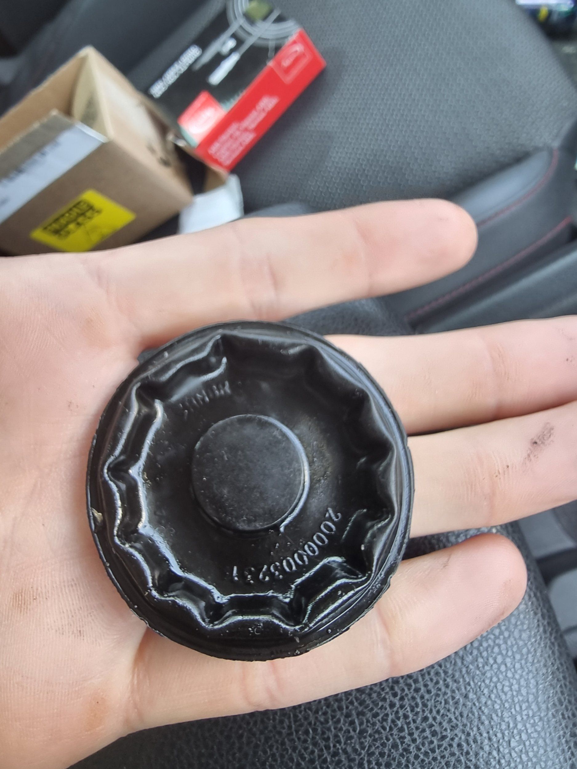

Diaphragm changed and now to see if it uses any oil on a long drive. Got 2 60 mile journeys over today and tomorrow so should know for sure tomorrow evening.
Pictures of it in spoiler. It's pretty much stuck in that shape and pops back instantly.

Interesting, doesn't look good. Hope it helps.

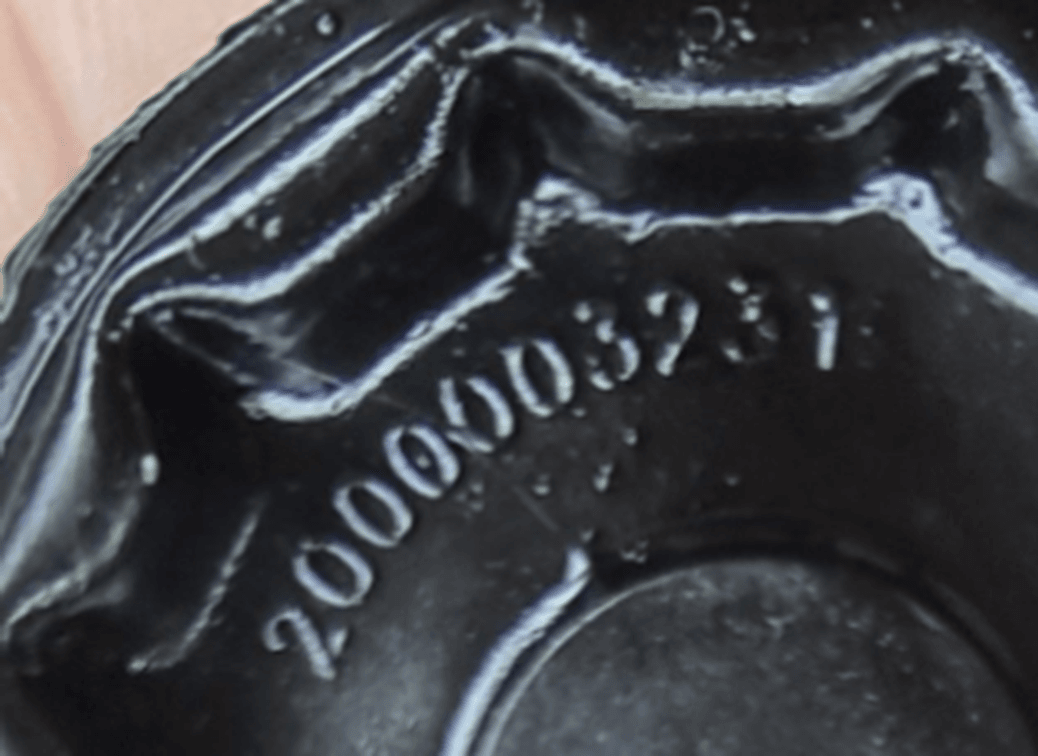

This diaphragm 2000003231 seems common on many TDI's including the older EA189.
