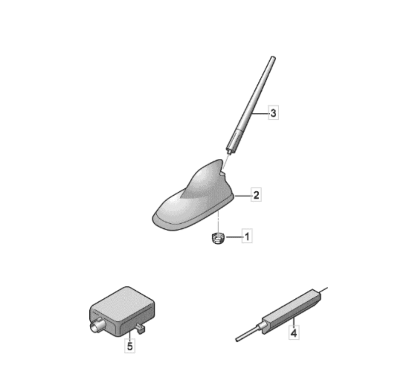

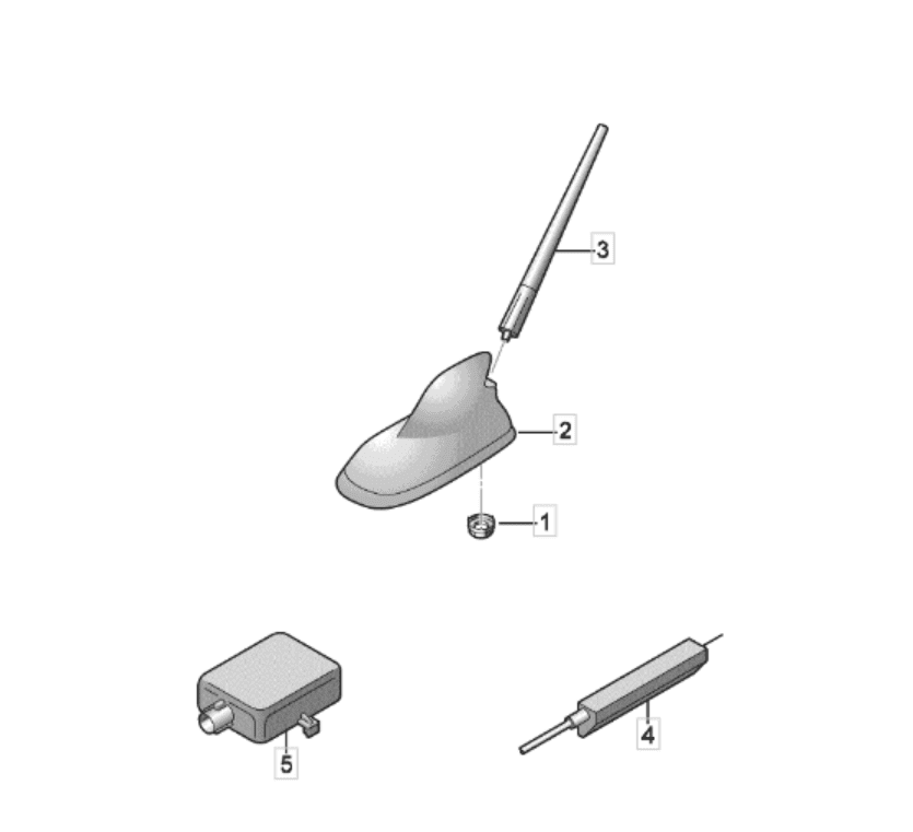

Looking here it has quite a good diagram with all the various part numbers. I would need an aerial and possibly the nut which is under the base and I think that's a take the roof liner down job to get at from under as the base seems pretty attached to the roof. I think it's more than I would be able to do myself I don't think I'd be comfortable removing and fitting the roof lining without breaking something so I would probably get my usual mechanic to have a look for me. Probably cost more in labour than the actual part
Sent from my Pixel 10 Pro XL using Tapatalk
Below is the actual diagram from the related 2014 Ibiza section of parts catalog.
The one you attached is from another model probably, as same parts are used in a lot of different brands & models.
But it doesn't matter anyway, the nut below is used to fix the base to the roof.
I don't think it has anything to do with the rod.
