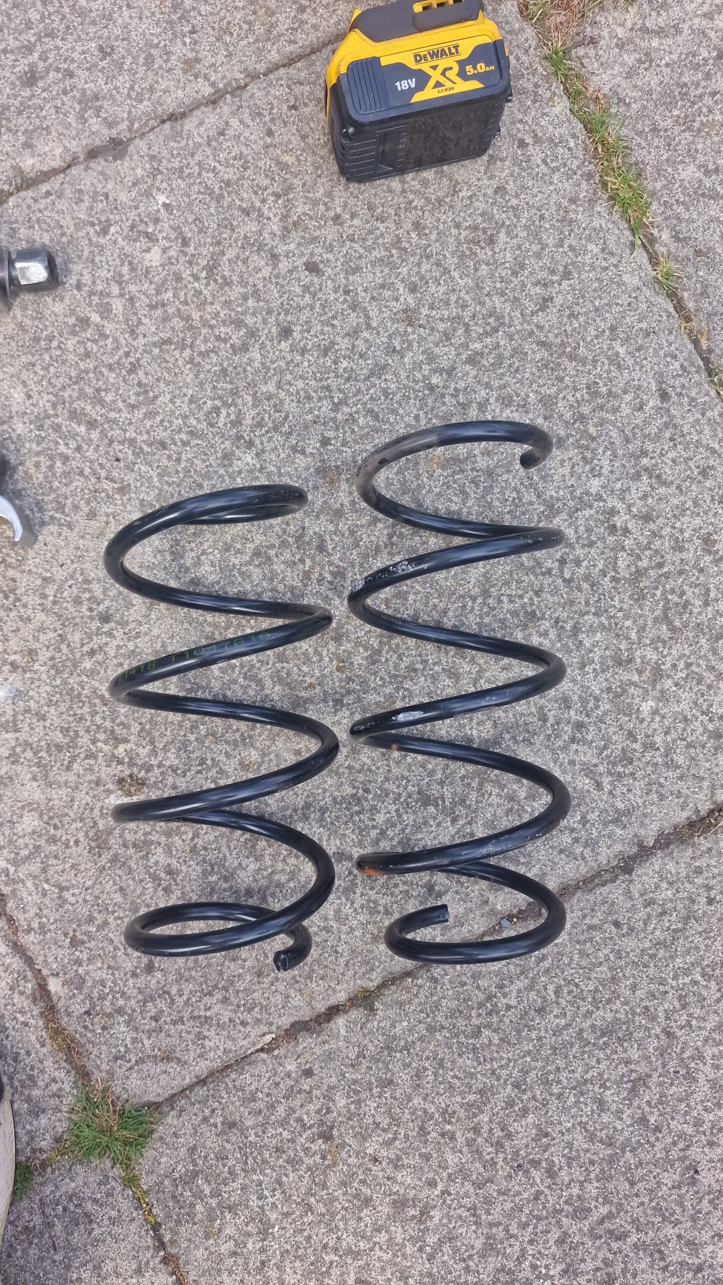

Sorted. It was the wrong spring in the box!

The car now sits correct height and is actually a little less harsh over bumps which is actually good. I read somewhere on here before about the harsh ride of these and recommendation was the shocks, this is not my experience though. The spring is definitely the place I would start. Eibachs are progressive. Good bump absorbing and perfect stiffening in the twists. Then I would look at b6 shocks for sprty ride or sport actives but a fresh set of b4s ( factory spec) are very good with eibach. Sorry went off topic lol

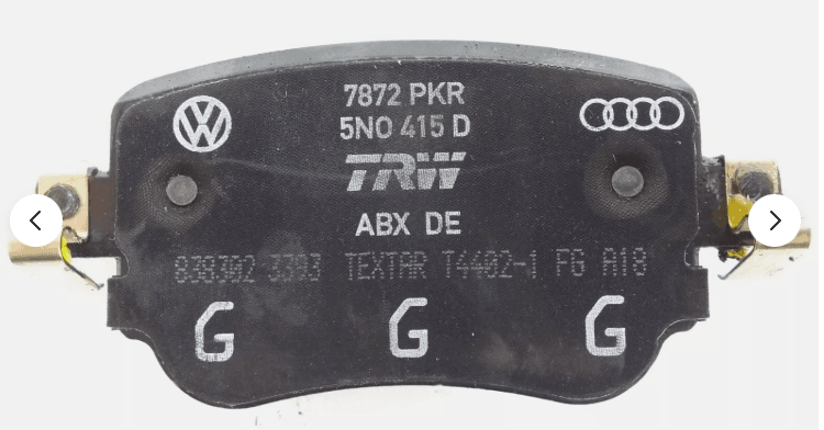

For an example using my rear brake, the OEM (original equipment manufacture) pad is made by Textar.
Front OEM pad is Galfer.
Pagid have also
Textar is the manufacturer of this OEM pad - TRW is the brake system manufacturer, so VAG have used TRW (1st tier supplier) to develop the caliper/brake system - and TRW have used Textar (2nd tier supplier) to make/develop the pad/friction.
T4402 FG is the Textar OEM friction material.
fine blanked back plate, unique friction material, thick multi layer anti noise shim.

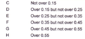

EE is the AMECA (hot/cold) friction code - with EE being a lower friction level than FG of the OEM.

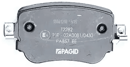

Pagid using PA857 EE AM friction material with what looks like a worse shim compared to Textar.
AMECA friction coefficient examples:
