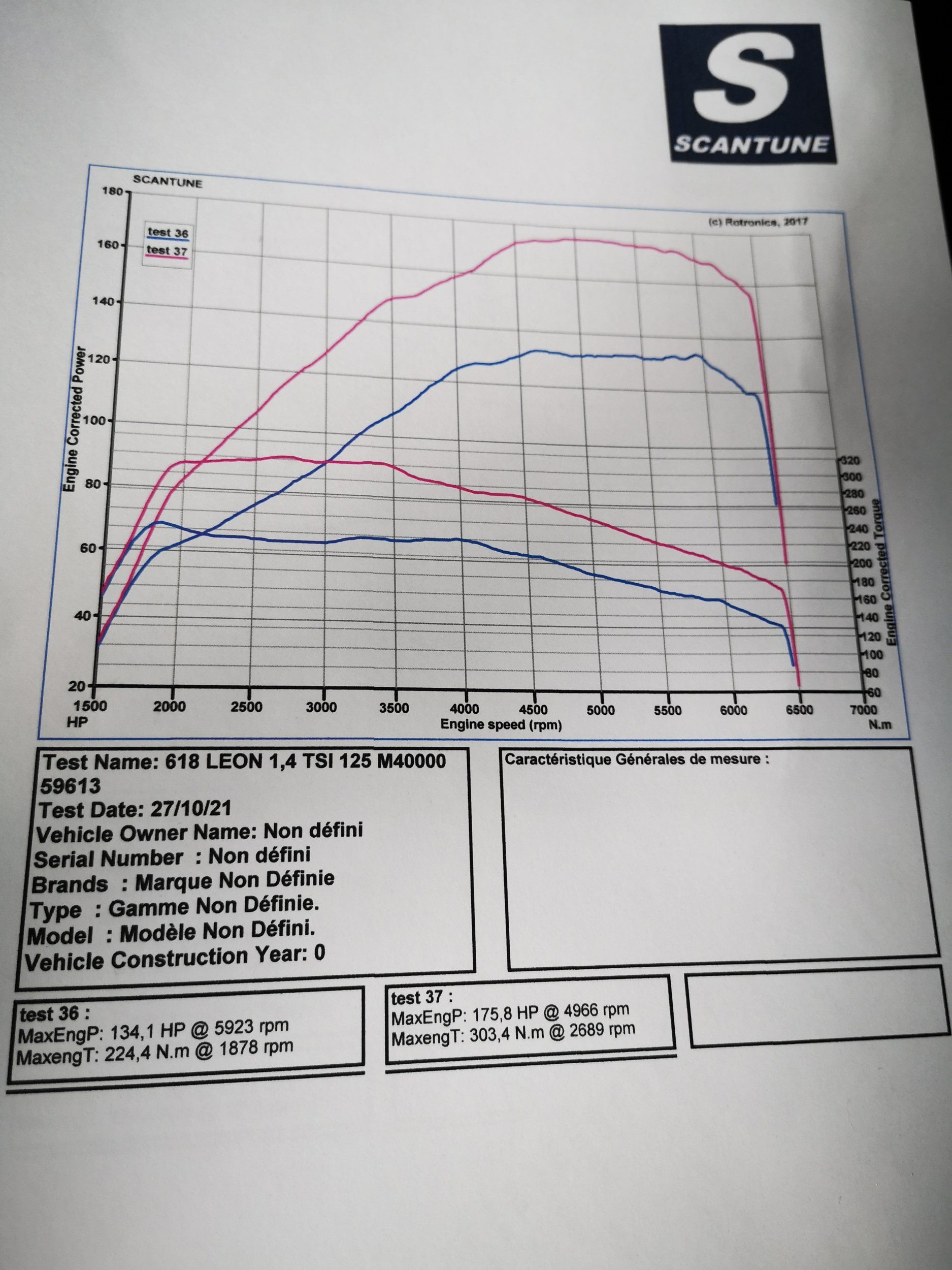

1 test: 136hk
2 test: 176hk

In addition to the hk (PS) figures, do you have any idea what torque the car is pulling across the range of engine speed? e.g. has the car been on a dyno and produced a print out?
