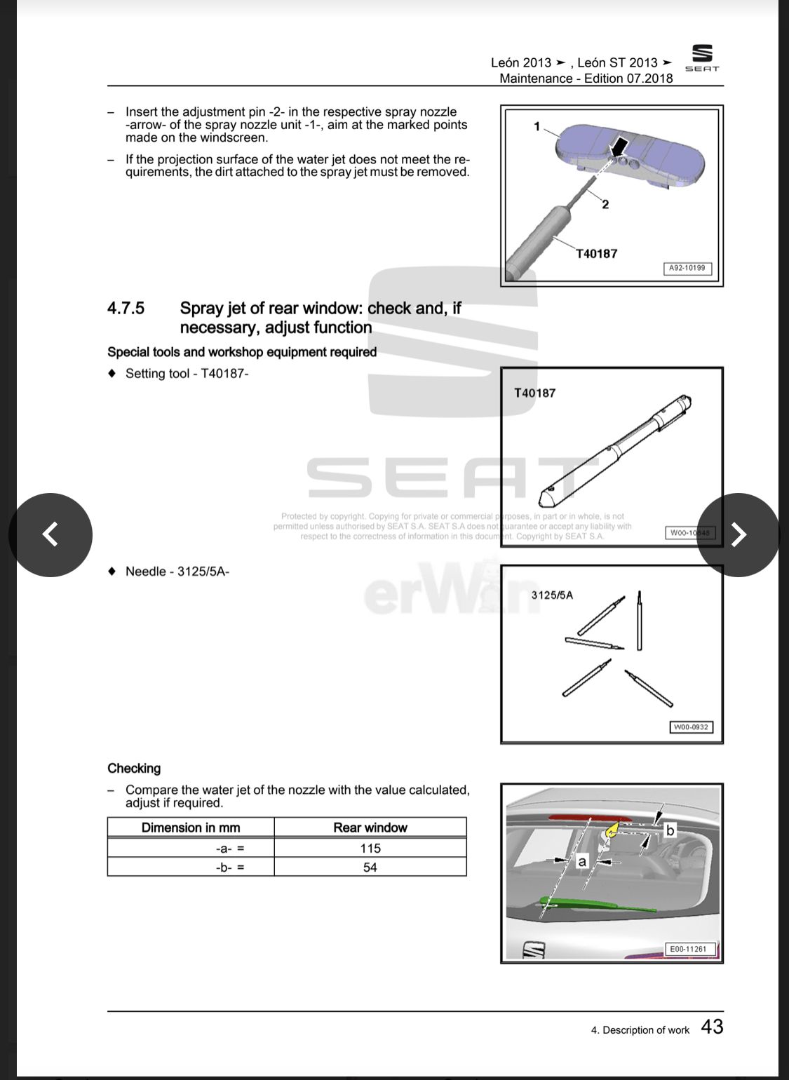

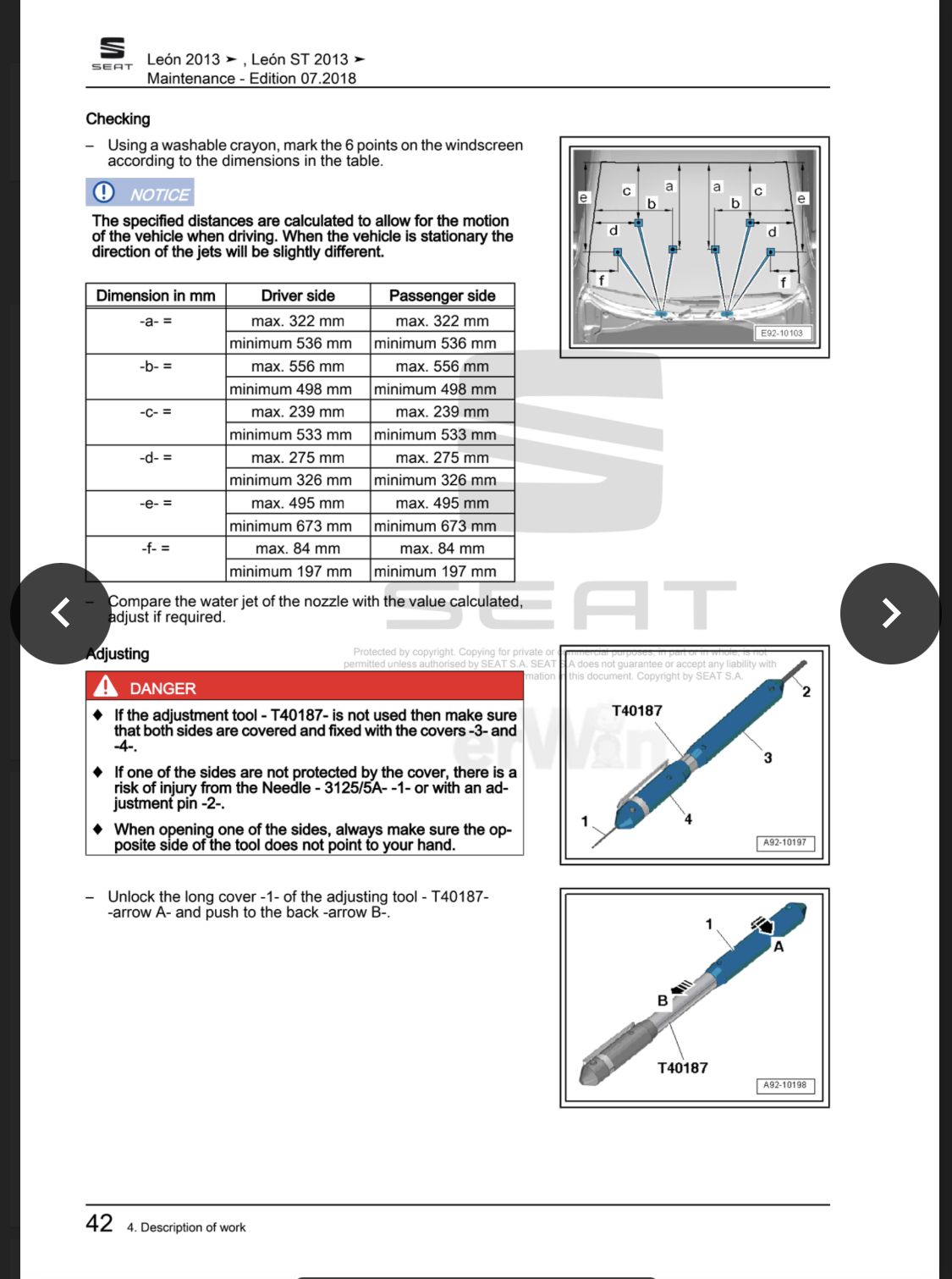

Instructions are below. One of the most common mods is to replace the nozzle type washer with a fan jet type from the VAG parts bin. Plenty of threads with part numbers for heated or non-heated fan jets.
I'd rather a fan jet, my partners focus is a fan style and its much more effective. I'll have a browse around the forums but will adjust the current jets using this guide. Thank you for sharing!
